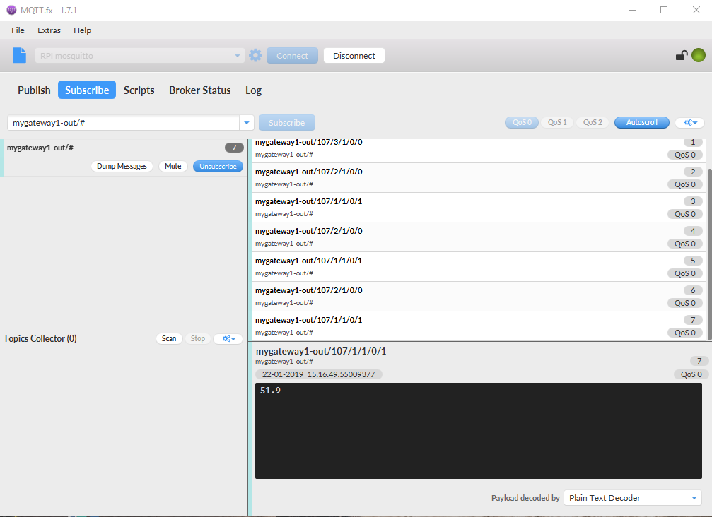

    The mqtt gateway itself is happely spewing data wich arrives at the mosquitto broker:
    [14:05:04] openhabian@openHABianPi:~$ mosquitto_sub -u openhabian -P y -p 1883 -v -t 'mygateway1-out/#'
    mygateway1-out/107/3/1/0/0 28
    mygateway1-out/107/0/1/0/0 91
    mygateway1-out/107/2/1/0/0 20.1
    mygateway1-out/107/1/1/0/1 45.4
    mygateway1-out/107/2/1/0/0 20.6
    mygateway1-out/107/1/1/0/1 43.2

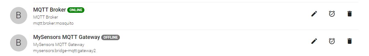

  • @guillermo-schimmel Hi guilleromo, thanks for staying with me.
    I have a broker setup and online,
    mqtt:broker:mosquito

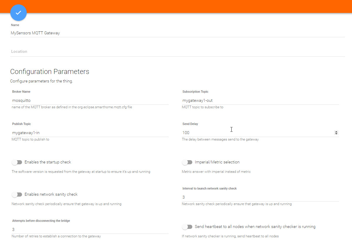

    If i create a thing for the gateway i can see the gateway in paperUI but i cant managet to get it online
    Bridge mysensors:bridge-mqtt:gateway2 [ brokerName="mosquitto", username="openhabian", password="xxxx", topicPublish="mygateway1-in", topicSubscribe="mygateway1-out", startupCheckEnabled=false ]
    (This line probably looks formilliar, its the same you use with addition of username & password)
    In the log it says: "No connection to broker: mosquitto" and i think this is the whole problem since i can see the messages from the gateway appearing on mosquitto when i do:
    "mosquitto_sub -u openhabian -P y -p 1883 -v -t 'mygateway1-out/#'"
    i can allso see the messages on my phone using an mqtt client perscribing to the same topic. But i'm downloading mqtt.fx as i type
  • @jimmy-loyens You have some mosquito/mosquitto mismatch. Have you noticed?
  • @guillermo-schimmel No I had not noticed thanks. Corrected it but so far GW stays offline. I have deleted and restarted these files so often over the past coupple of days, this was a fresh file from today😁

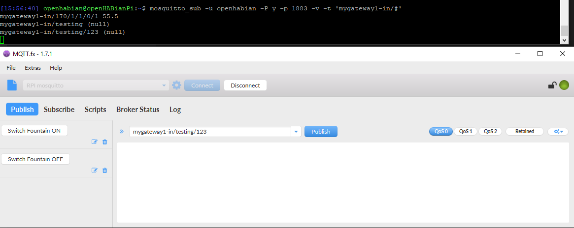

  • @jimmy-loyens I allso have no problem publishing messages to the broker from MQTT.fx.
    I currently have no actuator nodes, only sensor nodes so i cant see if gateway sends message on to nodes.
    If i just send message: "mygateway1-in/170/4/1/0/16 0" to a node that has a door contact on child 4, should this message show up in the serial monitor?
    otherwise i can reflash the node with a relay sketch

  • @timo Mysensors gateway is defined via Paper UI:
    1_1548344263093_gw2019-01-24_12-37-09.jpg 0_1548344263092_gw2019-01-24_12-36-42.jpg

  • @timo Hi Tomo.
    Both the embedded broker thing and the mqtt gateway are online, i can see the mqtt messages in the logvieuwer but i cant discover nodes. I should say i have mosquitto running on port 1883 (for my milight hub) and embedded broker on port 1884. Do you think this is a problem? can i have both brokers on 1883? btw thanks for the link
  • @jimmy-loyens
    1 broker per port otherwise one won't start. Sounds like mys is connecting to 1883 and not 1884
  • @waspie I think the embedded broker connects to 1884 since i can see the messages from my nodes. But you might be right that mysensors is connecting to the wrong broker/port. Allso noticed the embedded broker is really slowing down my RPI3. Just uninstalled it and everything speeds up again 😥 Guess i have to wait till everything can connect to mosquitto 😞

  • By creating the file org.eclipse.smarthome.mqttbroker.cfg in the service folder (/usr/local/etc/openhab2/services in my case, chown to openhab), with the contents
    name=mosquitto
    host=192.168.1.69
    secure=false
    port=1883
    username=
    password=
    retain=true
    I was able to just create the MySensors MQTT gateway (using paperui) and it stayed online (no mqtt broker defined, but its addon is installed). I had the impressions that with the latest versions it should be possible to do everything in the PaperUI, and that the broker would use the mqtt2 addon (but in paper ui, service, config, mqtt tab, mqtt system broker connection, manage->plus button -> expert mode, I get to see the contents of the cfg file above)
    But unfortunately, it seems that the discovery services enters a endless loop (maybe I need to update my arduinos sketch to the latest mysensors code?) and I don't get any auto discovered things. If I trigger a new discovery it will stop the previous one and start again.
    Finally, I was able to manually create a thing, and link items on it. Eventually my battery level and humidity were displayed in the paper ui control page (after some weird delay, not updating once it shows in the log. the temperature didn't show up though).
    Not sure if my understanding is off (or paperui is limited in this sense) but in the "thing" creation page I only get to specify one child id. Then my multi sensors/value nodes would need to be define in multiple things? As I can't properly define channels for each child id, and I'm not sure what var1-5 are all about.
    I'll try defining things/channels/items directly in files in the following days, because so far I couldn't enjoy most of the benefits of this new version (auto discovery, logical grouping of physical device in "things", questionable "do-it-all in paper ui"), and I'm almost considering using mqtt1 binding in the new install 😞
