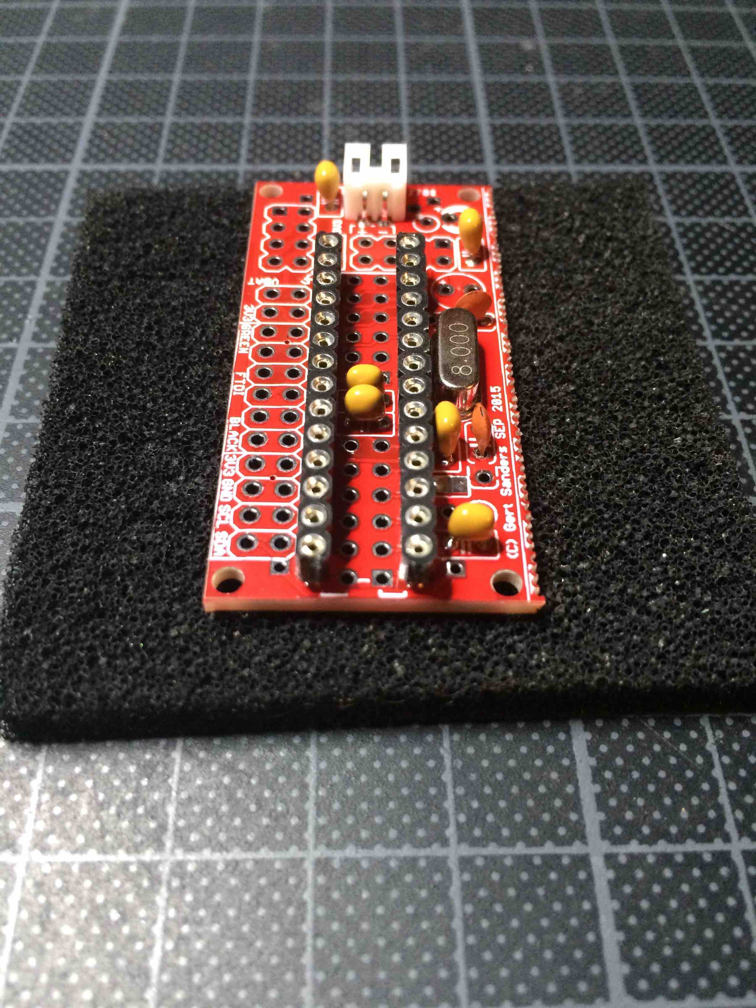

                        Here is some feedback from designing my boards:
                        You need 100nF capacitors between AVCC and GND and between VCC and GND.Put them as close to the actual pins as possible. And you need to pull ARef to ground via a capacitor (can be 100nF as well). All this improves stability of powersupply to the processor (and less restarts)
                        To test the battery voltage (if powered directly from 2 AA or 2AAA batteries, there is no need to use the 2 resistors, there is a routine to test the battery voltage based on internal reference (so no analog input pin needed).
                        You could use a single LED to show what is going on: slow blink means all OK, fast repeated blink means error. This saves a resistor/led/output pin.
                        The 100uF capacitor is a 8x12mm type and fits just under the NRF24. You can go for a 10uF which are normally a bit smaller and have no clearance issues (only 8mm high, so well below the 12mm space available).
                        How do you plan to program the board ? It could be nice to add the FTDI comptible header on the top board, or you can also add it on the main board.
                        Here is a link to my design:
                        https://oshpark.com/shared_projects/qnkNIMZx
                        Schematic is in the next post.
                        Like yourself I only use through-hole components (except on the extention board). I can add extentions on top or on the bottom of my board.
                        Another tip I got from other people: powerlines need wider traces,
                        I have been thinking about replacing one of the headers I added (for the top boards) with a header according to the MYSX 1.5 specification. So far I have not finished this, but it is on the todo list.
                        A 50mm by 24mm board allows powering by two AAA batteries onboard, so my next design provides for this as well (it's a work in progress).
                        But after three designs I now work in reverse: first look for a nice suitable case, then design the board to fit with ITEAD/DirtyPCB spec (50mm x 24mm to have 2 boards out of a 50x50mm run).
                        Since I test on prototype boards and transfer sketches to "final" boards later, I think I can integrate the FTDI header into JP1. I also plan to re-arrange the I2C pins so that I can plug in boards from Sparkfun, without any adapter. They (Sparkfun) use a fixed sequence for all their I2C boards:
                        GND - VCC - SDA - SCL
                        Some boards are VCC - GND - SCL - SDA. Not sure which is more popular, as I have seen both on Aliexpress and eBay.

                                Here is a preview of my new board:
                                upload-ef70e5f9-9073-4b47-a074-4a48779f1004
                                It will be able to work both as a repeater (NRF24 with antenna) as well as a normal sensor board (small NRF24). The voltage divider on A0 is not yet implemented here. Still some empty spaces :-)
                                Z 1 Reply Last reply

                                  • GertSandersG Offline
                                    GertSanders
                                    Different version with mounting holes:
                                    upload-2854219b-739f-4d11-984c-f73b8519be82
                                    Schematic:
                                    upload-1e4c0b8f-b650-4ffb-a991-b9965b6add48
                                    Topsilk+documentationlayer:
                                    upload-4281ea10-4bdf-4285-9198-cc8aa3e5e7e1
                                    Bottomsilk +documentationlayer:
                                    upload-29293821-220a-494c-b3a3-74f9c923e2ac
                                    As I said: a work in progress. Nothing fixed yet.

                                          @Andreas: nice woodcase. Do you have access to a CNC machine at home or at work ?
                                          My design is based on the idea that I want to have a maximum of options with the same PCB. Last night I printed some boardoutlines on paper and then placed the actual components on top. I find limitations in space this way. My idea of 1 long connector has a disadvantage: the small radio covers 4 pins, so that a top board would not be able to plug into these. I went back to a seperate header for the small radio and for the top board.
                                          Still thinking about powering options. VRAW (anything external), VCC (regulated to maximum 5V, e.g. from a USB port), 3V3 (regulated via bottom- or top-daughter boards), VBAT (from onboard AAA batteries). The problem is finding an elegant and easy way to choose. Solderpads are compact, but permanent. Jumpers are easy but big. Small toggle- or slide-switches are expensive.
                                          The fruit of last night's meditations:
                                          upload-28d0b2a4-7a0b-42a5-8be4-621438373d1d
                                          I have still not decided if I should use the pintout of the SI7021 breakout modules (VCC-GND-SCL-SDA) or the HTU21D (VCC-GND-SDA-SCL). Most breakouts seems to use 3V3, so I may need to plan for that.
