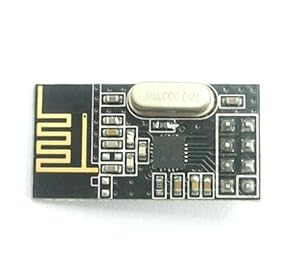

    I have a Arduino Nano (link) bought on eBay. And the NRF24L01 module also bought on ebay (link).
    The NRF module do not have any markings of the pins and the ebay product page do not contain any information either. I've therefore assumed that the pins are the same as on the tutorial page (link).
    I've uploaded the SerialGateway sketch to the Arduino Nano successfully without any changes. When looking at the Serial Monitor I get this message. "K��0;0;3;0;9;radio init fail" or "�RV��# �0;0;3;0;9;radio init fail" after trying to rewire it all from scratch.
    The Arduino Nano have the possibility to output 3.3 and 5 V, I've therefore used the Arduino Nano 3.3v pin rather than the recommended VCC pin (that I assume output 5V). Not sure if this is wrong...
    I'm using OSX 10.11.3 and Arduino 1.6.7. Though not sure if that is relevant.
    Do you have any tips as to what I'm doing wrong?

      @Christian-Simonsen Hard to tell. By the looks of the picture of your NFR24L01+ it's the same pinout as on the MySensors build page.
      There are a couple of checks that can be done:
      1. Always power the radio with 3.3V never 5V (which I assume is your VCC pin).
      2. Add a capacitor (4.7uF) as close to the radio as possible. (I always stick them, in the female pins of the Dupont cable).
      3. Double check the wiring. Make sure that MOSI and MISO aren't changed e.t.c.
      4. Select the correct board and processor in your Arduino IDE/
      Also set your serial monitor to 115200 baud, to might get rid of the strange symbols in your output. I have a couple of Nano based sensors which are running for more than half a year without any problem.

                    The chip marking is "NRF M 24L01+ 1452AB" - so I assume it is a + module.
                    I've tried to rewire it multiple times, I will try again.
                    • sundberg84S
                      sundberg84S
                      @Christian-Simonsen - Markings is not a guarantee...
                      See the threads i posted, there are alot if images.. maybe you can see something there. Or post a picture of your radios here... maybe we can spot something if you suspect its a fake.
                      Also - how do you power your node?

                          @sundberg84
                          Fake NRF chips seems like the most plausible reason so far. The chips do look of bad quality.... but whether the chips are the issues or not is difficult to say..
                          Can you judge from the pictures?
                          • sundberg84S
                            sundberg84S
                            No - its not possible to say exacly. Its defenetly a fake - but how bad, not possible to say.
                            I read some days ago someone recieved a bad batch and there was no silkscreen / white markings just like you. (See image) alt text
                            but I also recieved a batch yesterday without markings - and the one i used today worked great!
