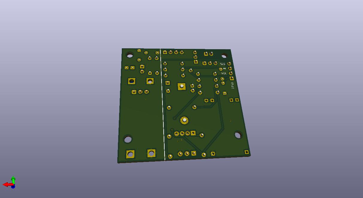

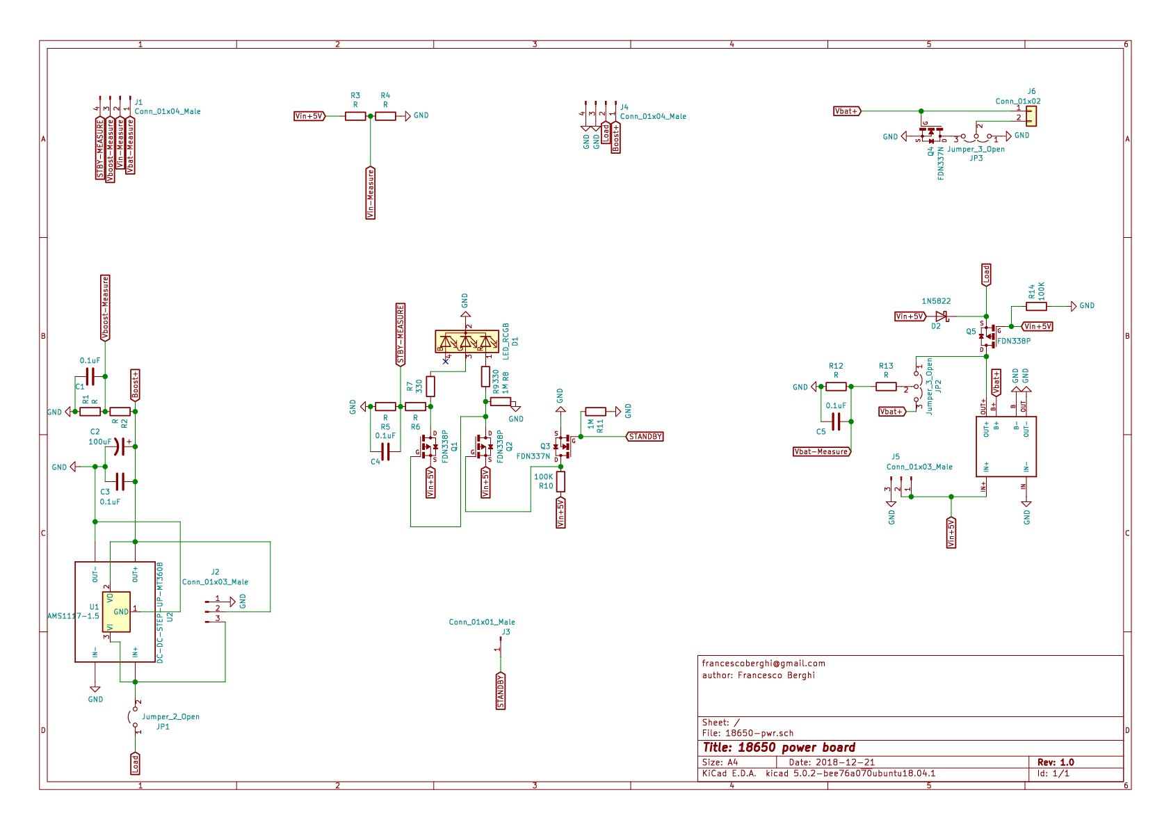

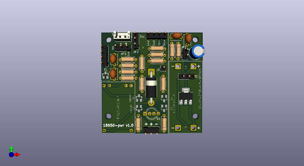

    Hi, to power a sensor or actuator with a 18650 li-ion battery I have designed this pcb based on a tp4056 module and MT3608 booster.
    Schematic:
    Main features:
    • Load sharing circuit to safely power the load while charging the battery
    • Boost converter MT3608 (optional) to increase the output voltage. To reduce the size of the board the right part delimited by the vertical white line can be cut out
    • Charging status signaling led (optional)
    • Voltage dividers (optional) to measure Vin - V batt - V boost - V standby. Output available through J4
    • Battery reverse polarity protection through mosfet Q4, excludable through jumper JP3
    • Battery voltage measure point can be selected through jumper JP2
    This board can be used with this one
    I have ordered it (JLCPCB) but yet tested. After that if someone is interested I can share it through openhardware.
    Any suggestion / improvement / comment is well appreciated.
