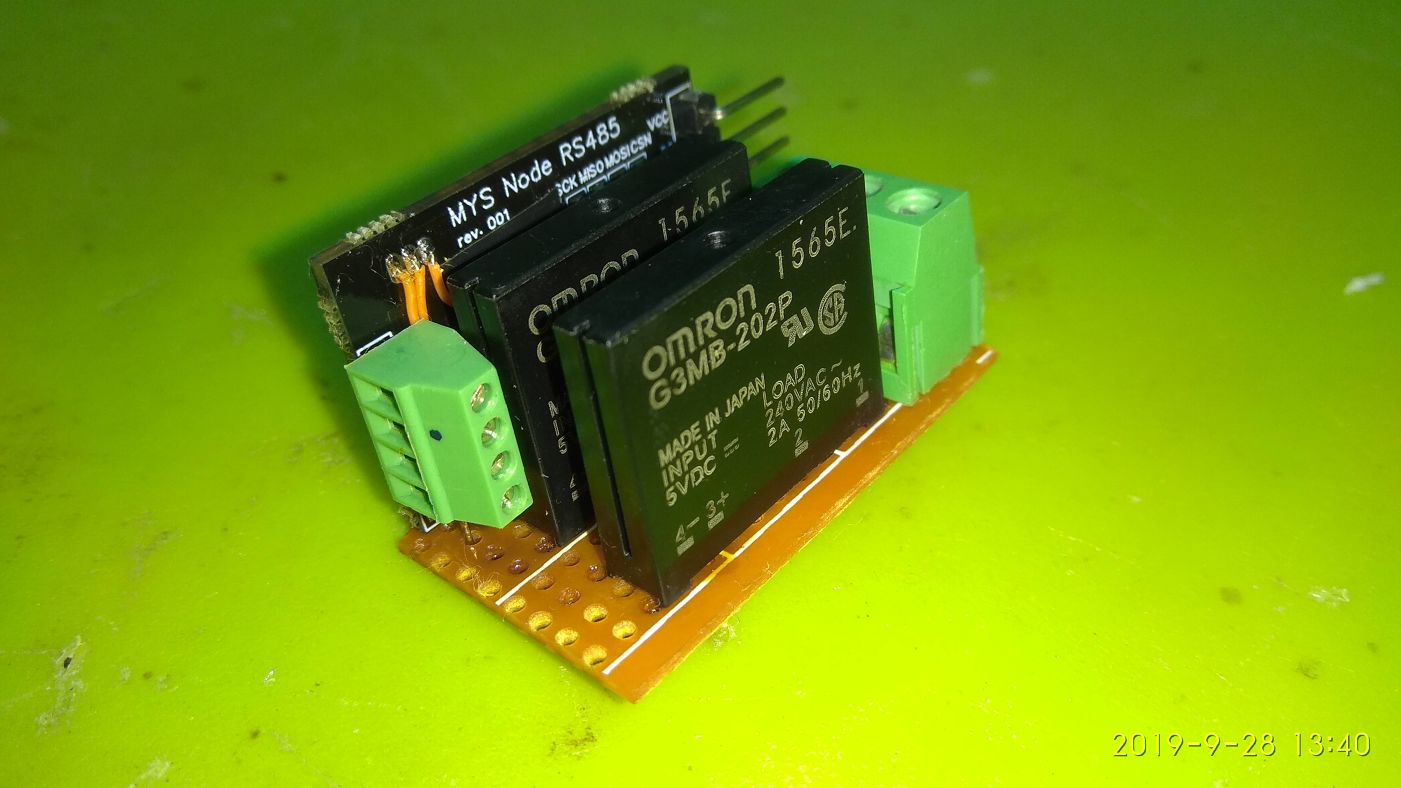

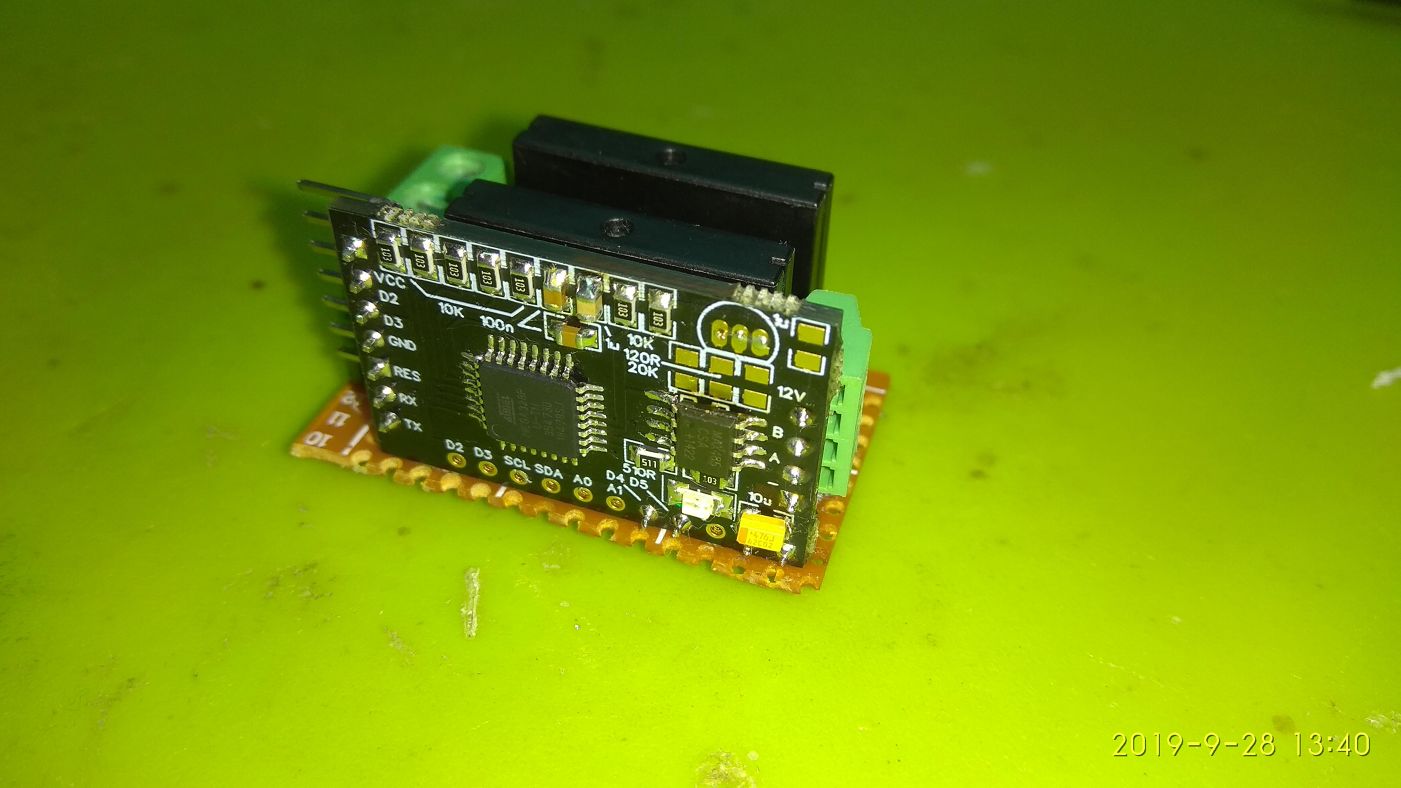

      UPDATE: Tested in hardware now.
      • C Offline
        C Offline
        cabat
        Example of usage RS485 node: Light control module
        Light module
        Light module
