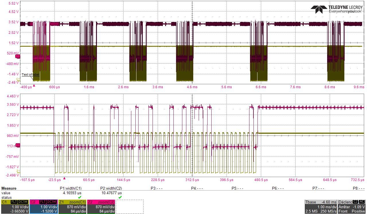

    Dear all,
    I am using VEML6075 with a NUCLEO board F030R8 using HAL Library to drive the sensor and i am facing a misterious issue:
    I am looping ID, UVB, UVA, UVD, UCOMP1, UCOMP2 data reading ( with a previous initialing configuration register of 01000000 (0x40) ) with a 5 sec pause between each reading sequence.
    The thing is that i read for each register the exact same value (!?) ID = UVB = UVA = UVD = UCOMP1 = UCOMP2.
    I have followed the reading sequence as :
    I2C write: slave address (read/write bit to 0) followed by the command code corresponding to the register code.
    I2C read: slave address (read/write bit to 1) followed by a reading of the 2 bytes of the sensor.
    Here is the oscilloscope screenshots...
    ID register reading (0x0C) whose the value read is 93

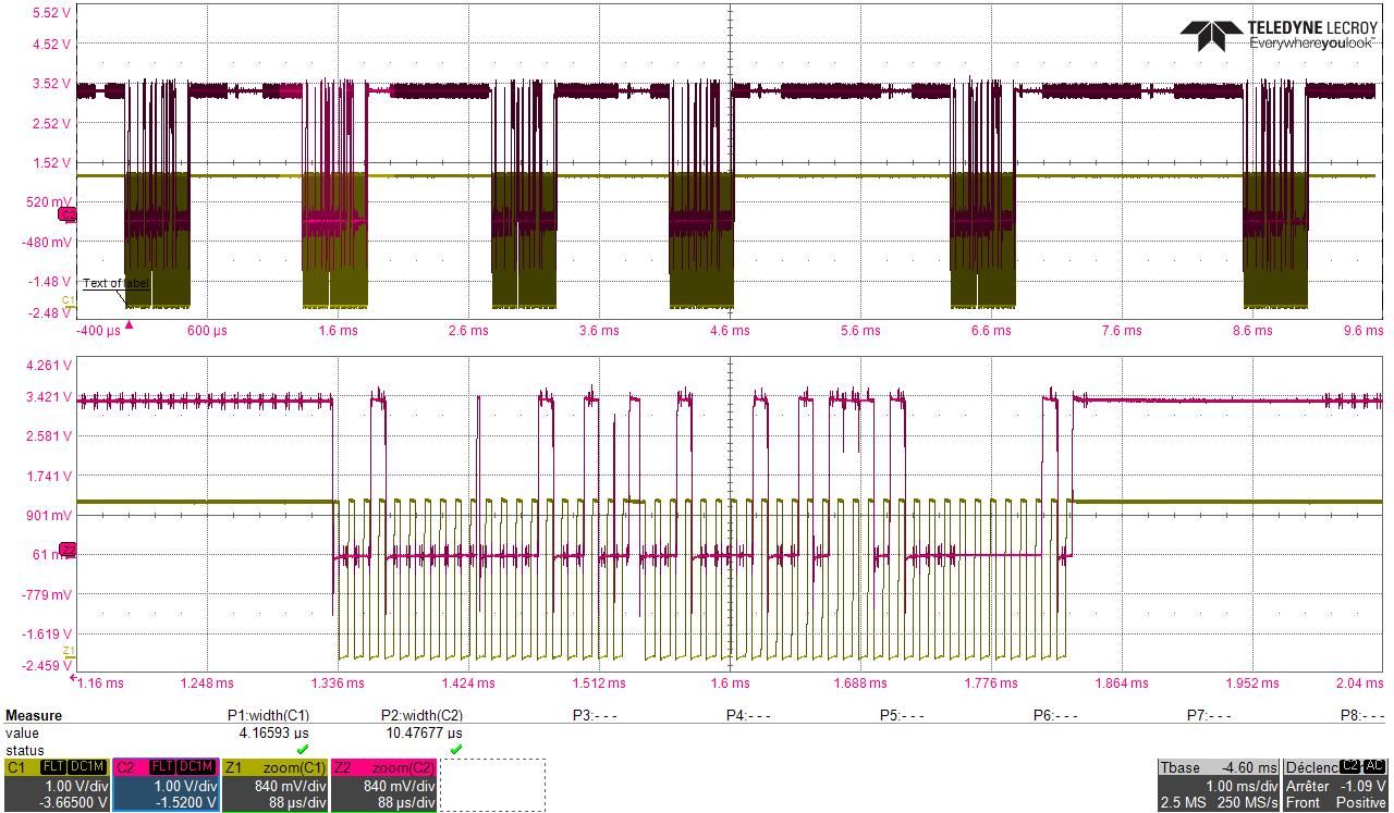

    UVB register reading (0x09) whose the value read is 93
    UVA register reading (0x7) whose the value read is 93
    ...and i don't think that the rest is nessary to show..
    So, i guess there is something i do wrongly. Could you help please?
    You ll find below the piece of code i used:
