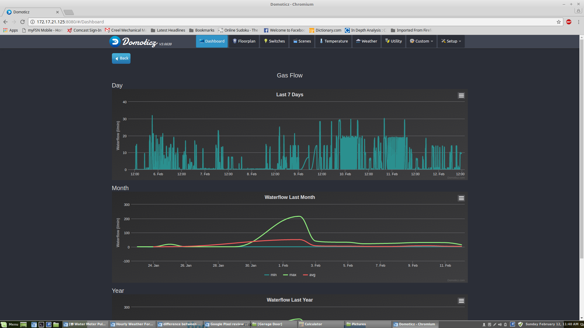

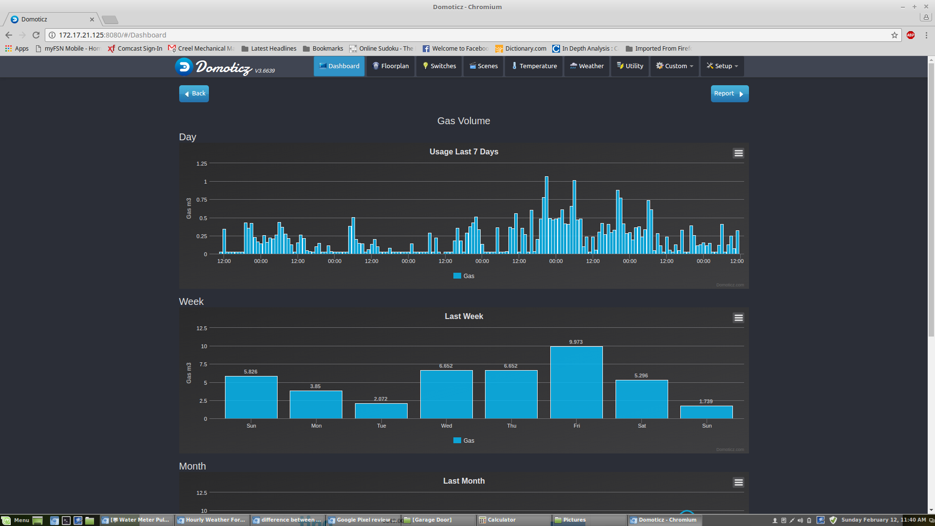

  • I was trying to find a way to measure the amount of gas our gas meter was using. I checked out several ways but they all involved using either a hall sensor or a reed switch or a IR sensor or a light sensor. But all of these would not work for my application for a number a reasons. First my meter is outside, second there is no magnet in my meter, third the utility company will not allow us to attach any device to the dials or the electronics of the meter (US smart meter). By the way my meter is a Rockwell 250 (Siemens). So after much researching I'm using a HMC5883L magnetometer. It measures very low magnetic fields.
    Please forgive my lack of pictures and links but when I was assembling it I never thought about it. I can get some pictures of the finished sensor if needed.
    I found the sweet spot on my gas meter using an Android app on my phone called Sensors Box, which allows one to access the magnetometer inside of the phone. While the gas was flowing I just moved it around over the meter until I found a fluctuation that coincided with the gas flow. This is what I call the "sweet spot". I then built a sensor using the HMC5883L per (https://www.sparkfun.com/tutorials/301). But as of this writing I found that they are no longer making it but do have a replacement (https://www.sparkfun.com/products/retired/10530). I have it successfully connected to my serial gateway and am using Domoticz as a controller.
    The initial problem I found was trying to convert the output a the magnetometer to something useful. The data that comes out is stream of numbers from three vectors that goes up and down. After looking at them in the serial plotter of the Arduino IDE I found one vector (y in my case) that looked like a sine wave. Then with a lot of help from my son, who wrote most of the code for the Arduino, it seems to be putting out decent data. However it does need to be fine tuned.
    What we ended up doing is auto detecting the top an bottom of the sine wave, then dividing it up into 10 pieces to get useful pulses.
    I'm working on getting the Metric and English units out put correct but for now the metric units work OK. Any input is welcome:
    UPDATE: 3/12/17 - we have been using the most recent sketch (v.6) and it has been running for two weeks now without a problem. I do plan some updates to the code that I hope will include an interactive serial monitor to set up the sensor for the first use. Also if you have looked at the picture of the sensor it is quite large and I would like to make it a bit smaller.

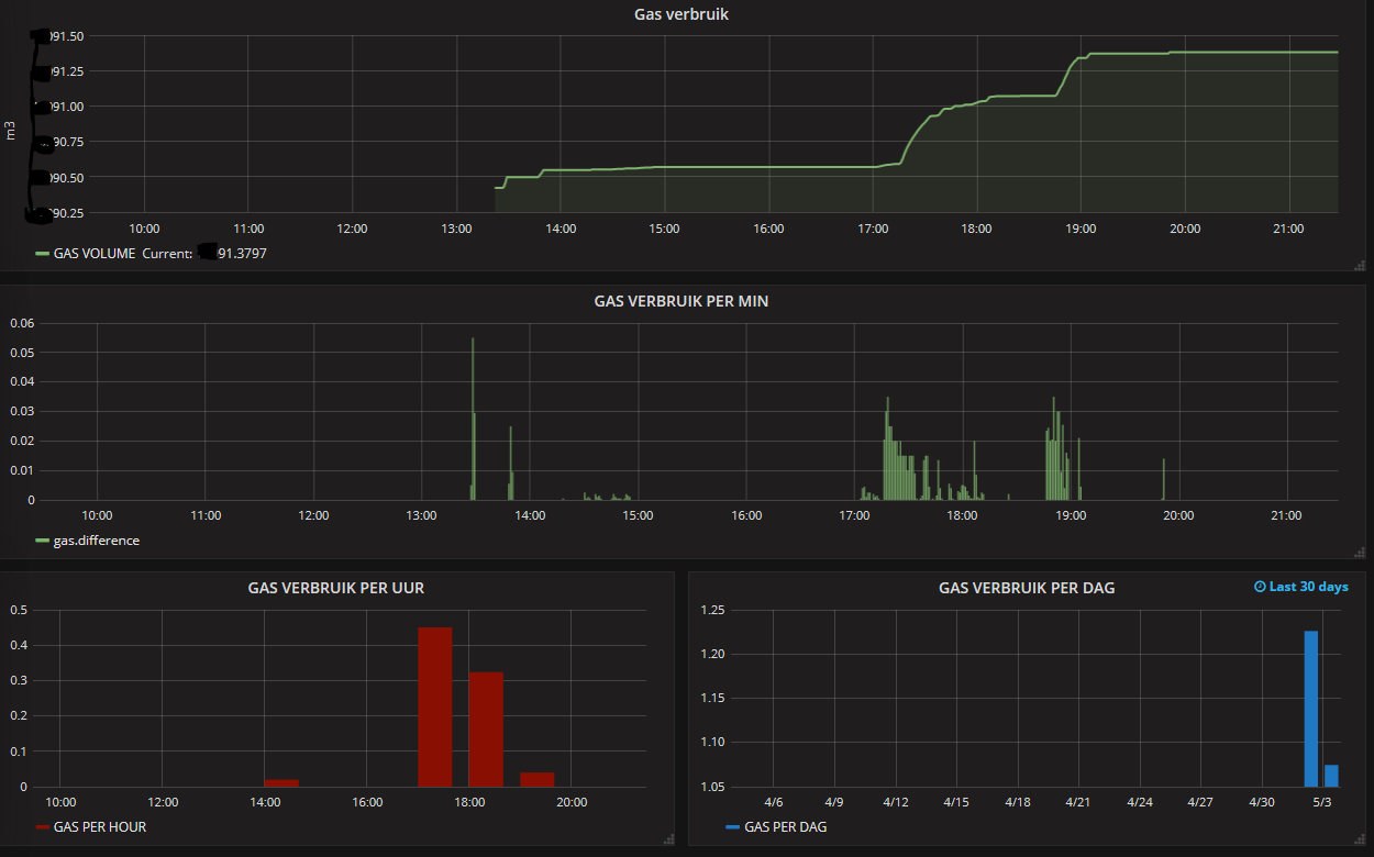

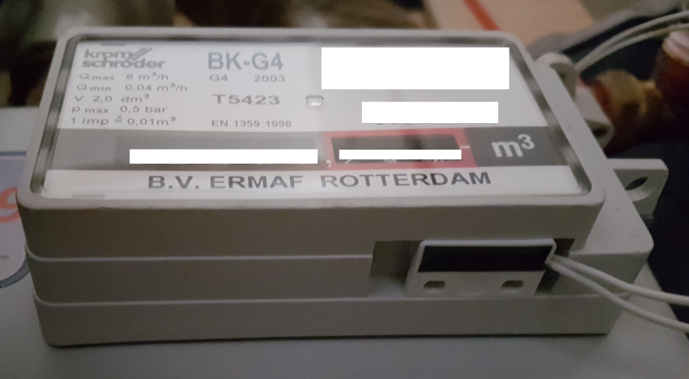

  • Hello,
    i have the same Project, i use a HMC5983 magnetometer.
    i'm testing now, but it looks good.
    regards

    And here the Output, 1 Puls is 0.001 m3, first at slow flow and then with my max.
    regards
    ThomasD

  • @Yveaux Sorry, it is 1 puls at 0.01 m3
    That depends on the gas meter you use, the BK4 gives a magnetic pulse per 0.01 m3.
    For this puls you can use a reed contact or a magnetometer.
    regards
    ThomasD

  • @gohan Yes you do, but what about the times when there is gas flowing. If I remember correctly there was about 20 or 25 minutes for full sine wave when only the pilot was running. That SEND_FREQUENCY (1500000) was too large when the gas was actually flowing to get an accurate measurement. I just wanted to get an accurate reading of the gas flow at all flow rates. Am I missing something?
    Here are some screenshots from Domoticz for the past week:
    1_1486917738604_Screenshot from 2017-02-12 11-40-09.png 0_1486917738603_Screenshot from 2017-02-12 11-40-26.png )

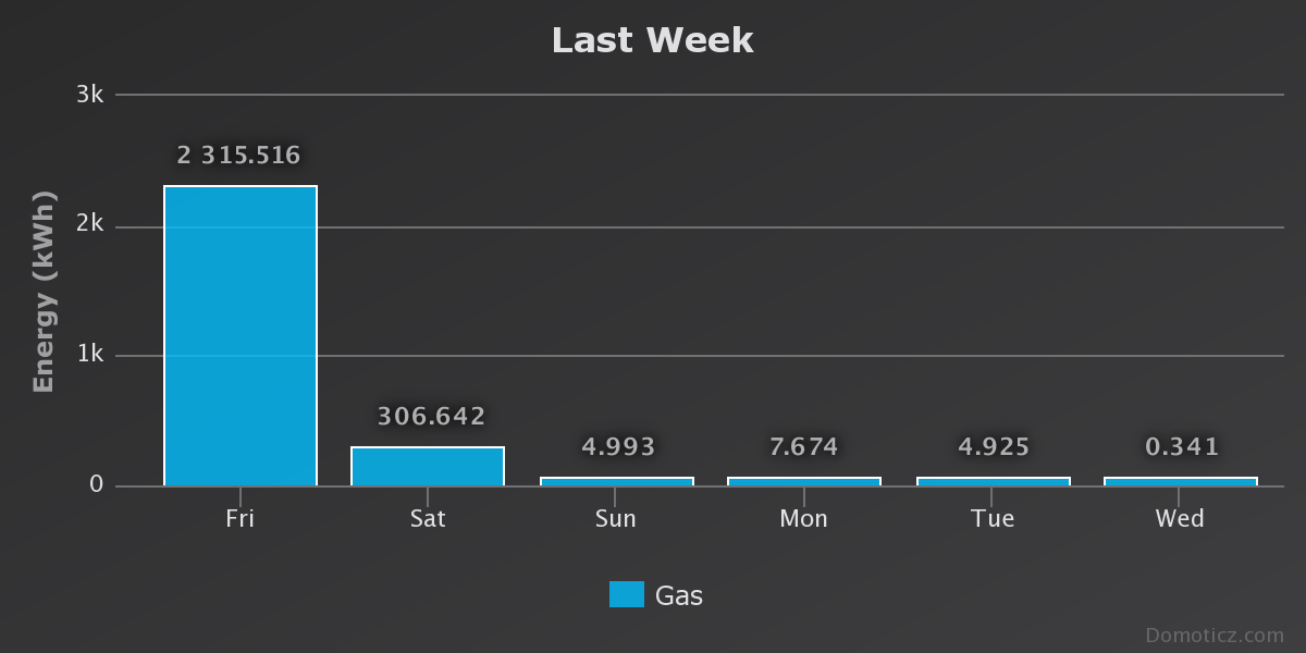

    Here are some results from Domoticz. As you can see last Friday I had a spike. This was due to some of the same problems you are having. It has been running fine for the past several days since the last upgrade. I am using the same sketch that I posted.
    0_1488408954566_chart.png 0_1488408961804_chart (1).png 0_1488408967898_chart (2).png
    I haven't figure out how to remove the Energy (Wh) from the gas usage or the word Waterflow.
    As for the fixing of the excessive pulse counts I also at times had he same problem as well. But make sure that your top and bottoms are correct first. If they are and your "next pulse at" number is just being bypassed and the pulse count keeps going up the solution was to reorder the code. Not sure how that helped but it did. I'm not the software guy in this project, my son is. But I know most of what is going on with it. If it continues to give you problems let me know, post your code and I'll get him to look at it.

  • @dpcr Nice adjustment of your Original code. Based on your Original version I have started coding as well as I like the simpleness of just adding a sensor to the meter without taking care of the direct position.
    My current code can be found at github via the following link:
    https://github.com/rspaargaren/Read_Gasmeter/blob/Workinprogress/Read_Gasmeter.ino
    Basic differences are:
    • I have removed the fram reference but this could be added again if you use it.
    • I have added a different setup sequence for fixing the top and bottom. In my case it waits until four changes in direction have occured. So no direct gas flow have to flow after a restart.
    • The number of pulses between a change in direction is fixed independent of a change in top or bottom. So in my case every half a cycle will give ten pulses and a full cycle 20 pulses.
    • The results are submitted to the gateway after a intervall but also after half a cycle.
    • The top and bottom is checked after each cycle. So in case of major difference the interval is changed.
    • During normal run, the reading of the y value is executed within the loop. So basically the arduino has time to do some other stuff as well in between the readings.
    The code is currently working but requires some clean up. Also I would like to make an option to store the values at the gateway and maybe change the hardware to an ESP version so I can have multiple ways of output. Like MQTT.
    This is the current output in Grafana:
    0_1493840069318_upload-83a800b9-0b52-4b3a-a54e-829249fcf012

    @dynamite I seem to have the same meter; the BK-G4 :
    0_1494093064638_upload-7b4dd65e-d3af-43fc-ac01-4c8357b57059
    The 'official' place to stick a reed sensor is a hole on the bottom-right, as you can see in the picture.
    I had a spare reed switch from a Senseo coffee machine, which perfectly fits the hole and works perfect!
    Maybe if you stick the compass sensor here, the signal will be more consistent/repeatable, as it should be more or less the same with each revolution.
