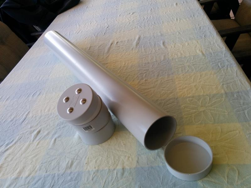

    The unit will be constructed using 100mm pvc pipe and connectors. There will be 4 touch studs, these will be stainless M8 cup head bolts.
    Here are the main parts to the housing. The end cap will be glued on the pipe and then partly buried. Once in the ground i will fill it with 20mm gravel to keep it stable. The touch studs and node electronics will all be located in the top joiner and cap.

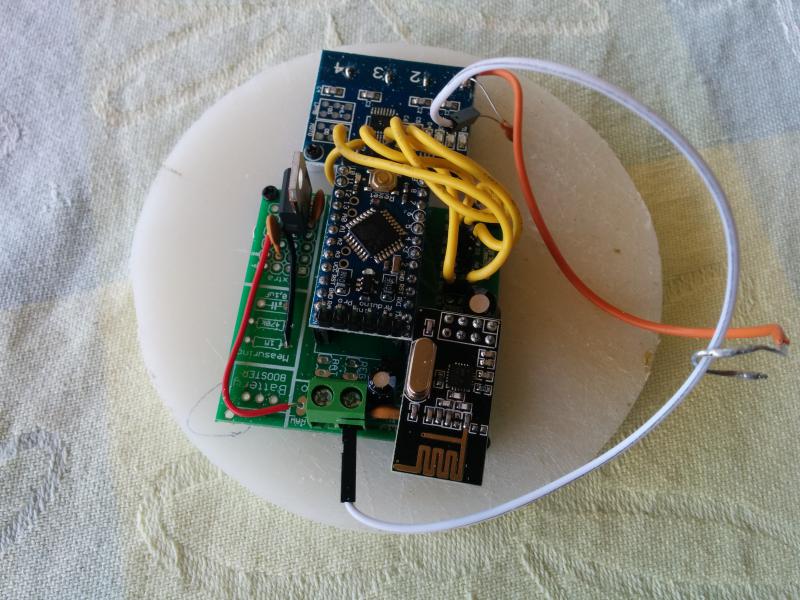

    The joiner has a lip around the inside, i have used that to hold the arduino etc.
    The mounting plate is made from an old plastic cutting board
    It just slips into place and uses gravity to hold it there.
    The cap with the studs uses solid wire held in place with hot glue to run out to the touch switch wires . Single dupont connectors push directly on to these. It is important to keep the wires separate from each other to reduce the chance of cross triggering.

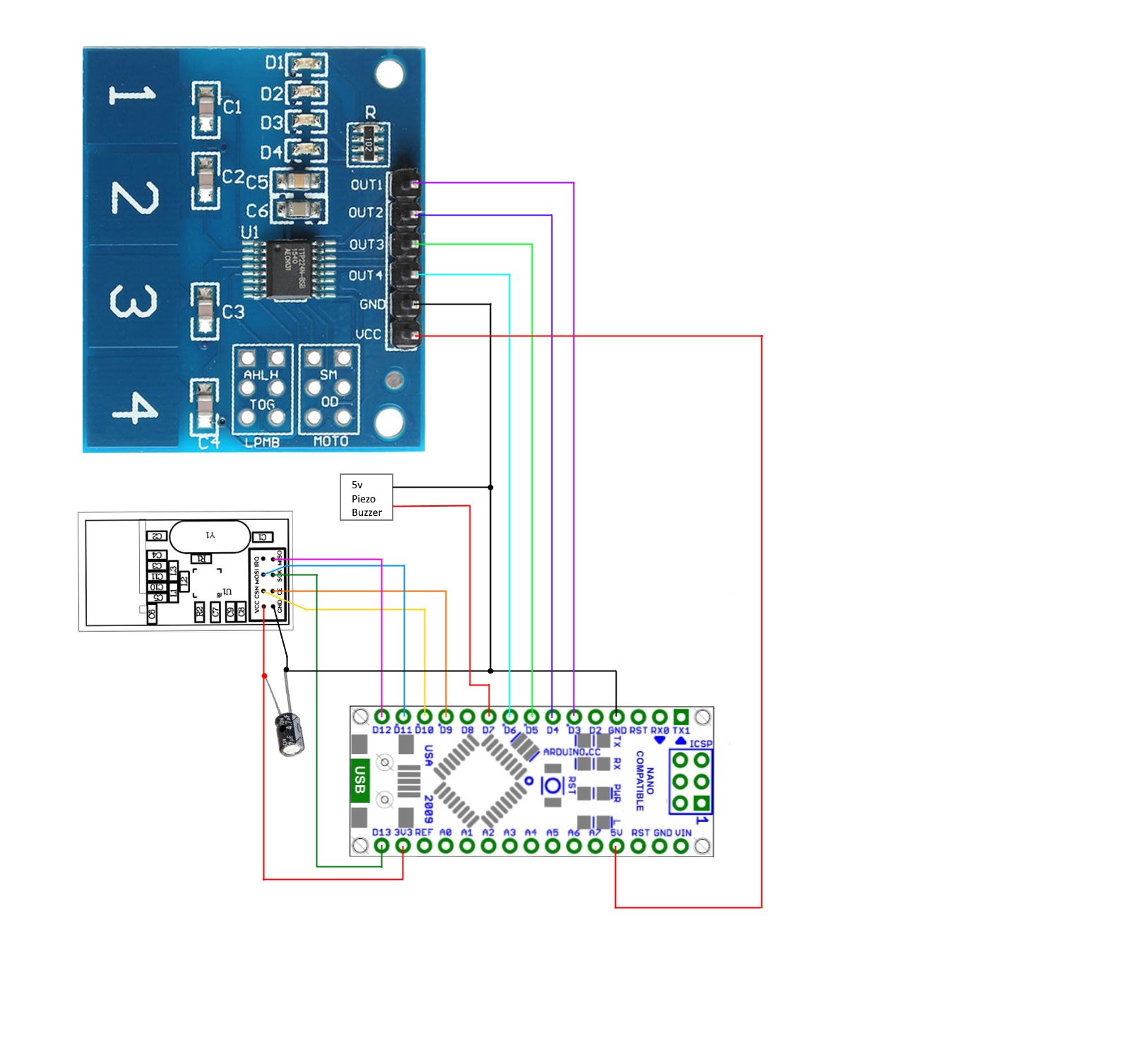

    The circuit diagram. This shows it with a nano but I have used a pro mini in the actual unit.
    The Sketch for the touch controller is below. It is working ok on the bench. As you can see three of the the buttons all switch the same node at the moment. I will change these to the correct id's once it is installed outside.
