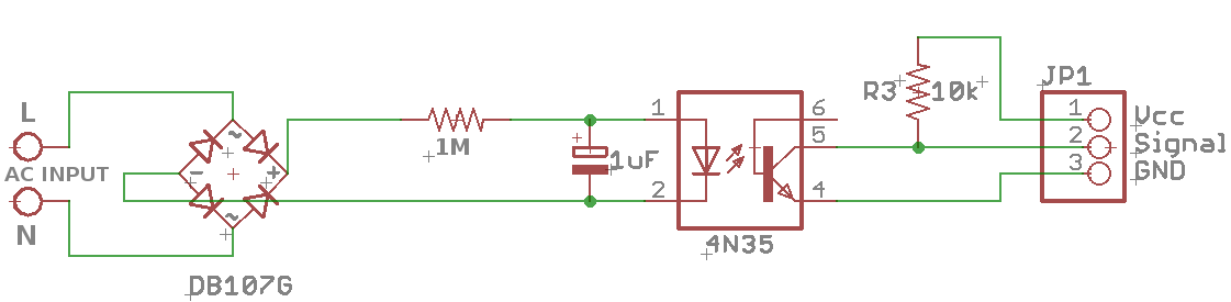

    Hi all,
    I'm using the circuit below to detect when my generator is running, I can see PIN 3 goes low, the signal PIN2 from the circuit is connected to D3 on the Pro-Mini
    0_1493384480433_upload-9e694aee-1f20-439b-a571-7014a901bcaa
    I'm using the motion sketch to test with and the interrupt is seen when AC voltage is activated, but while the AC voltage is on, I get switching between high and low, how can I change the program to detect when the AC voltage is present, send a message and go to sleep. When the pin changes state again, IE AC voltage is not present anymore, the interrupt is detected and another message is send and go back to sleep until the next interrupt
    Below is the code I'm using

    The Serial output is below showing the switching between high and low

    Any help or ideas on how to do this would be appreciated please

      Why is the input switching when the generator is on ? Is it switching at 50Hz (or 60Hz) or for an other reason ?
      If it is switching at 50Hz, simply require the signal to stay low for >0,02s before considering the generator is off. (As a general rule, it is a good idea to have these debounce timers.)
      If it is switching for an other reason, you'll have to find why it is doing so. A multimeter will probably of great help (or just use Serial.println(), comment the sleep() function and connect your computer to the Arduino.)

        Jan Gatzke
        wrote on last edited by Jan Gatzke
        @esawyja
        The rectifier is unnecessary, the optocoupler has an built-in diode. The 1 m resistor can burn. You'll have an voltage not much smaller than the input voltage at it. I would recommend to replace it with an capacitor.
        Like this http://www.electroschematics.com/11922/mains-voltage-sensor/
        • E esawyja
          Hi all,

          Boots33B
          Boots33B
          Boots33
          @esawyja have you tried setting the sleep time to 0 ? at the moment you are waking up the sensor every 2 minutes and it is sending data, if you set sleep time to 0 it will only wake when it detects a change in the interrupt.
          unsigned long SLEEP_TIME = 0; // Sleep time between reports (in milliseconds)

            esawyja
            Thanks All,
            I got it sort of working using the original circuit with this sketch below, using another variable with last runstate, sorry my coding is shocking.,...
