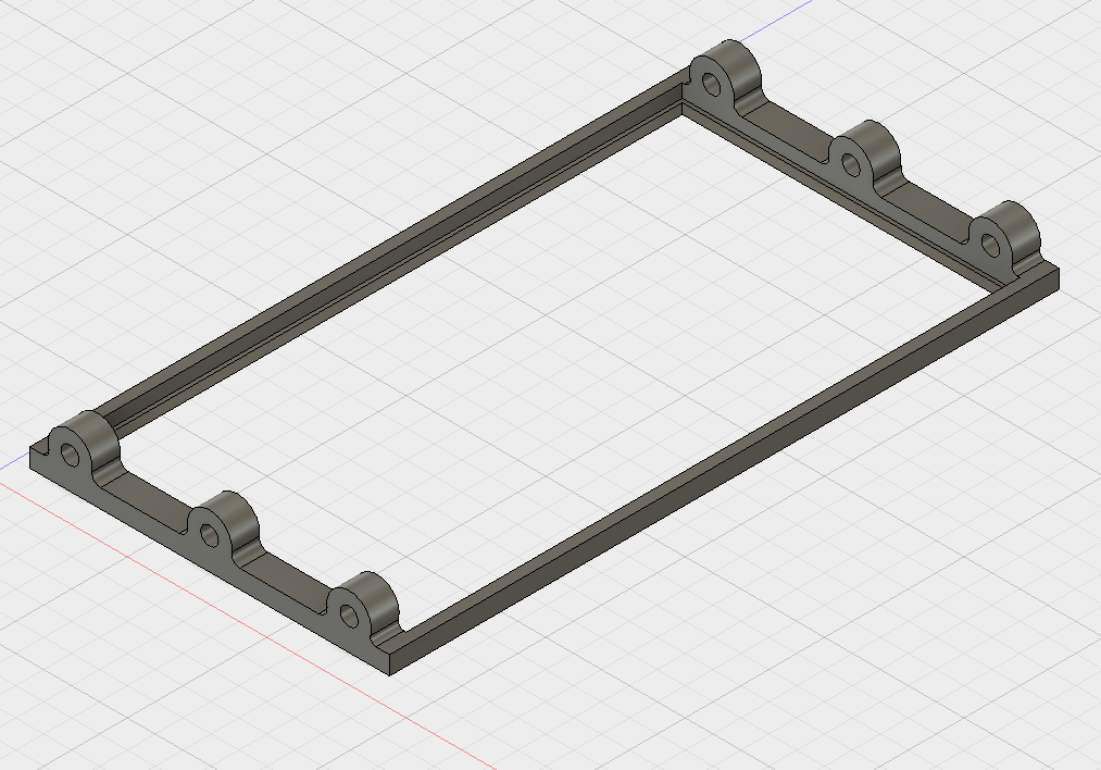

    I just published, maybe someone will be interested.
    Simple and lightweight 3D-printed solar panel housing for 60x110 mm sized panels widely available on Chinese shops. Three holes on every side for fixing housing allow to fix it in any position/angle. The same holes used to fix solar panel itself in housing.
    I'm using cheap ($1/piece) Chinese solar panels.
    http://www.thingiverse.com/thing:2303029
    0_1494200102051_SolarHousing2.stl
    0_1494200114033_SolarHousing v2.step

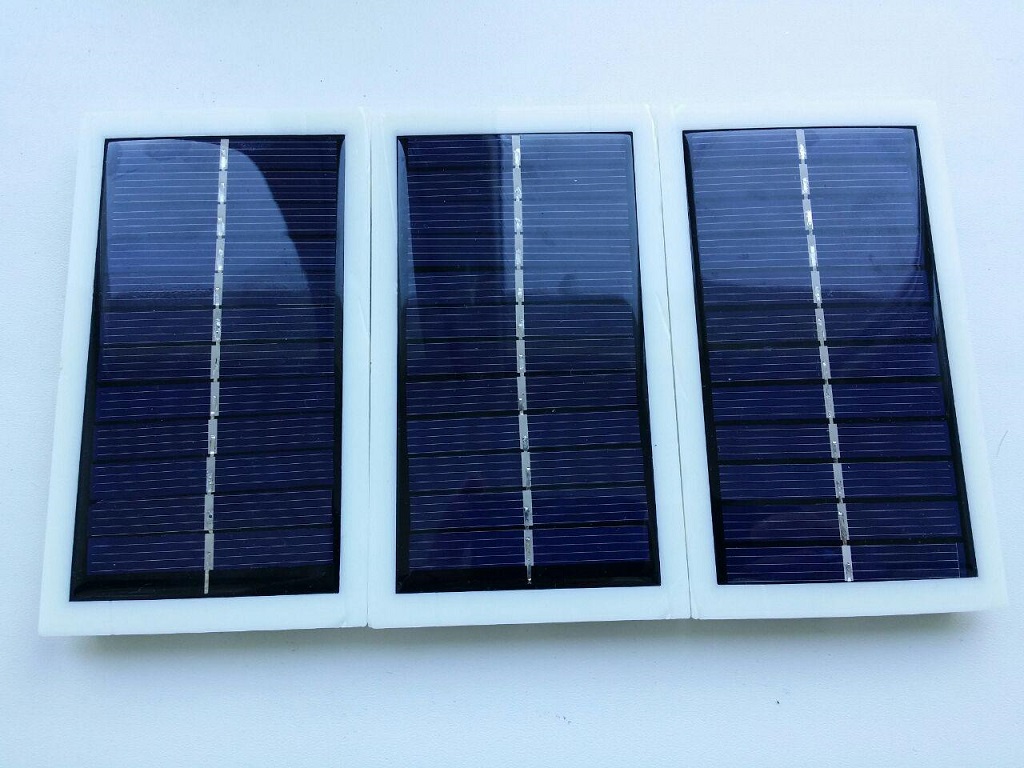

      Yet another version and first test results.
      Now I'm able to screw panels together using any side:

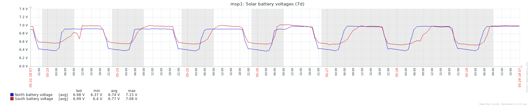

      I connected solar panels together (parallel connection, but each panel in series with it's own shottky diode). 11 panels on north side (direct sunlight from about 06:30 up to 09:00) and 5 panels on south side (direct sunlight from about 12:00 up to 19:00). Panels located on window-sill outside of house.
      On south side I'm using 6V AGM VRLA acid battery (as far as I remember 4.5 Ah), on north side battery is the same, but battery capacity is 1.3 Ah.
      At first I connected panels directly to batteries (panels open-circuit volage is about 6.8-7.5 volts), but I got weird results. When it's sunny and the sky is clear batteries are charging very slowly and then it's cloudy - batteries are charging faster. Scattering of light by clouds?
      Then I connected solar panels to step up regulators (mt3608 as far as I remember, output set to 7.0 volts), now I'm getting very good results. Both batteries are charging almost all the day.
      Graphs showing step up output voltage (connected directly to battery):
      Again, then weather is cloudy batteries are charning a little better.
      Also it seems that I have connected too many batteries. It's necessary to try only 1-2 batteries on each side.
