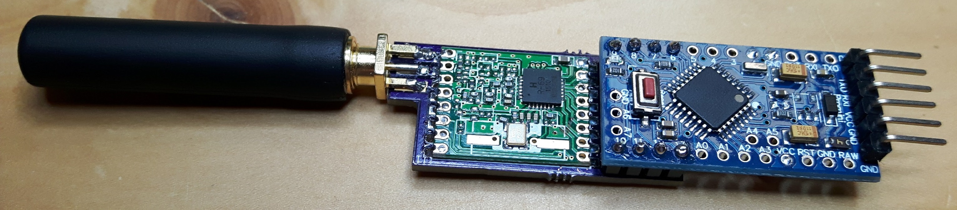

    @stevebus you are going blind :-D (like me probably) all those pins are in the ground plane, trying to provide a uniform ground to see if it improves the performance of the radio (by reducing outside interference). You can see that clearly on the gnd of the capacitor or in the gnd pad.

          Was able to finish up the soldering, and just playing with the mocksensor sketch... works great! (not sure why my pics are sideways, they are straight on my machine :-) )
          Looking at the RSSI data, this sensor seems to be about the same signal strength as my other sensors (maybe even slightly better, probably due to the shorter and more solid connections). So it seems that the performance of the radio is pretty good.

            @gohan It seems to be a standard sma size the 1.6mm distance between the legs, anyway if it is bigger you can solder only the top layer, if it is shorter, you can cut some legs.
            Not the best but it should work.

              @stevebus glad it is working i have an updated version of the pcb in the first production run, that will not need any extra wiring, i'll keep you guys updated on the progress.

                  @gohan - I have found both 1.6mm and 1mm on Ebay. Since i like to order 1mm thats what i went with SMA connector but it was way easier to find 1.6mm. I just mean a easy misstake would be to order a 1.6mm SMA connector and 1.0mm pcb. Might probably work.
