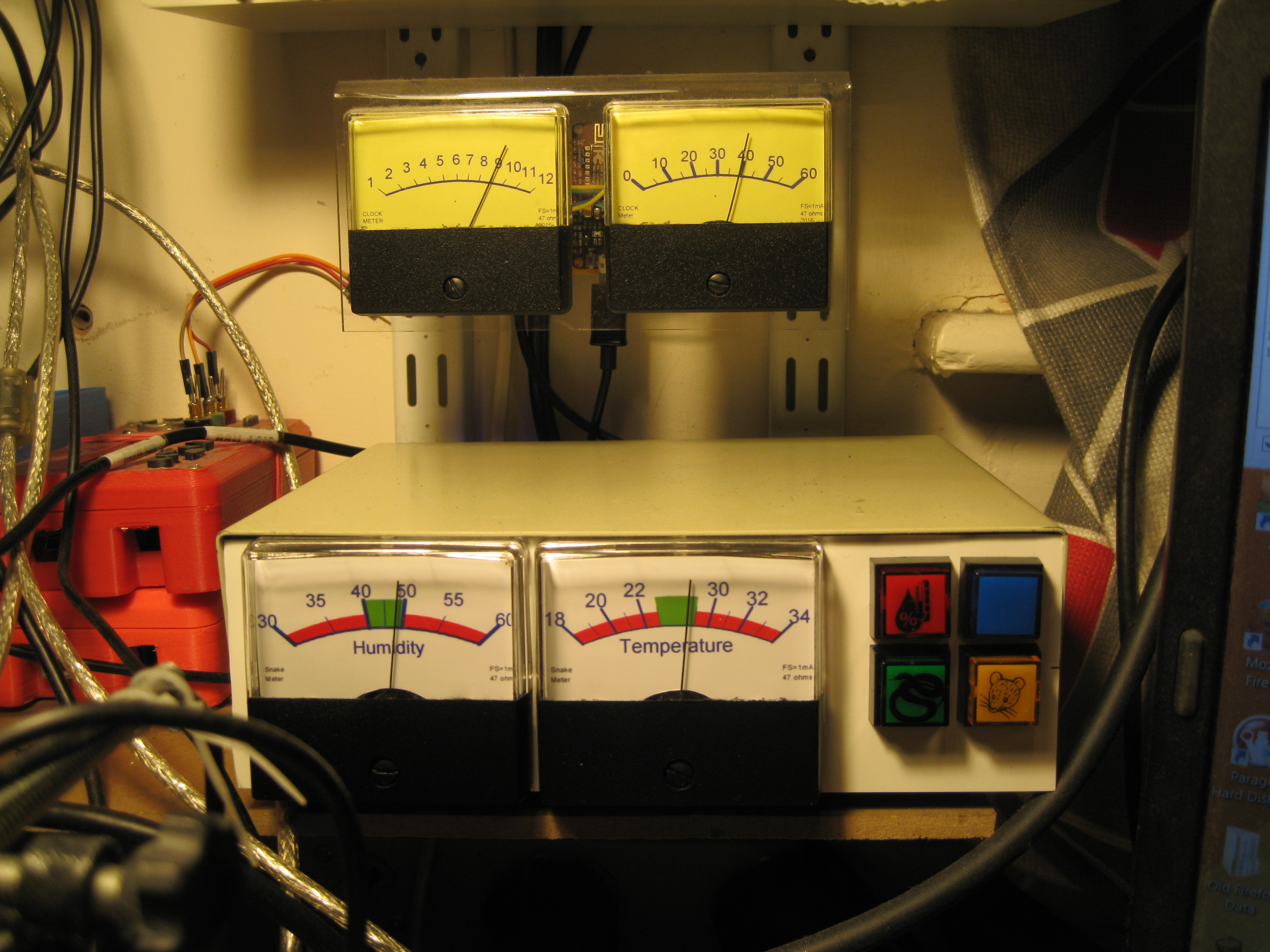

    Hello MySensor-ers,
    I recently started MySensors in combination with Domoticz.
    For a while I have had the idea to use some old panel meters (moving coil meters) to visualize for example (room) temperature or current consumption of electricity.
    When looking around I came out on the Dimmer sketch, is this the only way to control a PWM output or are there other ways to control a PWM output which is more towards a display or meter?
    second question; Does anyone have a tip to set up a script in domoticz where, for example, the measured room temperature can be sent between 0 and (max) 25 degrees to a PWM output?
    thanks in advance
    dzjr

      @dzjr I have several meters for quick indications.
      Normally i utilize a message type of V_VAR1 to 5 as these are available for all sensor types, If it just being an information sensor then I use the S_INFO device.
      I send the information to be displayed as direct units
      For example for temperature I would send V_VAR1 = 26.1 as 26.1°C or -5.5
      and then let the node set the display range.
      if you want only a linear display the following code will work,
      #define SKETCH_NAME "MySensors Meter"
      #define SKETCH_VERSION "v1.0"
      // Meter Vars
      #define METER_PIN     5
      #define METER_ID      20    // whater childId your using
      #define METER_MIN      0    // meter Minimum value
      #define METER_MAX     30
      MyMessage msg_S_INFO_VAR1(ID_S_INFO,V_VAR1);
      float info_Var1 = 00.0;
      void before()
        // put your setup code here, to run once:
        // put your main code here, to run repeatedly:
        if (message.type == V.VAR1) {
            info_Var1=message.getFloat();
          Serial.print("Incoming value for ID_S_INFO:");
          Serial.print(message.sensor);
          Serial.print(", V_VAR1: ");
          Serial.println(info_Var1,1);
          updateMeter0(info_Var1);
      void updateMeter0(float meterInput=0){
      // Meter 0   this uses the input value and simple maping
      // Note The map() function uses integer math so will not generate fractions, so can be helpful to multiply input values
      // ie using input temperature value 0 to 30°C  So multiply by 10 to get 0-to 300
      int16_t max_Output=   255;   // maximum PWM Value, 255 for Arduino Uno,  1023 for ESP8266
      meterInput = meterInput *10;
      analogWrite(meter_pin, map(meterInput,meter_MIN, meter_MAX, 0, max_Output )) ;  // map to Max PWM Level
      However i like to have arbitrary scales so normally use a look-up array for the pwm values. as used in the meters shown.

        @hard-shovel
        Thank you for your reply.
        It is indeed what I mean and wants to make.
        I have several old meters with various scales, but not all scales are usable, but that does not have to be a problem.
        If you like it, I will use your sketch as an example.
        I myself had not even thought of arranging the minimum / maximum value in the arduino.
        I'm going to set up a test soon.
        Incidentally beautifully composed box with the meters and lights!
        When I have finished I will post a photo!
        thanks again for your push in the right direction !!
        dzjr

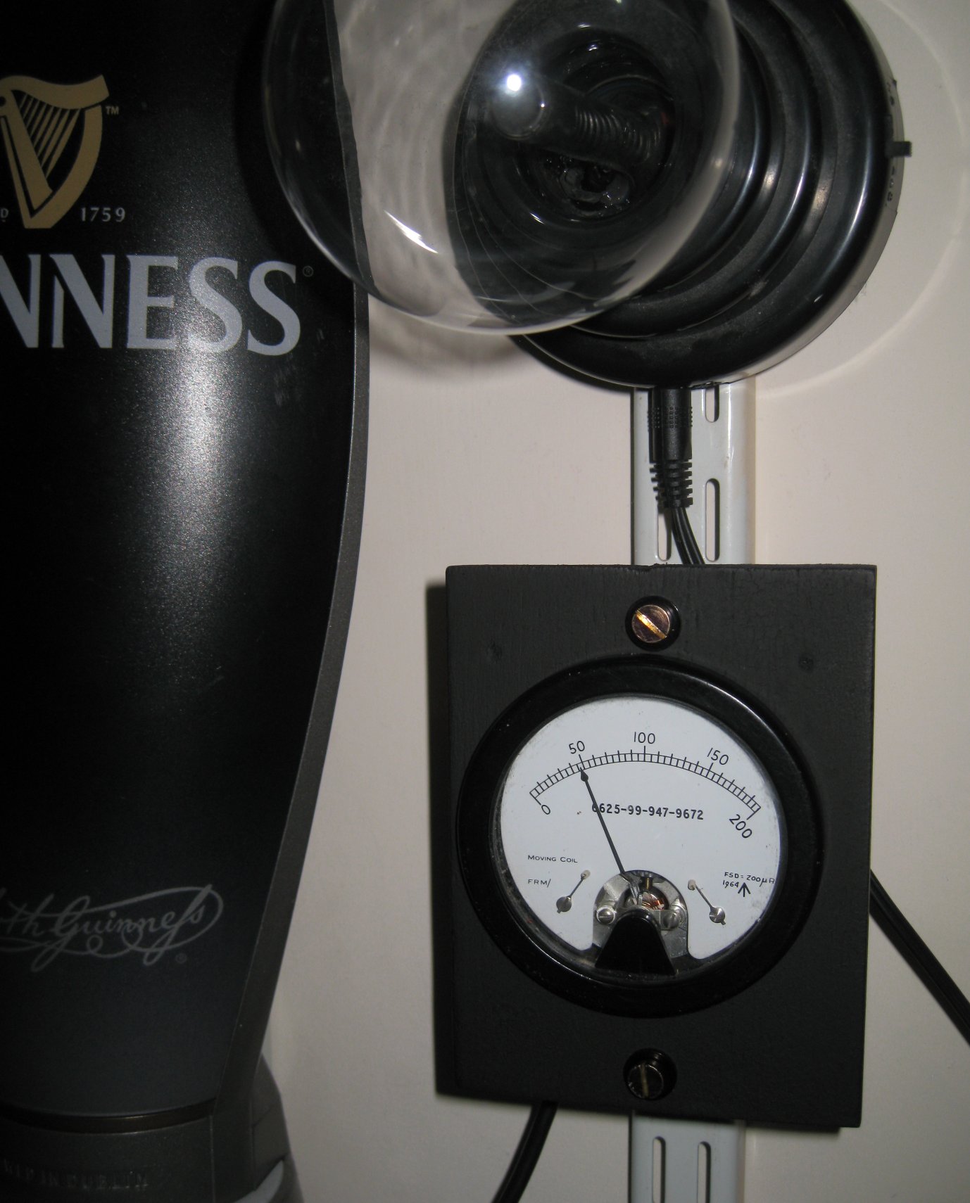

          @dzjr I also have various old meters, Some have a sealed movement so unable to change the scales.
          Below is my meter showing time since last coffee.
          • H hard-shovel

            @hard-shovel That would be the cold coffee with cream with a certain Guinness ais quoi? ;)
