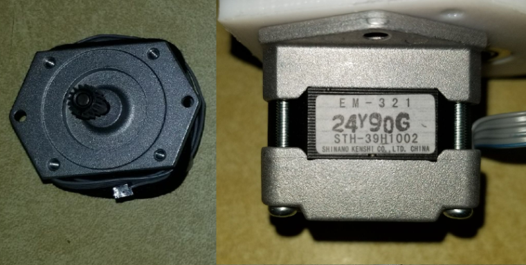

  • Trying to find a stepper that will work for the X axis is proving to be a bit troublesome. I may end up ordering one. I wish I could find a larger junk laser printer.
  • After some further review and thought, I am thinking of just getting a set of 3 motors. I figure that way I have a matched set and I am not fighting things like too slow speed on one axis that is fighting the others when milling a job. This will require some modifications to my current Y axis, but I will only have to modify the bracket on the motor side which won't be hard at all.
    The question I have is, will these motors be good enough? They are 0.9° which is 400 steps/rev vs the somewhat standard 1.8° @200 steps/rev. They are 65 oz-in bipolar motors.

    From what I've read, your GRBL controller would compensate, as it knows the speed of each motor (well, after you tell it, that is).
  • @neverdie said in DIY CNC mill from mainly salvaged and 3D printed parts:
    I figured that, but I was having trouble with a couple of the steppers that I was trying to use. Couldn't seem to get them to run reliably from the GRBL controller. The other part would have been figuring out a drive system for them as they all had geared heads. I would have had to figure out a gearing and mounting system. The motors I got were only $33 US, so basically $11/motor, so not a bad price, and I can direct couple them to the threaded rods making things easier.
