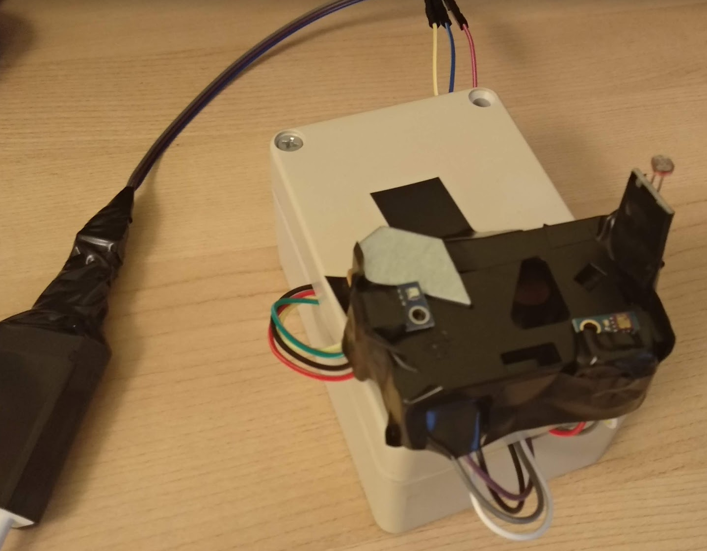

    Despite the long name, it is a pretty simple sensor to build and program.
    BOM is:
    • 1: @sundberg84 EasyPCB fro RFM69
    • 2: BME280 for Temperature + Humidity + Pressure + Weather Forecast (https://www.aliexpress.com/item/BME280-Digital-Sensor-Temperature-Humidity-Barometric-Pressure-Sensor-Module-I2C-SPI-1-8-5V-GY-BME280/32849462236.html)
    • 3: LDR sensor for light level (https://www.aliexpress.com/item/KY-018-3pin-Optical-Sensitive-Resistance-Light-Detection-Photosensitive-Sensor-Module-for-arduino-DIY-Kit-KY018/32820189174.html)
    • 4: ML8511 for UV rays (https://www.aliexpress.com/item/Analog-output-module-GY-ML8511-UV-UV-sensor-Sensor-Breakout/32533518448.html)
    • 5: DSM501A dust sensor for PM10 and PM2.5 (https://www.aliexpress.com/item/DSM501A-Dust-Sensor-Module-PM2-5-Detection-Dector-Allergic-Smoke-Particles-Sensor-Module-For-Arduino-For/32880813740.html)

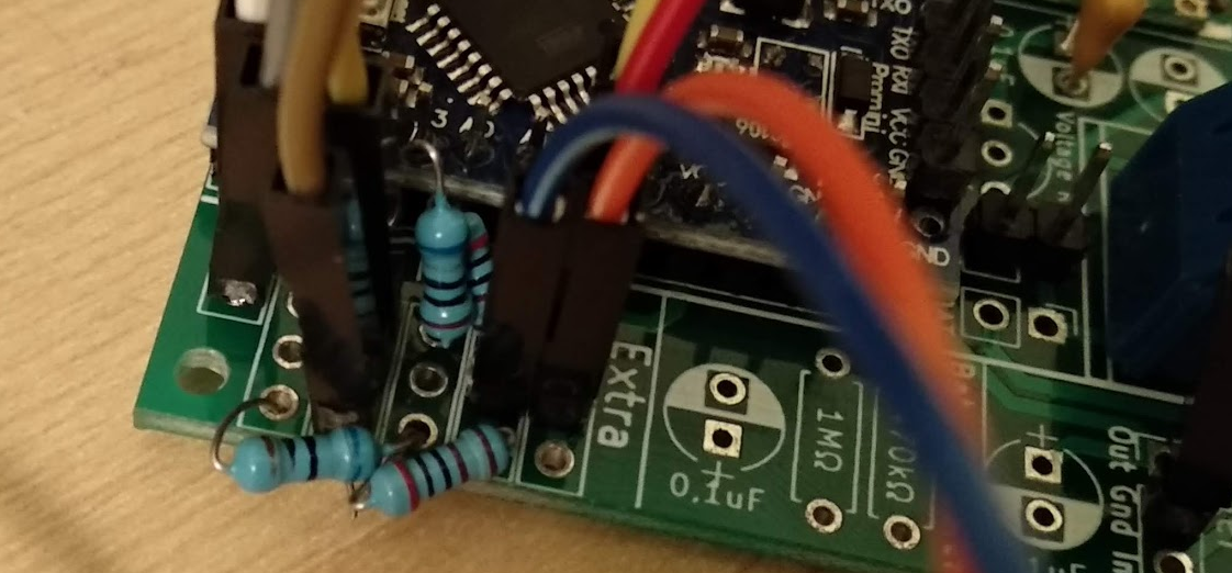

    • 5a: two pair of 1K/400R resistors as a voltage divider for allowing the 3.3V arduino to read the two 4.8V outputs of the DSM501A
    • 6: USB TTL to power both the board with the 3.3v output and the DSM501A with the 5V output (https://www.aliexpress.com/item/1pcs-USB-to-TTL-converter-UART-module-CH340G-CH340-3-3V-5V-switch/32668180966.html)
    Of course this cannot run on batteries since the DSM501A requires at least 90mA to work.
    Wiring is pretty simple, with BME280 connect to A4-A5 for I2C communication, the LDR to an analog pin, ML8511 to another analog pin, DSM501A connected to two digital pins through the voltage resistor 5a.
    All those sensors are supported by NodeManager so the code is super-simple, with the board reporting battery and signal level periodically as well. All sensors reporting every 5 minutes but the DSM501A reporting every 10 minutes (since for a measure it take 1-2 minutes):

    And this is the final result (yes the box doesn't look really great):
    Overall everything works fine even if I'm not that satisfied of the DSM501A sensor since most of the times it doesn't return a valid read (negative value which is then ignored) and when it does the value looks to me a bit too high (I should be already dead if this level of pollution would be real :P).
    Hope it can help
    • Nca78N Offline
      Nca78N Offline
      interesting range of sensors, but you should not use the DSM501. It can't produce a constant airflow, so it can't give you any valid result. It's cheap, but completely useless.
      Chose a sensor with integrated fan, like Plantower PMS7003 or PMS5003, they do a good job for a reasonable price.

        @nca78 thanks a lot for the hit, I'll buy what you recommended and try it out! And yes the DSM501 seems pretty useless right now, I thought was because of the power supply but doesn't look like the case. Thanks again

          @user2684 I forgot to tell you to buy one with a cable. They use a connector with 1.25mm spacing and it is not possible to connect anything else. You can make the cable breadboard friendly by soldering the ends to a 2.54mm header.
