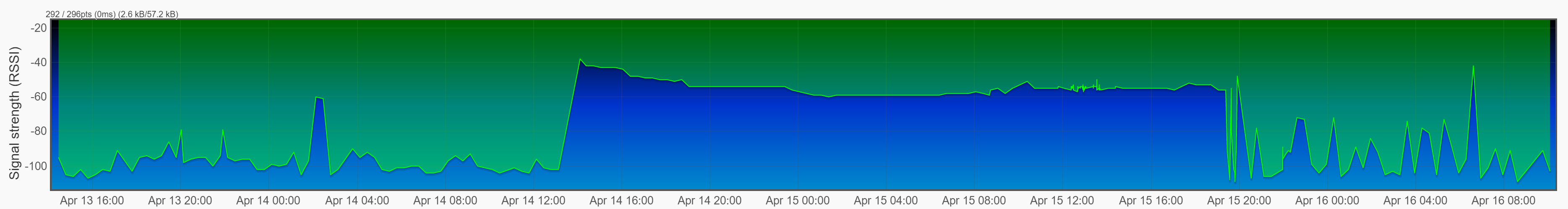

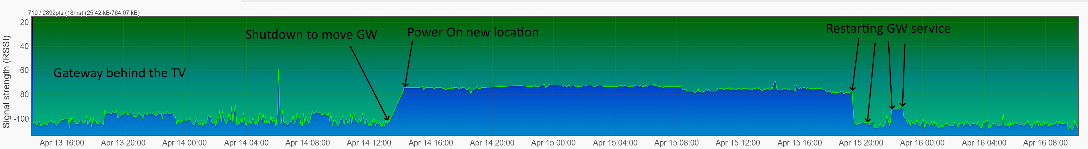

    I have a Raspberry pi 3 with a RFM69HW connected directly to GPIO pins as MySensors gateway. 868Mhz.
    For months the gateway was placed behind the TV with an antenna dangling 30 cm below the TV. With this setup the average RSSI value for messages form nodes was around -100. Mounting the antenna just behind the TV stopped all communications so I attributed the low RSSI to TV's proximity.
    Recently I prepared a new location for the gateway and moved the Pi. RSSI value improved considerably and was very stable at around -80 for most nodes in the house, some higher than this.
    A day after the move, I had to reboot the Pi and the RSSI value dropped back to an average of -100. No hardware change.
    I tried multiple reboots and got some inconsistent results as seen in the first image.
    I made a new HAT with a brand new radio with a bigger ground plane. Same results.
    This node is a floor up with a reinforced concrete slab in between, opposite sides of the house.

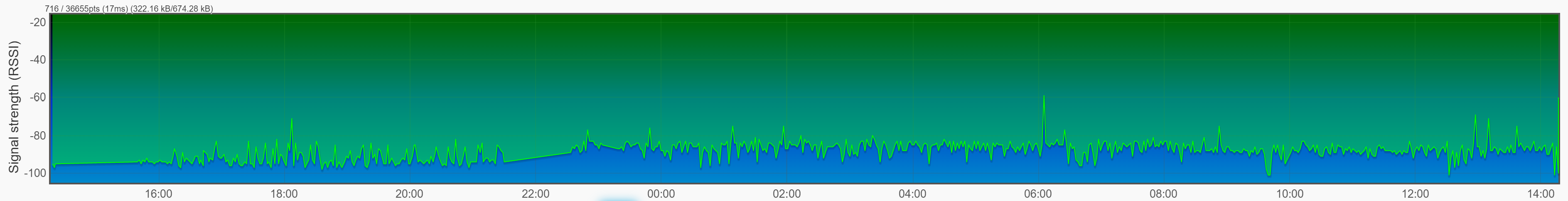

    This is a relay node 2 m from the GW. It is rarely actuated (very low message rate) and usually only responds to discovery messages. After the GW move the tx power was very high and ATC adjusted it from -40 to -60.
    I made a signal strength node. It goes to full power because RSSI is so low. If I set the lowest power, signal strength does not drop and all messages are received OK. The RSSI value for messages from GW have an RSSI of -60. If I take the signal strength node closer to the GW (a meter away), still no change. only node's RxRSSI increases.
    I've been trying to understand this for days. The problem is that all nodes max out on power because of this value.
    Another test I did:
    I made 1 node and 1 gw based on Lowpowerlab's library (LPL) (atmega328 + rfm69hw + Ft232), connected the LPL_GW to the Pi and measured the received signal strength. -60 when LPL signal strength node is on a different floor, and increases to -30 when moved in the same location.
    I will try to use this hw for a usb connected mys gateway, but other than this I am out of ideas.

      With serial gateway attached to the Pi, RSSI varies based on distance, the right way. The node very close has a -45 value, and the rest from -65 to -80.
