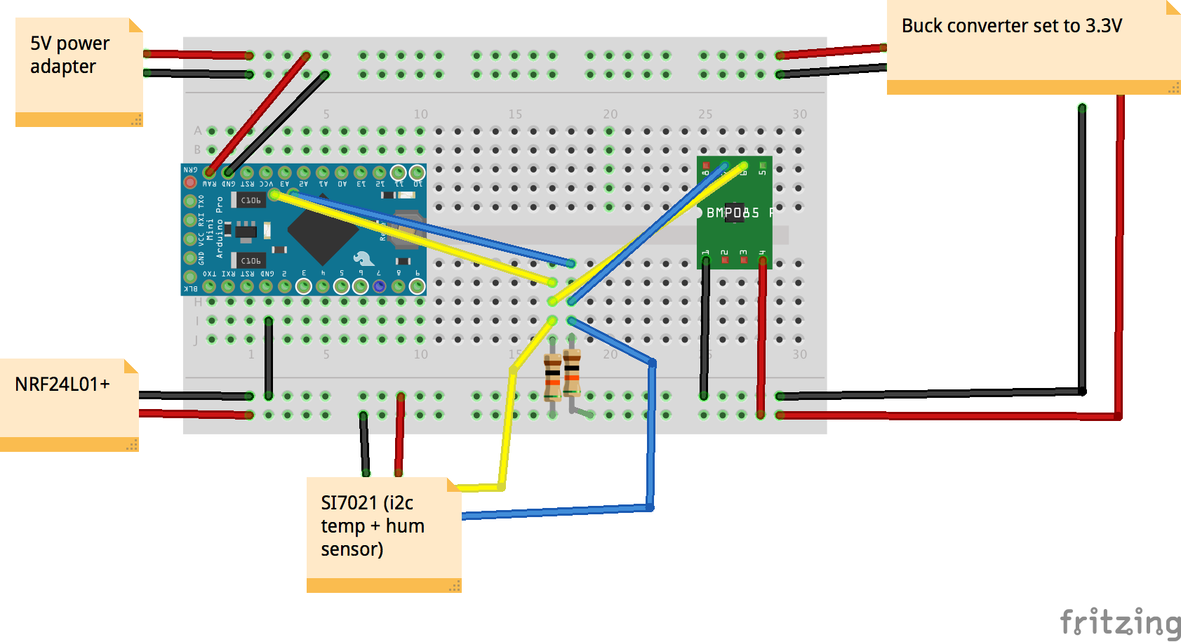

    Here is the fritzing. I forgot the lightlevel sensor, but you can find how to wire it on the MySensors main page. For stability I power nothing from the Arduino. I use a Pro Mini 3.3V which I power with 5V from an adapter. I've used a cheap aliexpress buck converter and set it to 3.3V. That's my 3.3V power for the sensors and the radio.
    Fritzing
