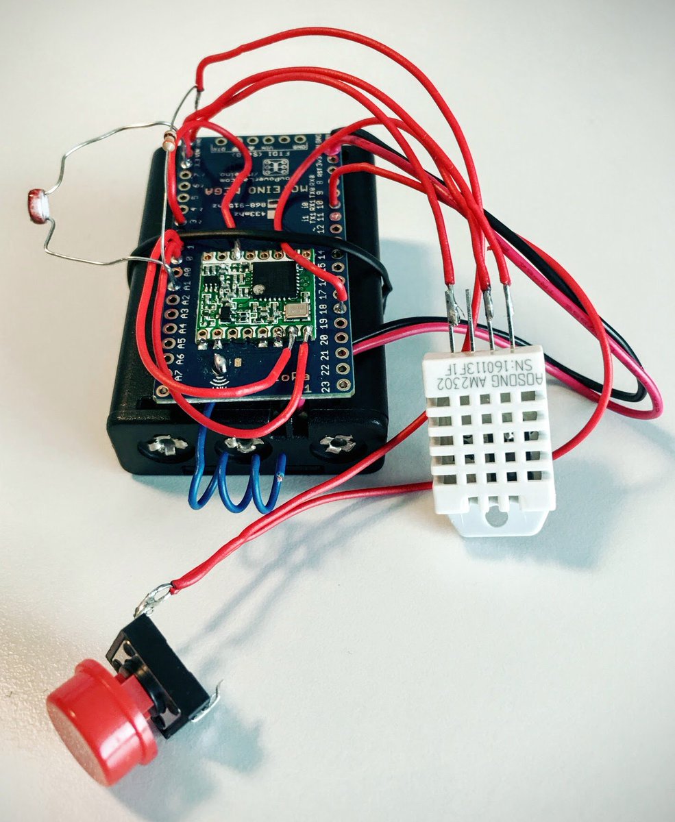

  • Sort of yes. My problem is with the battery. I initially set it to wake every 300s and whenever the sensor door triggers. The battery drained within a few weeks. Then I changed the wake cycle to 10800s (3h) and the battery holds up pretty well.
    The battery problem is cause by the mode that I have to use:
    RFM95_BW125CR48SF4096. Moreover, it seems that the transport is not really reliable. Here's last 24h log

  • This is a moteino Lora node.
    I understand the battery consumption is not an issue, but again I have not measured the current.
