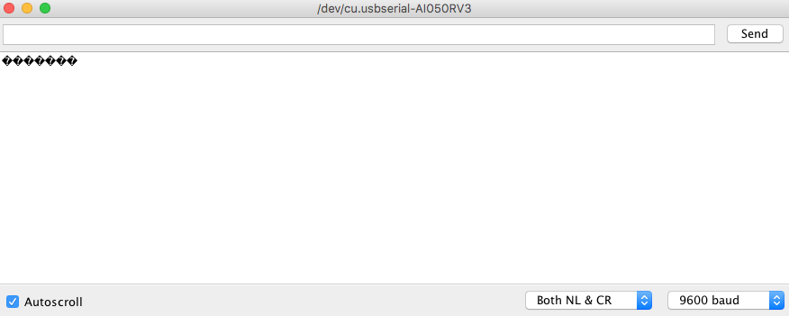

    I was able to upload scetch to my Sensebender Micro (1MHz) board, but I'm not able to read from console.
    I read, that it is related to baud rate of console - I have tried to change the baud rate to many possible values, but none worked yet.
    Could somebody help to identify my problem?
    Here is the code:

    Here is output I see:
    This is what I see during compilation and uploading:
      Here is the code:

      Any idea what I should fix to be able see debug messages in console?
      Thank you for help.

      tbowmo
      @Viktor-Zeman
      Have you reprogrammed the fuses, so it runs at 1Mhz and not 8Mhz?
      Default fuse settings in Sensebender Micro is 8Mhz
      • Viktor ZemanV Offline
        Viktor Zeman
        Thank you for clarification, I have switched in Arduino IDE Processor to 8MHz and I can see the the serial console messages correctly now.

            If we look at the datasheet for atmega328 pages 336 and 337, there are a couple of graphs, showing the approximate active current, given at different frequencies / voltages..
            with a voltage of 2.7V, running at 1Mhz, the consumption is around 0.4mA, while running at 8Mhz, it's around 2mA. This seems to be a large difference, but let's take into account that the microprocessor is 8 times slower at running the same code when running at 1Mhz, than at 8Mhz, then in theory it is awake 8 times as long, when running at the lower frequency..
            If we then do a rough calculation, saying that a loop takes 1 second @8Mhz, it will take 8 seconds @1Mhz. if we "transform" this to mAh, it will give a rough data like
            running @1Mhz : (0.4 * 8 ) = 3.2
            running @8Mhz : 2.0 * 1 = 2
            And from this, we can see that running at 1Mhz, will (in theory) actually consume more power than running on 8Mhz, because the "high" current consumption will last longer at 1Mhz, than it will on 8Mhz.
            When that's said.. If you want to run at 1Mhz, you can use avrdude, and a avr ISP programming dongle to program fuses. Check out this tutorial
            Viktor Zeman
            @tbowmo great answer! I agree, you are right, it has no sense to change frequency in my case. I want to measure temperature each few minutes and than sleep ...
