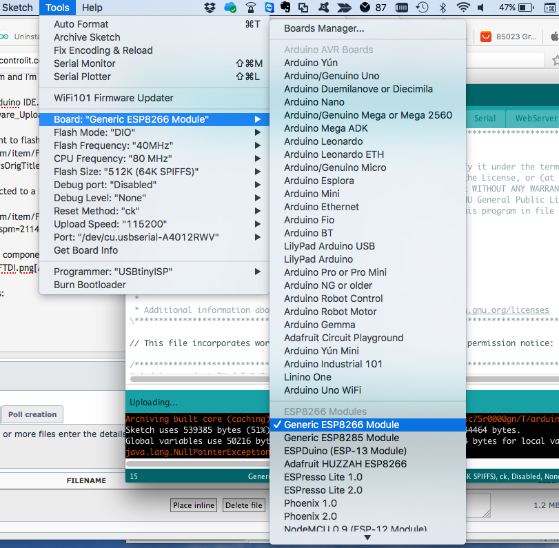

    Now I want to flash the sketch to my ESP-01 module bought at aliexpress, I have the black one.
    (https://nl.aliexpress.com/item/Free-Shipping-10pcs-lot-ESP8266-remote-serial-Port-WIFI-wireless-module-through-walls-Wang/2038015501.html?isOrigTitle=true)
    This ESP-01 I have connected to a FT232RL-FTDI-USB-to-TTL-Serial-Adapter-Module-for-Arduino-Mini-Port-3-3V-5V (put it on 3,3V)
    (https://nl.aliexpress.com/item/FT232RL-FTDI-USB-to-TTL-Serial-Adapter-Module-for-Arduino-Mini-Port-3-3V-5V-Free/32422482038.html?spm=2114.13010608.0.0.tkVnNb)
    I have connected these 2 components in the following way:
    Now the questions comes:
    What board and other settings do I have to choose here?
    More or less the same question is what programmer do I have to choose;
    Compiling the sketch for the Generic ESP8266 gives errors but for NodeMCU 1.0 it is going OK, but I can't get it flashed.
    I know this are all newbie questions but I hope for some answers so I can come on my way :D

      I think the generic board does not work because the default settings are not sufficient for ms. Be sure the settings match your actual esp8266 module.
      Did you pull down gpio0 when you powered on the module? This activates the programming mode.
      If you want to go the easy way just get a node mcu compatible board like wemos d1 mini. It has an onboard USB port and you don't have to manually put it in programming mode.
      Mqtt adds complexity. If you don't need it you should choose plain ms.
