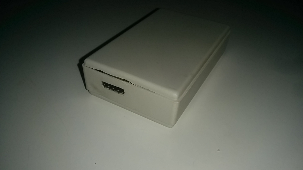

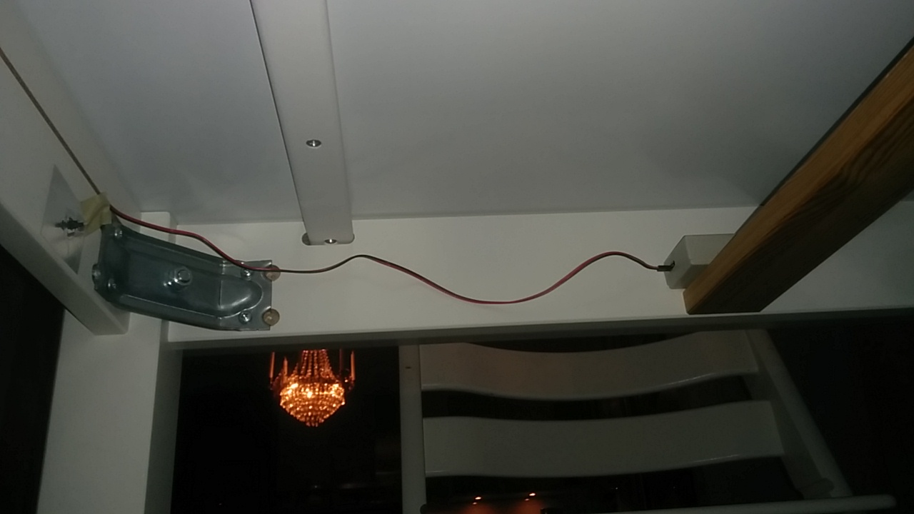

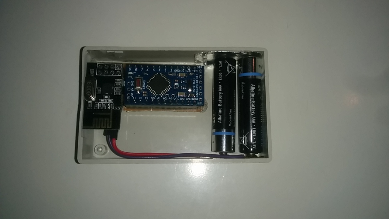

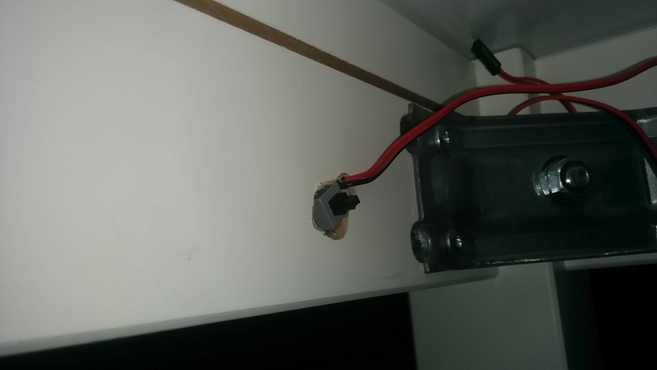

    EDIT 2017-06-26
    Some pics.

                N Offline
                N Offline
                @xydix said in Smart button / scene controller:
                The battery gets reported when the messages arrive but the messages don't get through every time.
                The LED (not the powerLED, i cut that one) on the pro mini just flickers instead of a solid light..
                This is normal, it's connected to pin 13 which is the clock pin of the SPI so it's not on full time, and not on at all when the node is not sending.
                This is the sketch.
                I don't see the place where you read the battery level ?
                • xydixX Offline
                  xydixX Offline
                  xydix
                  wrote on last edited by xydix
                  Thank you. It is solved now.
                  Here is the new sketch reporting battery level using the vcc library.
                    Mysensors Smart Button
                  #define MY_NODE_ID 7
                  #include "OneButton.h"
                  #include <Vcc.h>
                  #define SN "Kitchen Table"
                  #define SV "1.0"
                  #define CHILD_ID 1
                  #define SLEEP_PIN 2
                  // Setup a new OneButton on pin D2. true will set pin high (internal pull up), false will set pin low.
                  OneButton button(2, true);
                  unsigned long previousMillis = 0;
                  unsigned long currentMillis = 0;
                  const long interval = 5000;
                  const float VccMin   = 1.9;           // Minimum expected Vcc level, in Volts. (NRF can only go to 1.9V)
                  const float VccMax   = 3.3;           // Maximum expected Vcc level, in Volts.
                  const float VccCorrection = 1.0 / 1.0; // Measured Vcc by multimeter divided by reported Vcc
                  Vcc vcc(VccCorrection);
                  MyMessage on(CHILD_ID, V_SCENE_ON);
                  // setup code here, to run once:
                    // link the doubleclick function to be called on a doubleclick event.
                    button.attachClick(click);
                    button.attachDoubleClick(doubleclick);
                    button.attachPress(press);
                  } // setup
                  void presentation()  {
                    sendSketchInfo(SN, SV);
                    present(CHILD_ID, S_SCENE_CONTROLLER);
                  int messageA = 1;
                  int messageB = 2;
                  int messageC = 3;
                    currentMillis = millis();
                    // keep watching the push button:
                    button.tick();
                    if (currentMillis - previousMillis >= interval) {
                      previousMillis = currentMillis;
                    float p = vcc.Read_Perc(VccMin, VccMax);
                      sendBatteryLevel((uint8_t)p);
                      Serial.println("Sleep");
                      sleep(SLEEP_PIN - 2, CHANGE, 0);
                  } // loop
                  // this function will be called when the button was pressed one time
                  void click() {
                    send(on.set(messageA));
                  // this function will be called when the button was pressed 2 times in a short timeframe.
                  void doubleclick() {
                    send(on.set(messageB));
                  } // doubleclick
                  // this function will be called when the button was pressed for about one second
                  void press() {
                    send(on.set(messageC));
