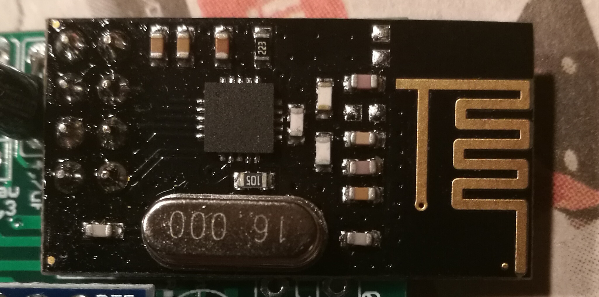

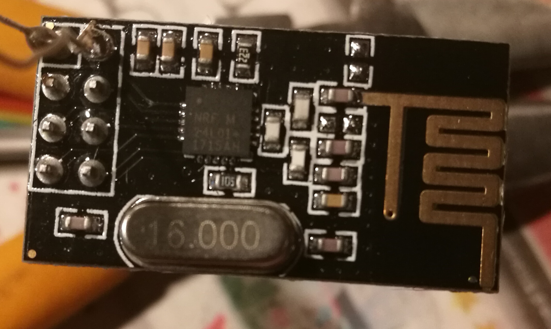

            can you post a picture of those radios?

              @gohan Sure. I have tried 9 or 10 out of 13 now i think. With different libs and sketches that google found for me.

                2_1500328749598_IMG_20170717_235131.jpg 1_1500328749598_IMG_20170717_235309.jpg 0_1500328749598_IMG_20170717_235509.jpg
                The first and second picture is from a seller called axeprice on ebay. Two different orders with a couple of weeks apart.
                The third picture is from a swedish shop called m.nu, great shop I might add.
                  How much were they? They look quite on the cheap
                  R 1 Reply Last reply

                          @royson84 10 modules for 10$ are definitely fake clones I'd say but at least they should power up

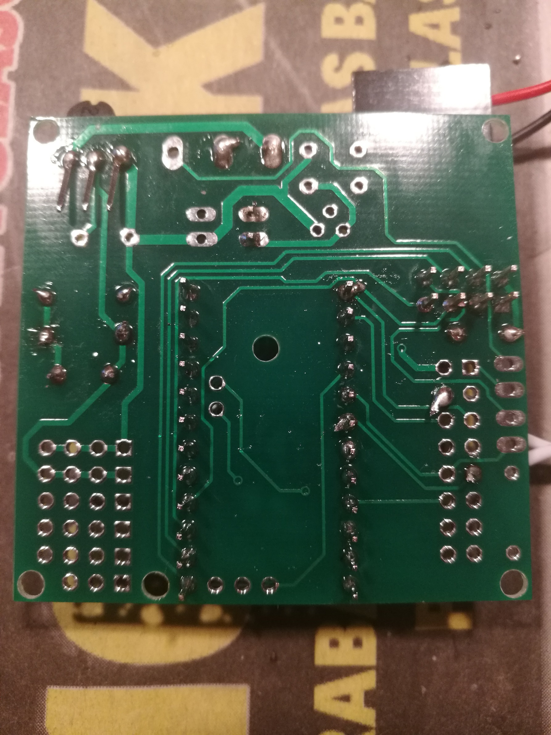

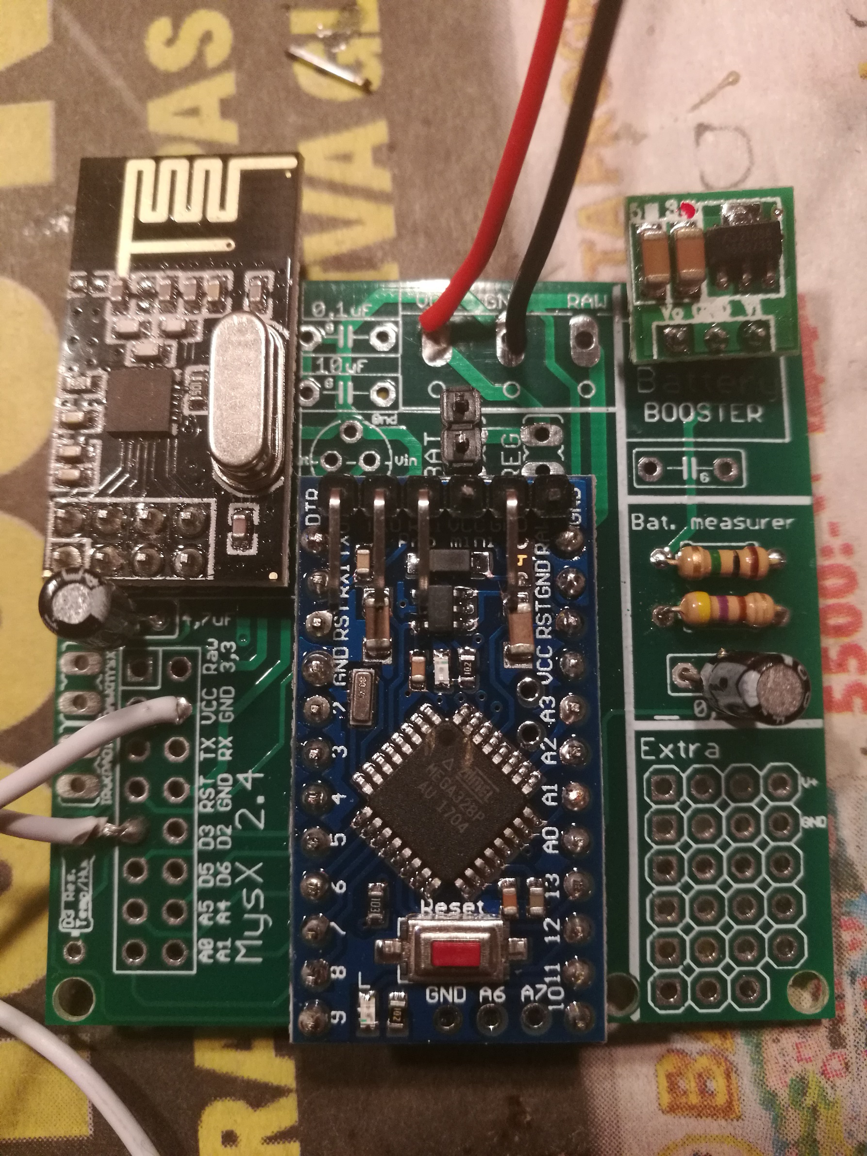

                                    Heres pictures of one of the PCBs @sundberg84. Not sure why the power isnt reaching the radio in its full capacity. Have i not been careful enough with my soldering?
                                    sundberg84S 2 Replies Last reply

                                      #27
                                      @royson84 the bat jumper isn't shorted on these pictures it looks like. You need to make a connection between the pins.
                                      Also there are two solder blobs that might cause grounding. (Vcc on MysX connector and tx on the arduino both on the back)

                                        #28
                                        @royson84 you can use the multimeter and connect/hold black to ground and measure your way through the circuit to see where the power cuts. For the radio you can go Vin, jumper, radio.
