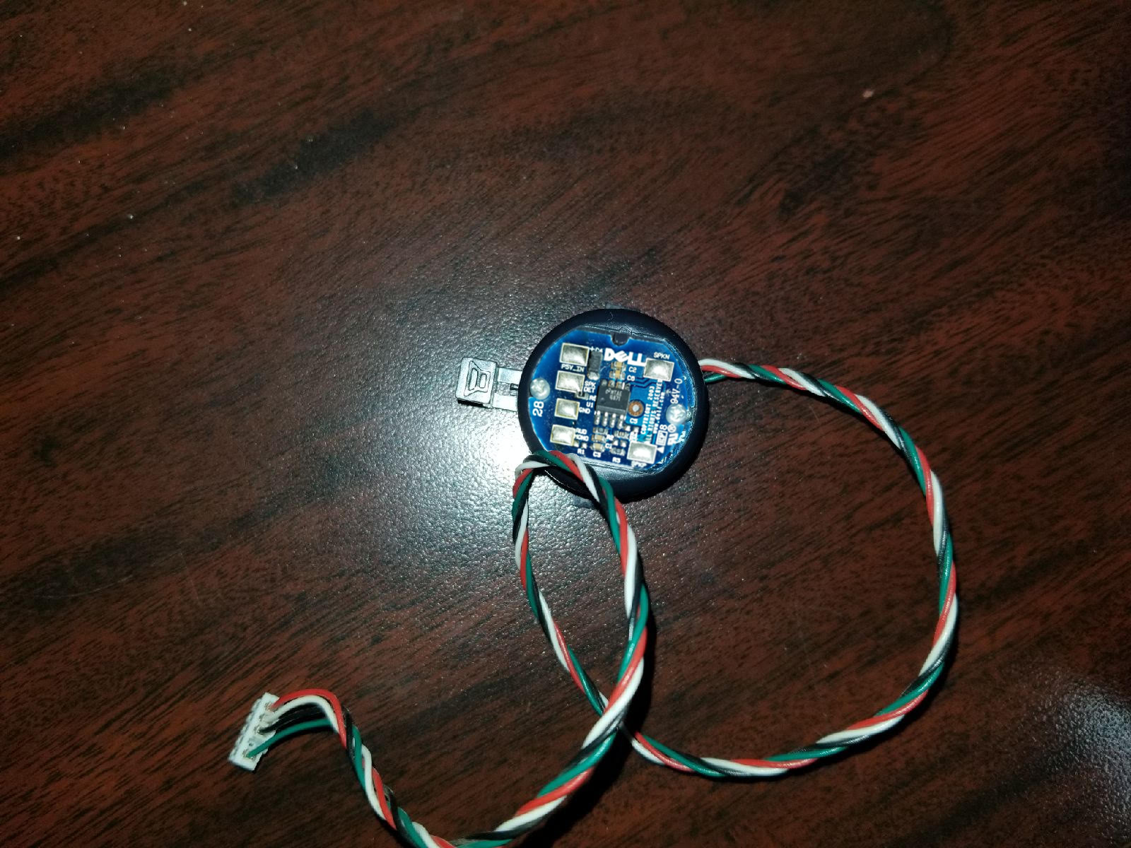

    So I found this speaker module that I salvaged from an old Dell computer that looks a bit interesting. It appears to take a 5V power input and an audio signal and runs the small speaker with a built in amplifier. The diameter of the speaker is about 31mm and the whole module with the tab is about 44.45mm. The number on the chip is 4871 and appears to be a national semiconductor chip. When I looked that number up for NS, The only thing I found was an LM4871 which I am assuming is the chip as it is a 3W audio power amplifier.
    Seems like it would be a good little module to use for some kind of audio alert/alarm for a project.
    It has 4 wires to it with 4 connections labeled on the board. There are the obvious P5V_IN, GND and AUD MONO. Which I assume are 5 volt power, ground and mono audio in respectively. I am not sure what SPK DET would be though. Does anyone have any ideas?

      I’m pretty sure the SPK DET lead allows the computer to know if there’s a speaker in place; my VOM shows it tied to ground.
      According to https://www.contrapositivediary.com/?p=1758

        @mfalkvidd Great info. Thanks.
