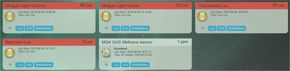

    I've updated my domoticz to this latest stable version. But now all my MySensors (v2.2) light sensors (photo-resistor sending V_LIGHT_LEVEL numbers) are not working.
    I can see all of them sending the number in the Setup tab. But on my devices the reported light is nomore updated and only the last value (acquired before the update of Domoticz) is displayed, as in the image attached
    It's not related to MySensors (v2.2) for sure because all my problems arose when I've updated to the latest Domoticz (4.9700).
    I'm sending messages of V_LIGHT_LEVEL type for my S_LIGHT_LEVEL sensor.
    Again, only after the Domoticz upgrade all the S_LIGHT_LEVEL sensors vales are not displayed...
    Do you know any reason? I've opened also a trouble ticket on the Domoticz github page (https://github.com/domoticz/domoticz/issues/2687)
    Thanks in advance!

      @ricmail85 Every time after a major update I lose sensors in Domoticz. This is very annoying. The old sensors stop working and new ones appear and as I have lua scripts - they have to be updated as well.
