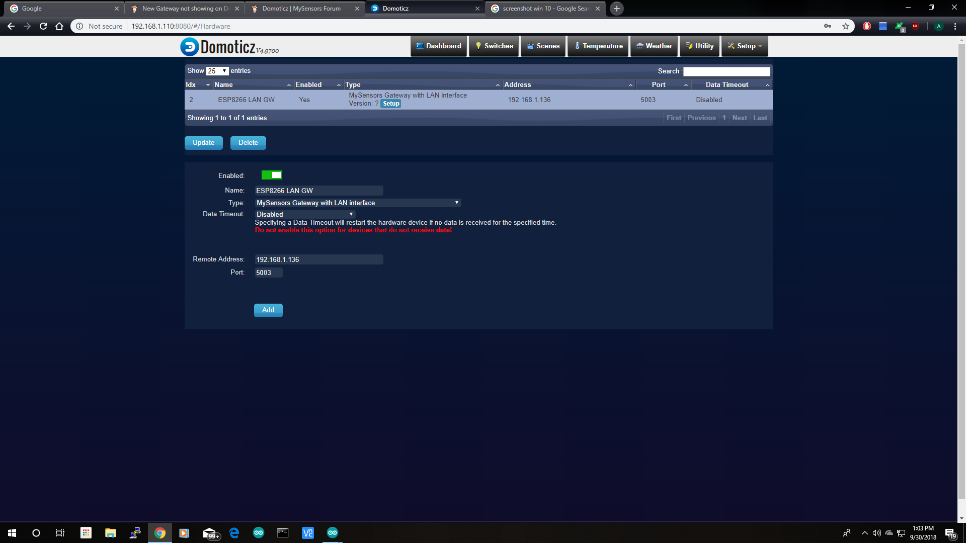

      @andrew-maynard what does the domoticz log say?
      Could you post the domoticz hardware configuration for the gateway?

        Domoticz Log
        2018-09-30 16:52:49.919 Error: MySensors: Can not connect to: 192.168.1.136:5003
        2018-09-30 16:53:19.921 Status: TCP: Reconnecting...
        2018-09-30 16:53:23.922 Status: TCP: Connection problem (Unable to connect to specified IP/Port)
        2018-09-30 16:53:23.922 Status: TCP: Reconnecting in 30 seconds...
        2018-09-30 16:53:23.922 Error: MySensors: Can not connect to: 192.168.1.136:5003
        2018-09-30 16:53:53.925 Status: TCP: Reconnecting...
        2018-09-30 16:53:57.926 Status: TCP: Connection problem (Unable to connect to specified IP/Port)
        2018-09-30 16:53:57.926 Status: TCP: Reconnecting in 30 seconds...
        2018-09-30 16:53:57.926 Error: MySensors: Can not connect to: 192.168.1.136:5003
        At one point it was working great. First time was extremely simple to set up. only difference is the actual esp8266. Therefore new IP address and no setup info. Everything is soldered together. Im about to desolder it and switch.

            @andrew-maynard your Domoticz configuration is for a gateway in tcp server mode, but your gateway sketch is configured for udp client mode. Two wrongs doesn’t make a right in this case :)
            Remove MY_CONTROLLER_IP_ADDRESS and MY_USE_UDP

              Once again thanks for your help! of course it works now lol. i soldered it back together and it works perfectly!
