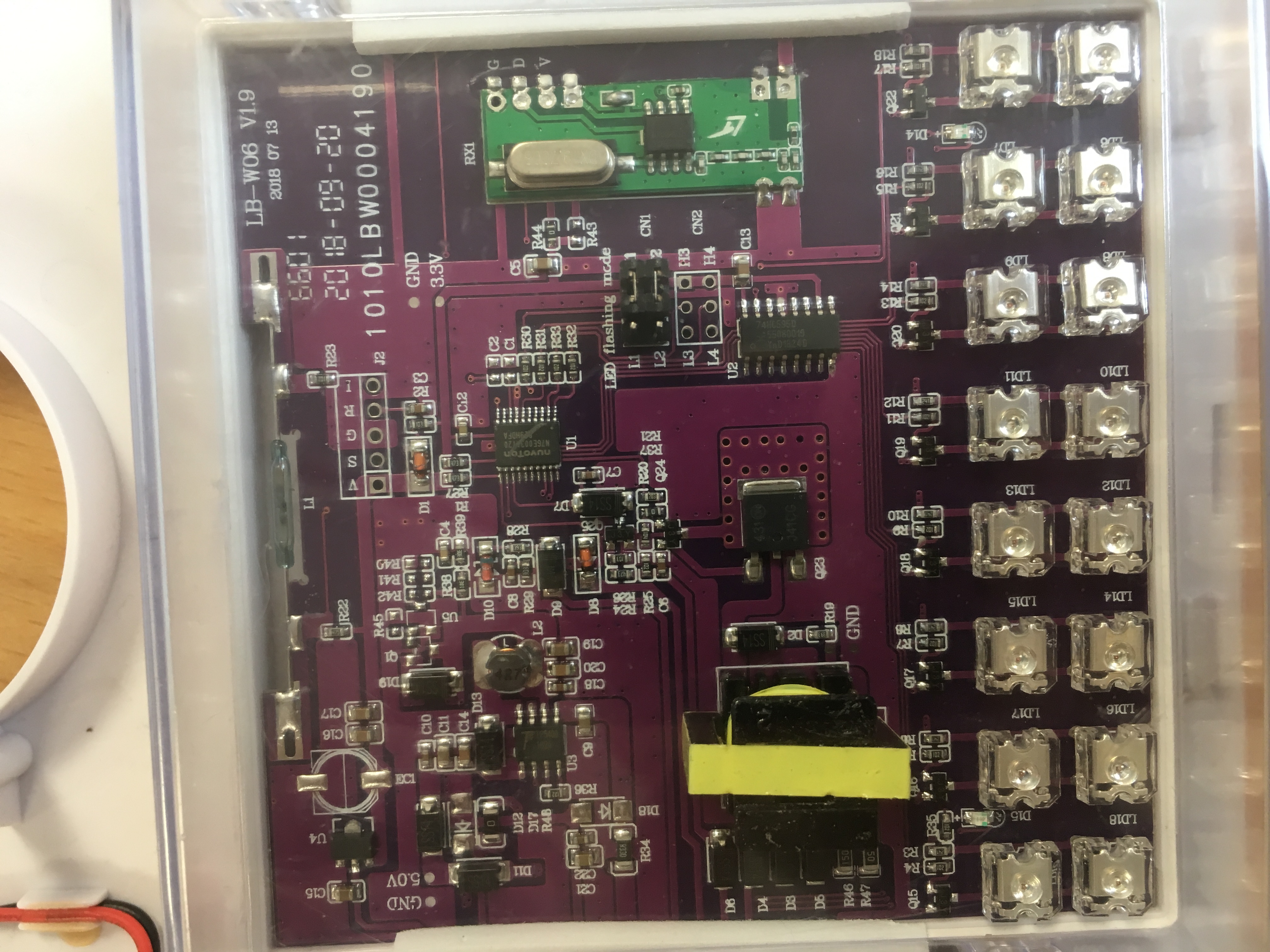

                  back at it !
                  I got my LCD microscope out and tried to reverse-engineer the original board. I should have done that to start with.
                  I drew that circuit on www.falstad.com (this link takes you to my actual circuit) and got several kV out of the simulation lol.
                  I used the original transformer: i could only measure resistance, so 5,5ohms on primary side, and 195ohms on secondary.
                  First transistor hooked to wave generator is J3Y. I replaced it with a BC547 (the "copy-paste" engineer hidden inside my head told me it's fairly close lol).
                  Second transistor is labeled J41CG and seems pretty strong to me so i replaced it with TIP120 .
                  Next I put all these components onto the breadboard, and load my favourite Nano with this sketch :
                  const int buzzerPin = 9;
                  int i = 0;
                  unsigned long duration = 1000;
                    pinMode(buzzerPin, OUTPUT);
                  void   loop() {
                    for (i = 1000; i < 5000; i++) {
                      tone(buzzerPin, i, duration);
                    for (i = 5000; i > 1000; i--) {
                  That is ever so LOUD !!
                  So this is plenty good enough for my little project !
                  next step

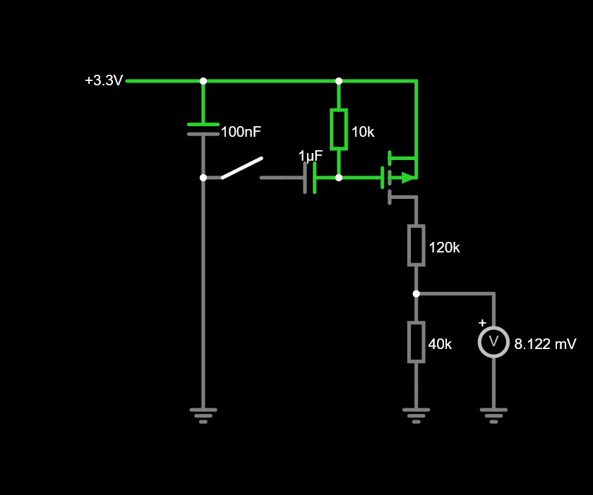

                      #29
                      Next step is to measure battery voltage on a daily basis.
                      Current setup is as follow:
                      • Pro Mini 8MHz 3.3V (regulator removed)
                      • Single cell LiPo (4.2V)
                      • Solar panel (unknown specs)
                      • Solar charger/boost to 5.0V based on 4056 chip
                      My reference for this part of the project is this post :
                      @Anticimex said in New library to read Arduino VCC supply level without resistors for battery powered sensor nodes that do not use a voltage regulator but connect directly to the batteries ;-)
                      I would like to activate the voltage divider on demand, via a transistor (NDP6020P as per previous link) as to not draw voltage 24/7 on a permanent divider.
                      I am also considering using AVR's internal 1.1V reference to measure the voltage.
                      Simulation gives this: link to falstad
                      As one looks at the "live" simulation one can notice that the transistor leaks a bit... a few mV.. that's the bit that worries me.
                      Is this a flaw from the calculation or does a transistor leak anyway ?
                      Thanks a lot for your suggestions !

                        #30
                        Just curious, still learning. Would a mosfet not draw less power? You could use a Mosfet and use a diode instead of a resistor to pull it high or low. That way it consumes micro amps.
                        ben999B 1 Reply Last reply

                          • TheoLT
                            TheoLT
                            TheoL
                            #32
                            Can't give you a 100% answer. I've noticed with FETS I sometimes have a low leak Voltage. But I've seen Chinese designs that gave a negative voltage when the FET was turned off haha
