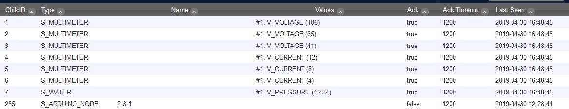

    Hi guys i building a multi sensor node , but i have one problem with a water pressure it keeps giving me a weather pressure , any one know what im doing wrong
    #define MY_NODE_ID 1
    #define CHILD_ID_VOLT_1 1
    #define CHILD_ID_VOLT_2 2
    #define CHILD_ID_VOLT_3 3
    #define CHILD_ID_CURRENT_1 4
    #define CHILD_ID_CURRENT_2 5
    #define CHILD_ID_CURRENT_3 6
    #define CHILD_ID_PRESION 7
    #define VOLT_SENSOR_ANALOG_PIN_1 0
    #define VOLT_SENSOR_ANALOG_PIN_2 1
    #define VOLT_SENSOR_ANALOG_PIN_3 2
    #define CURRENT_SENSOR_ANALOG_PIN_1 3
    #define CURRENT_SENSOR_ANALOG_PIN_2 4
    #define CURRENT_SENSOR_ANALOG_PIN_3 5
    #define PressPin      A6
    unsigned long SLEEP_TIME = 20000; // Sleep time between reads (in milliseconds)
    MyMessage msg(CHILD_ID_VOLT_1, V_VOLTAGE);
    MyMessage msg2(CHILD_ID_VOLT_2, V_VOLTAGE);
    MyMessage msg3(CHILD_ID_VOLT_3, V_VOLTAGE);
    MyMessage msg4(CHILD_ID_CURRENT_1, V_CURRENT);
    MyMessage msg5(CHILD_ID_CURRENT_2, V_CURRENT);
    MyMessage msg6(CHILD_ID_CURRENT_3, V_CURRENT);
    MyMessage pressureMsg(CHILD_ID_PRESION, V_PRESSURE);

    int pressure = 0;
    float PSI = 0;
    float PSI_CAL = 2.0;            // Calibration of sensor
    int PSImsb = 0;
    int PSIr = 0;
    void before() {
      sendSketchInfo("Pozo multi sensor", "1.0");  // Send the sketch version information to the gateway and Controller
      present(CHILD_ID_VOLT_1, S_MULTIMETER);   // Register this device as power sensor
      present(CHILD_ID_VOLT_2, S_MULTIMETER);   // Register this device as power sensor
      present(CHILD_ID_VOLT_3, S_MULTIMETER);   // Register this device as power sensor
      present(CHILD_ID_CURRENT_1, S_MULTIMETER);   // Register this device as power sensor
      present(CHILD_ID_CURRENT_2, S_MULTIMETER);   // Register this device as power sensor
      present(CHILD_ID_CURRENT_3, S_MULTIMETER);   // Register this device as power sensor
      present(CHILD_ID_PRESION, S_WATER);   // Register this device as power sensor
      int Voltaje1 = analogRead(A0);
      int Voltaje2 = analogRead(A1);
      int Voltaje3 = analogRead(A2);
      int Corriente1 = analogRead(A3);

        pressure  = analogRead    (PressPin) ;        // junk read
        wait(25);
    /* • Output: 0.5V – 4.5V linear voltage output. 0 psi outputs 0.5V, 50 psi outputs 2.5V, 100 psi outputs 4.5V
        0   psi = .33v after scalling 5.0v to 3.3v
        50  psi = 1.65v
        100 psi = 2.97v
        3.3v/1024 = .0032266 volt per bit
        if (pressure < 106) pressure = 106;         // this is minimum of .5v
        PSI = (pressure - 106 ) * .1246;            // where did we get this?? was .119904
        PSI = PSI + PSI_CAL;                        // adjustment
        PSImsb = PSI * 100;
        PSIr = PSImsb % 100;
        send(pressureMsg.set(PSI, 2));            // Send water pressure to gateway
        Serial.print("Presion: ");
        Serial.println(PSI);
        wait(200);
         // end of if (SLEEP_MODE || (cu
      sleep(SLEEP_TIME);
    any help will be very appreciated

      @fernando-alvarez-buylla S_WATER is a Volume or Flow subset from memory.
      I've not yet got round to installing pressure sensors on the pumped supply, but had already settled on tracking numeric values of hydraulic pressure such as Bar or Metres typical of physical pressure meters, so V_DISTANCE and S_DISTANCE seem more appropriate and might be worth a try your end.

        @fernando-alvarez-buylla said in questioun using multiple sensors on domoticz:
        S_WATER
        Here you will see that with S_WATER you should use another V-TYPE:
        https://www.mysensors.org/download/serial_api_20

          @alowhum Always been curious how Domoticz treats the V and S values, so tended to follow the MySensor API and had a few if unexpected moments and results along the way.
          You implied that presentation of V_PRESSURE pre-determines an expectation of S_BARO irrespective of whatever further S_? statement follows.
          Is this understanding correct?
