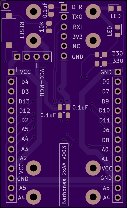

    Here are the pin labels for the V001 barebones board for mounting on headers. The document I prepared for this wouldn't upload, but had nice lefthand/righthand orientations. This made it easier than having to open the CAD file everytime I needed to make connections.
    But here is what I did in MS Word:
    Turn on grid set spacing to 0.1"
    Turn on ruler
    Copy the below text
    Align to the right or left as you wish
    Font Calibri 5.5
    Verify spacing (14 pins = 1.4")
    Print
    I also made columns and multiple copies of the below with both alignments. I have two boards built. Maybe you have more. Hope it helps.

      #239
      @Larson alt text
      L 1 Reply Last reply
      • NeverDieN NeverDie
        @Larson alt text
        L Offline
        L Offline
        Larson
        #240
        @NeverDie Yea, I think I knew you upversioned the silkscreen. I think I remember you commenting on it. Looks pretty. BUT in my effort to add to the community, since I typed it for my self for my V001 boards, I thought I'd share it incase there is anybody like me with V001.
        I like the V003 upgrades, specially that reset bypass via as discussed with @alphaHotel . Maybe I'll try it. I've got so much into my little V001's (yours actually) that I just can't give-em up. When I get the boards rigged up with radios, GPS (on the USART bus) and SD Card reader (on the SPI bus with a different CS), I'll shoot and send a picture in the spirit of a party!

                #244
                @NeverDie I have noticed that in the latest version of your adapter you have lowered the capacitor value used for the first stage filtering from 100uF to 10uF, leaving the second stage one to 0.1uF. Did you have empirical benefit in tests with this configuration? 0.1uF it seems to me at first glance too small to accommodate current draw fluctuation of this module. Would be appreciated if you explain your design choice. Thank you.
                NeverDieN 1 Reply Last reply
                • SMH17S SMH17
                  NeverDieN Offline
                  NeverDieN Offline
                  #245
                  @SMH17 said in Anyone using/tried the E28-2G4M27S 2.4Ghz LoRa SX1280 27dB module?:
                  The 10uF isn't for filtering. It's just to prevent voltage droop at the radio when the radio starts to pull current. So, yes, testing reveals that it seems adequate for that purpose. I originally slotted in 100uF because I wasn't sure, and overkill is better than underkill. It's possible that 10uF may also be overkill....
