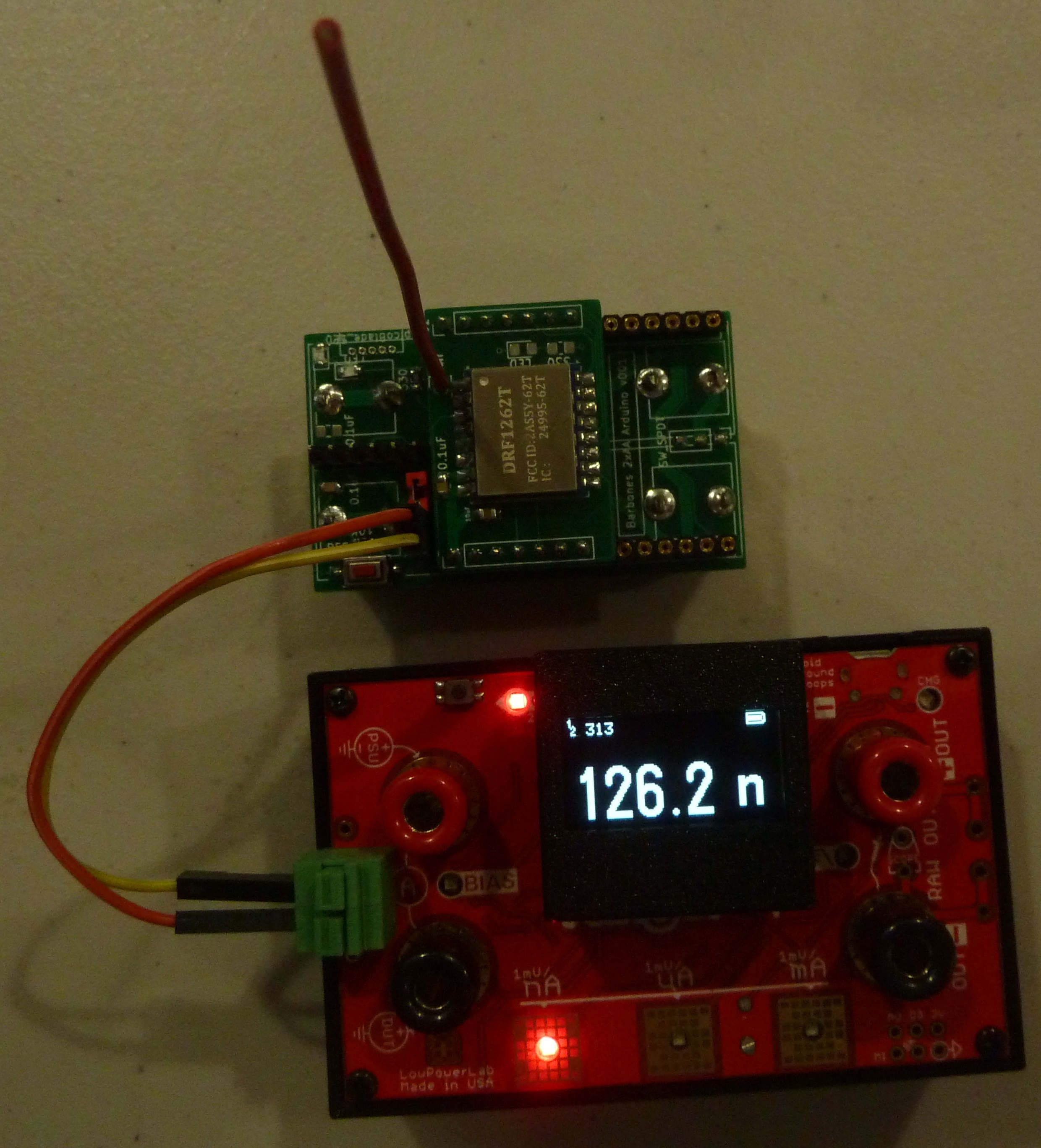

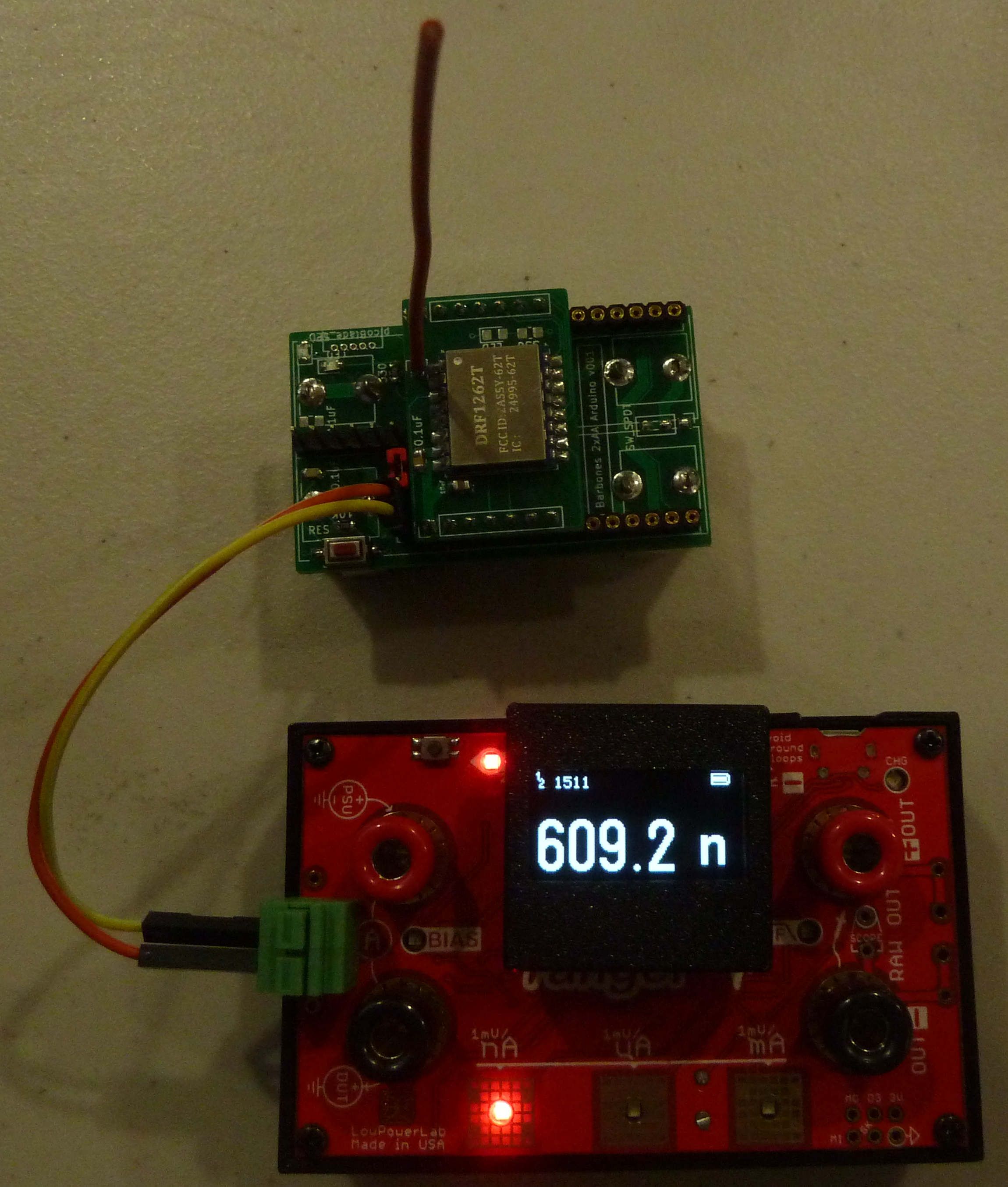

  • Hero Member
    The library's default sleep mode for the SX1262 radio should consume 600na with the configuration retained. Measuring it when powered by 2xAA batteries, I can confirm that it does:
    On the other hand, if it were put in deepest sleep, where it forgets everything, the datasheet says it would instead consumed 160na (see 3.5.1. Power Consumption table in the datasheet). Well, when I put it into deepest sleep, I measured a number reasonably close to 160na:
    Lastly, we know from the atmega328p datasheet that in the atmega328p's deepest sleep, it will consume only 100na. Well, doing that and measuring, I get a number reasonably close to that:
    I only just yesterday received this particular nanocurrent meter, and these were my very first mesurements with it. πŸ™‚
    The last thing to measure will be the amount of energy consumed by the SX1262 during a wake up. We should then have all the data we need to calculate the mote's estimated battery life.

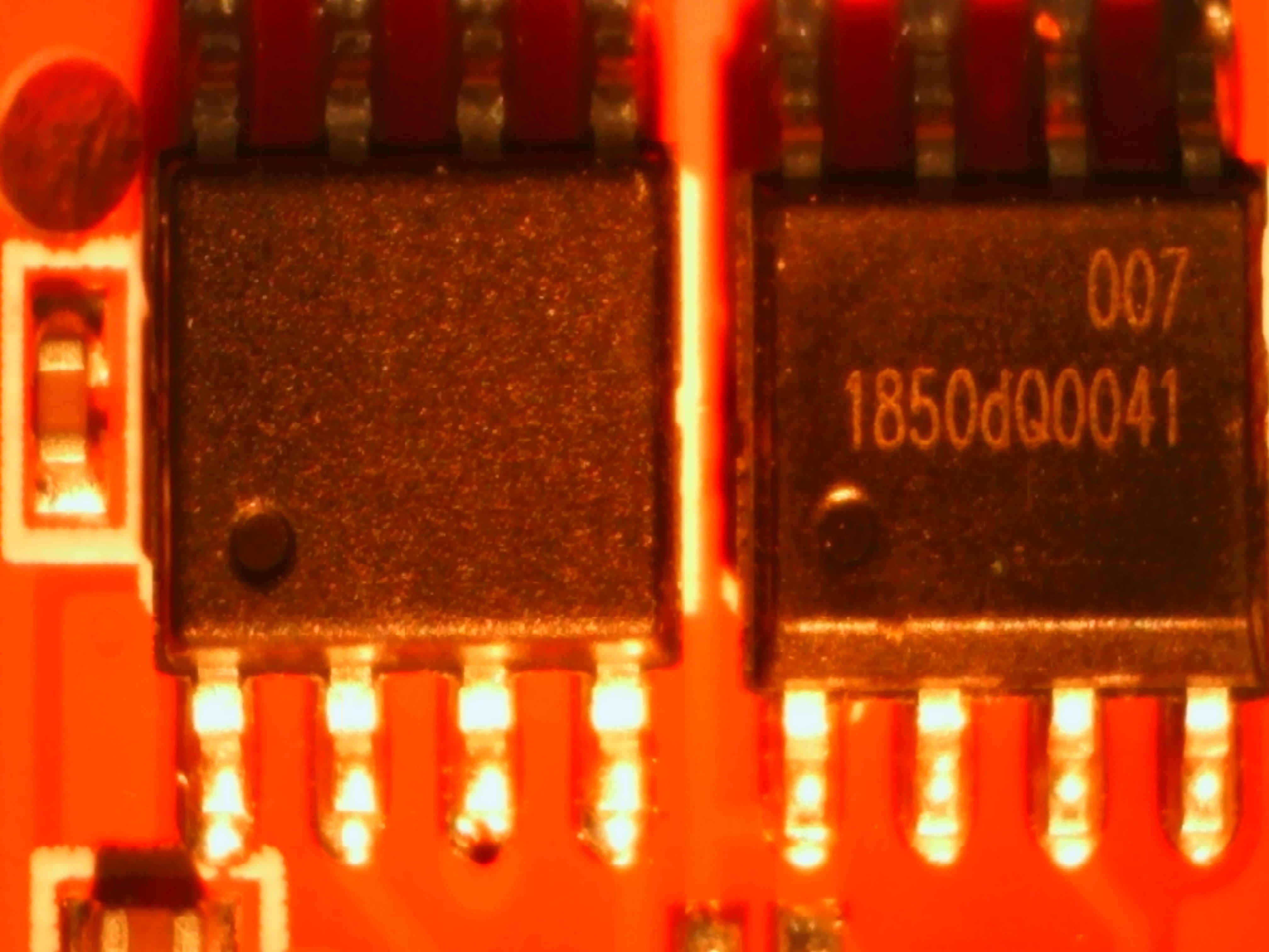

    Looking at the chips involved:
    only one has markings on it:
    and that seems to return a null google result. So, it's a deadend in terms of modifying the receiver duty cycle.
    Maybe there are chips with actual datasheets for doing this kind of thing? The application is certainly nothing new.

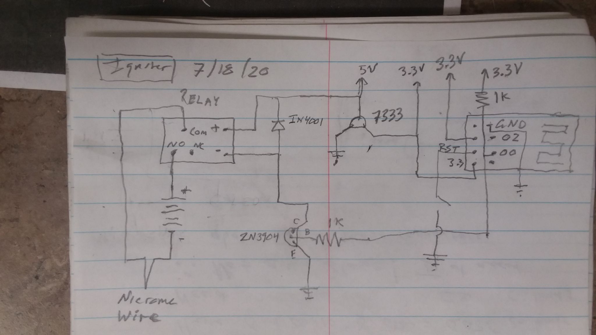

  • @NeverDie said in Most reliable "best" radio:
    What kind of device/component do you use to make the yelp sound?
    My present "Yelp" design comes from a Thingspeak script that sends an email. Yelp may have been the wrong word, but I was thinking of smoke detectors that beep to say, "I'm dying, replace my battery". Previously, I built a WiFi mouse trap that sent email/text/phonecall via SMTP2GO if the trap was tripped (mouse, or no mouse). That was fun! That code could easily be modified to trigger on a voltage threshold, or any other variable.
    8eb77c79-9a5e-47aa-9d04-64e6c23d01e5-image.png image url)
  • Hero Member
    @Larson That's a nice, clean looking, elegant design. If you have any idea on how to kill skunks, let me know. They are destroying my lawn. Live capture doesn't seem practical for skunks, for obvious reasons. I've seen one youtube that demonstrates a deadfall device--and proves it works--but it's the only example I've managed to find. There do exist professional services, but they charge a couple hundred bucks per animal removed, but after removal they can't legally release them (because they are officially pests), so the pro's just end up killing them anyway.

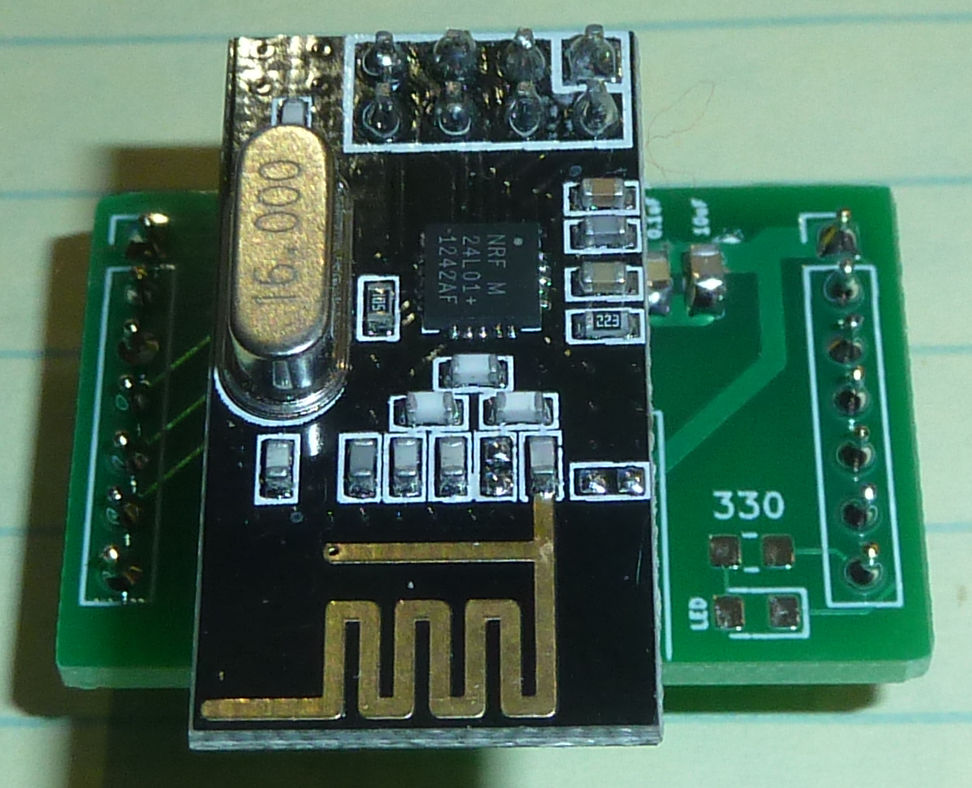

    As a first pass I tried running the RadiolLlb on these two 20dBm nRF24L01's with the default settings:
    and although they work fine at closer ranges, they delivered zero packets (i.e. total fail) along my worst-case transmission path. Make of that what you will. I'll see if I can possibly tweak some settings for a better result and then re-test, but those are the early results. I thought them worth testing because many people here like the nRF24L01 radios and because those radios do have good support for over-the-air updates on the atmega328p.
    To be fair, there do exist some nRF24L01 modules on Aliexpress with even higher transmission power, so maybe a pair of those would cut the mustard.
    I purchased them on amazon, mainly because I could receive them a lot faster than ordering something from China: https://www.amazon.com/dp/B07QC1SXJ8?psc=1&ref=ppx_yo2ov_dt_b_product_details
    [Edit: same results even if I reduce the datarate to 250kbps. ]
    Well, too bad. They do work for short range. Although this isn't rigorous testing by any means, I'm concluding that long-range for the nRF24L01, or other impairments, is essentially out of consideration Its niche is short-range, and for non-amplified versions preferably line-of-sight short-range. Sorry if that seems harsh, but for a comparison of different radio modules, somebody has to call it--and that's how I'm calling it. If somebody has a better nRF24L01 module that they feel would test better, please make a post and let us know what it is.
  • Hero Member
    Surprise! I'm getting it the nRF24L01 modules to send and receive, even along my worst-case transmission path, though for some reason ack's aren't being received along that worst-case path. Not sure why there would be an asymetry like that. Apparently the RadioLib library didn't default to full transmission power, because when I set transmit power to 0dB (which gets amplified by the PA), I'm now getting great radio communication. And this is the 2.4Ghz band, no less. Who would have thought? I'm flabbergasted. If anyone wants to replicate, I've posted my modified RadioLib sketches to source-code tab of the openhardware.io project for the nRF24L01 adapter.
    Even if I increase the datarate to 1mbps, the majority of the packets are still getting through. This may turn out to be a closer horserace than I had originally thought: it may yet require some careful measruements to separate out the winner.
    [Edit: As a result, I just now ordered some of these E01-2G4M27D: https://www.aliexpress.com/item/3256801616913450.html?spm=a2g0o.order_list.0.0.24f21802jP9dtI
    presently on sale for $4.34 each with free shipping, which allegedly contain TCXO's and, hopefully, should be a further step-up in performance. In fact, these may be the top-end of what's currently available on the market in the nRF24L01 series.
    Now the long wait for them to arrive....]

  • Hero Member
    @Larson What good luck: looks as though the pinout is an exact match for the pinout on my nRF24L01 adapter board for the test platform:
    Makes me wonder what those two through-holes are for near the antenna?
    Looks as though they are meant for something. Anybody know what those two through-holes are for?
    On ESP8266's, I wondered if the PCB antenna could be cut with a dremel tool and be fitted with an equivalent whip-wire. It would be cheap enough to try. It looks to be that the NRF24's are maybe making that easier? Again, cheap enough to try.

    @Larson said in Most reliable "best" radio:
    No need to guess. It's been done already. Here's one of the mods:
    Cheap DIY NRF24L01 Antenna Modification – 02:48
    β€” Pete B
    This one looks even better: https://www.instructables.com/Enhanced-NRF24L01/
    I haven't tried either one, but I do believe them when they say it helps improve range a lot.
    Very interesting. Based on the measurements the author, Pete B, shows, the on-board antenna length is 33.3% the 1/4 Lambda WL. He adds 66.7% for a total 1/4 Lambda. I'll say the same thing is probably true for the ESP8266 antennae lengths. I'm looking forward to trying this with the ESP.
    [Edit: My mistake. I looked at this further. The full 2.4GH WL is 4.92". So, the onboard measured 1.64" WL is a 1/3 WL. The additional 3.28" would bring the total WL to 1.0 * WL. Several simple RSSI tests would show the results. Frist test would be no change for a base case. Then test with the addition. Then one could cut the wire back to 3/4 WL, 1/2 WL, 1/4 WL, then finally remove the antenna to verify the original test, or to inspect for circuit damage.]
