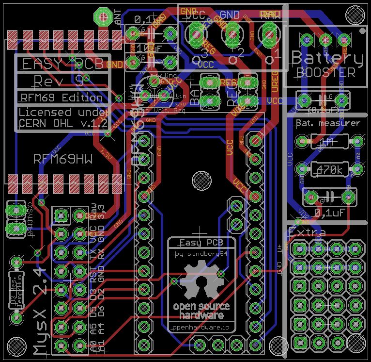

    #137
    @dbemowsk - thank you for pointing this out!
    Rev 8 is MysX 1.X and one of the reasons I upgraded to Rev 9 is because MysX 2.X came out. The pins are a bit changed but much better in MysX 2.X. For more details can study the changes.txt as well in the project.
    I will add this to Q&A for EasyPCB so other users dont miss it!
    Thanks again!

      Hi All,
      I have a lot of these PCBs in Rev.9 running as battery powered sensors. Also some with regulated power. They are running currentl with a NRF24L01. But i need to use on some sensors a RFM69 868 Radio. I have few breakout boards to use a RFM69 on a NRF24L01 connector. Is it possilbe just to replace the Radios on my EasyPBCs NRF to use RFM69 Radios? Think from power perspective should this be working. Well I know I have to Change also the Radio type in the Sketch. But is there anything more to do? Like cabling or specific Settings in the Sketch?
      Many Thanks
      Markus
      korttomaK gohanG 2 Replies Last reply
      • M Markus.
        Hi All,
        Many Thanks
        Markus
        korttomaK Offline
        korttomaK Offline
        korttoma
        #139
        @Markus. Keep in mind that the RFM69 radio pins are not 5V tolerable so use them only with 3.3V Pro mini. And like you said change the radio type in sketch.
        • Tomas
        M 1 Reply Last reply
        • korttomaK korttoma
          M Offline
          M Offline
          Markus.
          wrote on last edited by Markus.
          #140
          @korttoma yes i use the pro mini 3,3V but can Ireplace the Radios simply with a modification of the Sketch ? Because hen I Flash following Sketch to the Easy pcb:

          I get following result:
          Listening at 868 Mhz...
          SPI Flash MEM not found (is chip soldered?)...
          RFM69_ATC Enabled (Auto Transmission Control)
          • M Markus.

            #141
            @Markus.
            I am using these and they work https://www.mysensors.org/hardware/nrf2rfm69
              @Markus.
              M Offline
              M Offline
              Markus.
              #142
              @gohan its eactly the adaptor board which i try to use at the Moment.
              But I am not sure If the test Sketch can work. Because the pin Definition could be different to get it working on the Easy PCB with RFM69 ?!
                wrote on last edited by gohan
                #143
                No, I only changed the define from nrf24 to rfm69 and that was it. The capacitor I left the one on the EASYPCB near the nrf24 connector (a 10uF ceramic)
                  M Offline
                  M Offline
                  Markus.
                  #144
                  @gohan Sounds good :-) well, I have a 10uF electrolytic there. Hope it makes not the big difference. On the boards with NRF works that fine so far.
                    #145
                    I used the ceramic becuse I had a bunch of those :D

                      @sundberg84: Received the V9 boards and started to work with them. Converting my nodes into smaller ones ;-)
                      I want to use it with my 5v arduino. So need voltage regulator for the radio. I guess you are using LE33 if I read the thread correctly. I have LM1117 which seems to be a hassle to fix on the board with the 'rough bulky' legs. Suggestions or just buy LE33 ;-)
                      dbemowskD 1 Reply Last reply
                        #147
                        if you have MCP1700 you can still fit those

                          #148
                          @sincze When I first got my rev8 boards a long time ago I had the same issue. I did manage to bend the leads and solder some extensions on one to get it to work, but in the end it was just too much of a pain in the arse. I ended up buying L78L33ACZ regulators which work just fine, but the board was designed using the LE33. The LE33 is an LDO regulator where the L78L33 is not. The quiscent current of the L78L33 regulator, which is something I forgot to look at when I bought them, is 6mA where the LE33 maxes out at 3mA, which is much better when building battery operated nodes.
                          sinczeS 1 Reply Last reply
                          • sundberg84S Offline
                            sundberg84S Offline
                            #149
                            As mentioned above, it works but you need to watch for the right pins... you might have to be careful bending those pins but I think its managable... My suggestion though is to look for volt. regulators with the same pinout.

                                It still will be a tough one getting everyting attached to the pins. ->. 2x Door Sensor / 3x Dallas DS18B20 / 3x Relais / 2x Control LEDS TX/RX. A well part of the game. Already figured out I have to use the A0x pins as digital ones. As i don't plan to use IRQ I'm really hopeful this nicely designed PCB will offer me A0,A1A4,A5 D2,D3,D5,D6. So should fit ;-)
                                dbemowskD Offline
                                dbemowskD Offline
                                #151
                                @sincze With that much going on, you may want to connect a set of header pins to the outputs next to the nRF24 radio and run that to an external proto-board for connecting all of your devices. You won't make it on the small proto section of the newbie board for everything you want to add.
                                • dbemowskD dbemowsk
                                  sundberg84S Offline
                                  sundberg84S Offline
                                  #152
                                  @dbemowsk @sincze - its a good idea with a proto board or you can build something and add as an shield on the MysX connector... I would also suggest you run a seperate power regulator for the sensors... atleast do some calculactions before adding them in because LE33 can handle maximum of 0.2A i think.
                                  sinczeS dbemowskD 2 Replies Last reply
                                  • sundberg84S sundberg84
                                    sinczeS Offline
                                    sinczeS Offline
                                    sincze
                                    MySensors Evangelist
                                    #153
                                    @sundberg84 Ok tnx for the heads up. Currently I have everything in DEMO up and running on a NANO on my desk (using the exact same pins as I would on your PCB.
                                    I was thinking of the following. Power the PCB with 5v and use a 5v arduino mini, use the LE33 to power the Antenna with 3,3v. Hopefully this will enable the pins Mys pins A0 ...Dx with 5v.(Have to look at the schematic to be sure). Keeping your advise in mind to add some extra juice I have to power the RELAIS & Temp sensor separately with 5v and keep the grounds of everything together with the PCB. I think it should work. But maybe I am missing something.
                                    • sinczeS sincze
                                      sundberg84S Offline
                                      sundberg84S Offline
                                      #154
                                      @sincze all you can do is test and learn !!
                                        dbemowskD Offline
                                        dbemowskD Offline
                                        #155
                                        @sundberg84 Couldn't think of the name of the MysX connector when I did that post, but that's what I was talking about putting the header on to connect to the proto-board. Mainly to act as a proto-shield. I would agree to run the sensors from a separate regulator. If he plugs it into the MysX connector he should have access to RAW power if he jumpers the pads next to the MysX connector, and then he may be able to make use of at least one of his LM1117 regulators on his shield, provided that he runs the sensors from 3.3V. I am assuming that his LM1117's are 3.3V regulators and not the 5V versions.
                                          sinczeS Offline
                                          sinczeS Offline
                                          sincze
                                          #156
                                          @dbemowsk Got in stock 2 types of LM1117 the 3,3v and 5v. In any case the relais need 5v, the temp sensor as well. So If I read RAW in your answer that triggers me to watch out. ;-) I'll start soldering some pins and measure the voltage. as @sundberg84 said.. "all you can do is test and learn !! hehehe. Part of the Mysensors fun. And ofcourse this forum provides me with experienced feedback.
