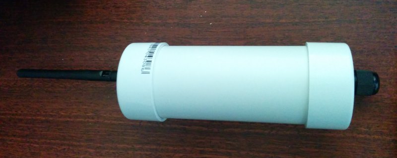

    I have found it hard to get good inexpensive outdoor cases that will endure the conditions for a long time. As I hope to deploy several outdoor nodes I wanted a case that would be as set and forget as possible without costing too much. I have decided to try and make my own so will see how this first one goes.
    From the local hardware store I have purchased a length of 50mm pvc tubing and end caps to suit. I have cut the tube to suit the PCB of the lightning detector . I will then fit a waterproof cable gland to an end-cap and glue the end-cap to the bottom of the 50mm tube. I will leave the top as just push on with no glue and mount an aerial socket on there as well. The whole thing will be secured to a timber post with a 50mm clamp
    Early days on this one, I will post more as it progresses.

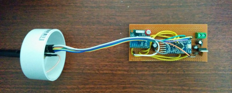

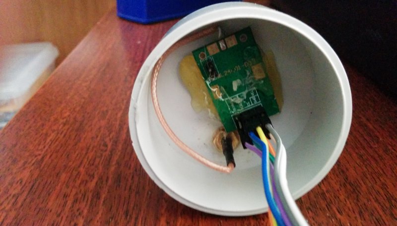

      I have progressed a little further with this project an am nearly ready to install this one outside. I have changed the sketch to be MySensors V2 compliant and also added an extra mosfet to control a second set of garden lights as well. I remembered the garden lights run on 12v AC so had to include a rectifier in the circuit as well. Seems to run on the bench ok, but of course no storms to check the lightning . Will upload the new sketch and wiring soon.
      Antennae Mounted on lid. I am using a shielded nrf24l01+pa+lna module to increase the range. tests I have done with this one seem to be promising.
      The main board with two mosfets
      A good fit in the tube.

            Just an update on this project. It took a while but we finally entered the storm season a couple of months back. This allowed me to get some real world data at last which has led to a few changes to this project. Firstly I have moved the Lightning sensor to its own housing with no other sensors/actuators. The reason for this is I would occasionally get false lightning strikes when the switches were operated.
            I have also made a few changes to the sketch. I now use the dust sensor for both distance and intensity readings, this gives a better display in Domoticz and of course I no longer needed the code for the switches etc. This code is working on MySensors V2.1.1
            I have mounted it all on a new board and have fitted it to one of my tube cases. These cases by the way are working out great for outside housings. I have a few scattered around the yard now and they have all performed well through our wet season, no signs of water in them at all and very easy to get at the arduino if i need to.
            I hot glued the NRF to the lid
            And then it all just slips into the tube
            I am still using i2c for the interface. It has been interesting watching the readouts as storms approach.
