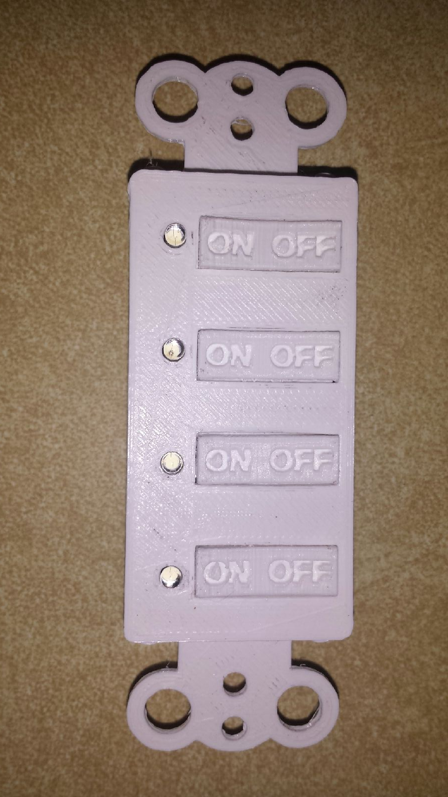

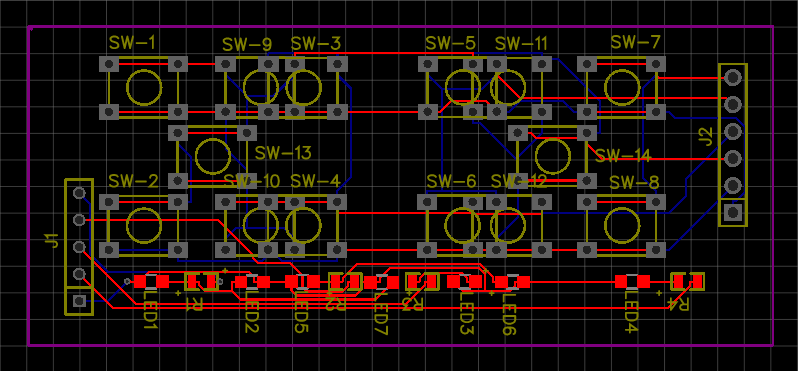

    So I am trying to design a wall switch that will work similar to the older 4 (8) button X10 XPT switches that I have in some places in my house. For those that don't know what these switches are like, here is a pic.
    alt textalt text
    I have also seen other switches out there that have an LED next to to each button such as in the second pic. Much like the XPT switches, the buttons on these will just transmit back to the MySensors gateway or possibly directly to another relay or dimmer node.
    Design:
    So here are my thoughts on how the design of the switch would be. The faceplate would be made from a decora style blank such as one of these:alt text
    The design would be something like this:
    I am thinking that this could be laser engraved onto the decora blank. The switches would be laid out like this on the top pcb so as to have a switch under each engraved tab:
    I tested a couple switches on a protoboard and when the board sits on the back of the blank plate, the caps of the buttons gently rest on the back of the wall plate. The laser engraved areas on the front should flex just enough to hit the buttons underneath. The LEDs next to each row will just be a simple on/off status LED.
    Wiring:
    The wiring should fit for all of the components if my calculation is correct. Six data lines are needed for the switches (4 rows and 2 columns), and 4 lines for the status LEDs. After wiring the radio to the node there are data lines 3 through 8, and analog lines A0 through A3. The analog lines would be used for the LEDs as there are 4 of them. The 6 digital lines would be used for the push buttons. The wiring for the switch board would look something like this:
    The LEDs would be 1.8mm LEDs like these:
    1.8mm LEDs

    So far these are all just ideas. I am open to comments and criticisms on any thoughts or ideas that I have noted. Any ideas on where I can get some of the parts done at like the laser cutting and possibly a good PCB manufacturer, that would all help too. I haven't looked yet, but I am assuming that there is a matrix switch assembly sketch out there somewhere that I could use as an example.
    I will post more as this project moves on.

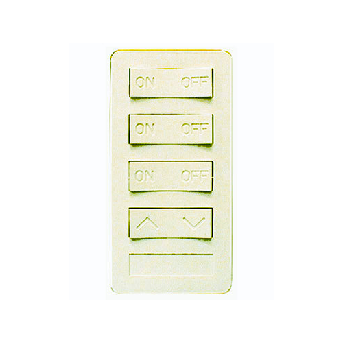

                      The switch design I have shown in the original post is based off of the 3 button on/off + dimming XPT switch from X10:
                      XPT 3 buttom plus dimming
                      I have a few of these in my house already. The dimming buttons operate dimming functions for the last on/off button pressed. So if you turn button 2 on and then use the dimming buttons, it will dim whatever device that corresponds to switch 2. You then turn on button 1. Dimming will then operate the device on button 1.

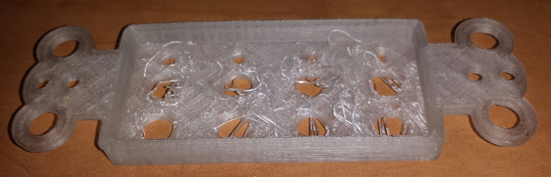

                        So I did some checking on getting the blank wall plates laser cut, but not having much luck. One local company said they couldn't do it, the other says that the plastic is polycarbonate and their equipment will not cut poly. One other thing I found when researching this is:
                        "Polycarbonate sheet can be cut with industrial cutting lasers however, edges may become amber or brown when laser cut and a clean edge is difficult to obtain. In fact, some laser cutters are not able to cut it because it ruins the lens and requires frequent stopping and cleaning. Please contact your equipment’s manufacture to see if your laser is able to cut polycarbonate and for recommendations on the process."
                        So I am now looking into having these possibly CNC cut. I'll post my findings on that.
                        C 1 Reply Last reply
                        • dbemowskD dbemowsk

                          @dbemowsk try searching for watercutting, you get very nice edges without burnt colouring, and cost wise its generally cheaper.

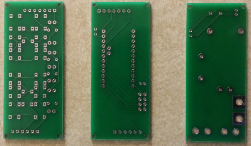

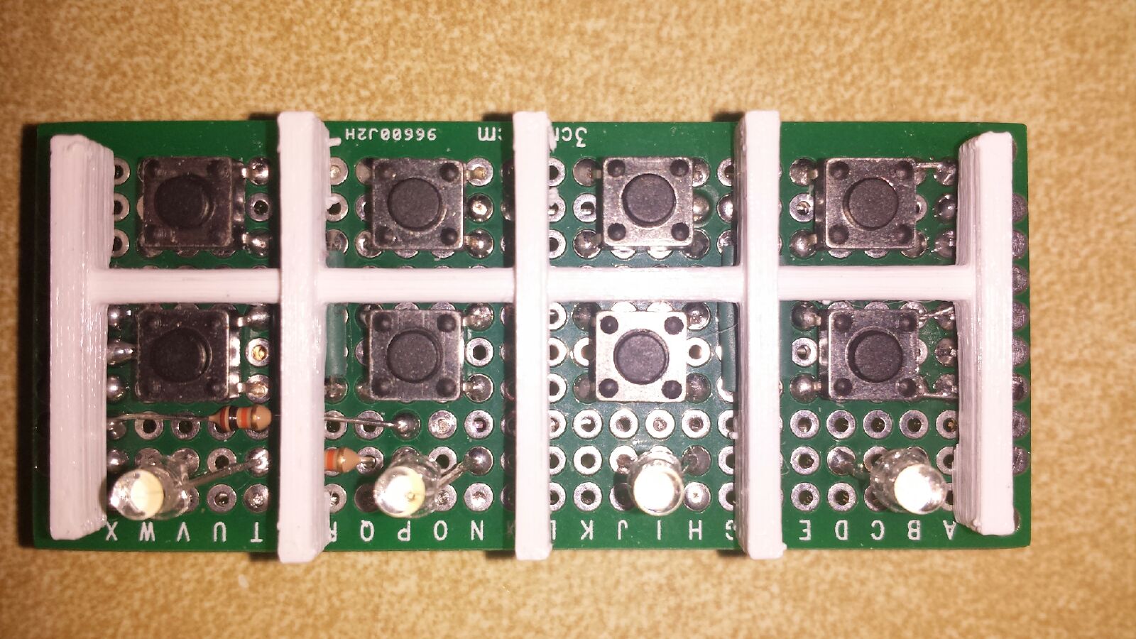

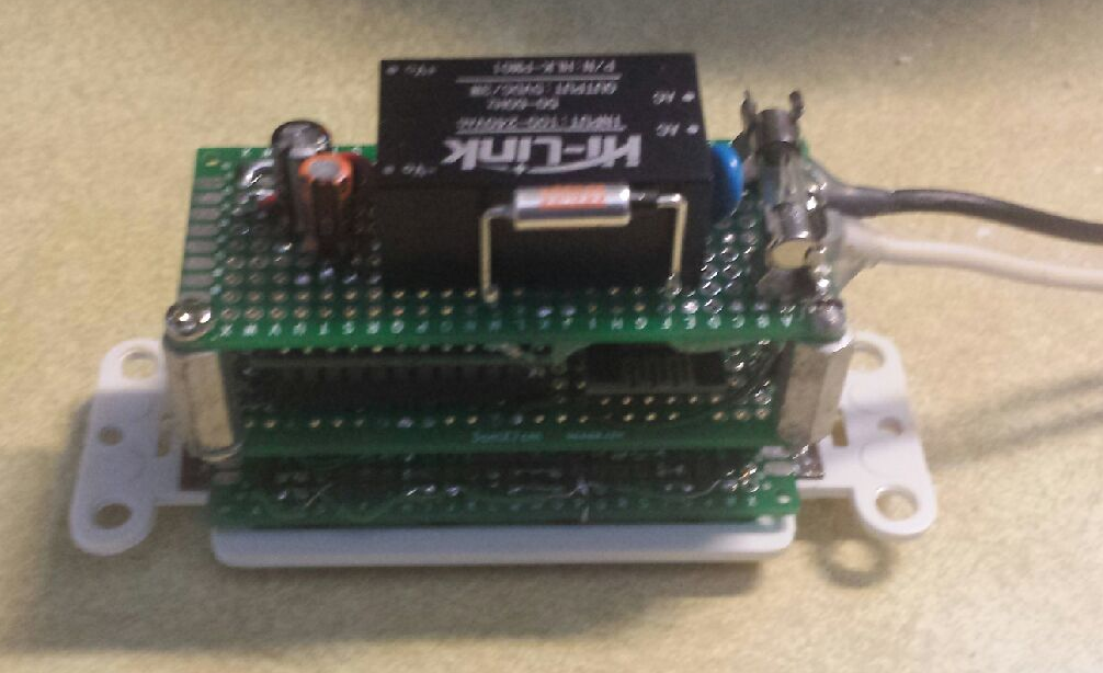

                            So I decided to work more on this old project I started a while back, and I finally have a prototype of the switch/LED board finished. It is far from pretty, but it is functional as far as I can tell with the tests I have done with my volt meter.
                            This is a picture of the switch board assembly opened up:
                            0_1484289186008_upload-c0cfa2b3-008a-4db7-b8a6-2150c3bebc2a
                            And here is 3 views of the switch board fully assembled:
                            0_1484289345130_upload-ea4958cf-8200-4ac2-a6db-2c20c807dc06
                            The idea I am working on is to layer the boards using the header connectors, making it modular. The next board would be the computer/MySensors board. It would be the same size as the switch board and stack with a set of female headers. This switch board would pretty much max out the pins on a pro mini. The switches would take 6 pins ( D3 - D8), and the LEDs would take 4 (A0 - A3). There would then be a third board stacked yet on top if these two which would be the power supply board. The power supply board would contain the HLK 5 volt power converter and a 3.3 volt regulator.
                            My issue now is to see if I can get everything to fit in the small amount of space with header connectors to stack the boards. I may have to get creative with the arduino/radio board and mount one on each side of the board. Wiring it will also be a challenge. Then I will have to see if it will fit in a standard wall box or if I will need a deep box
                            In the end, if I can get everything figured out, I could make a number of these and attach different switch boards for different configurations. I may even design a PCB for this, but if I do, that would be in the distant future.

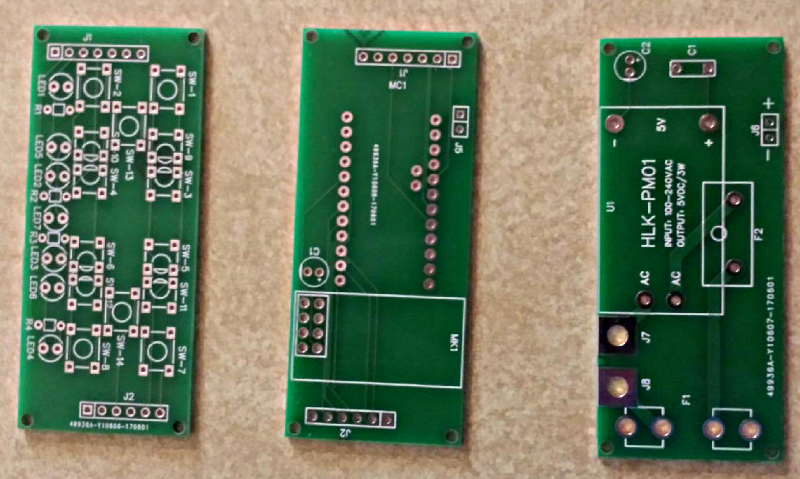

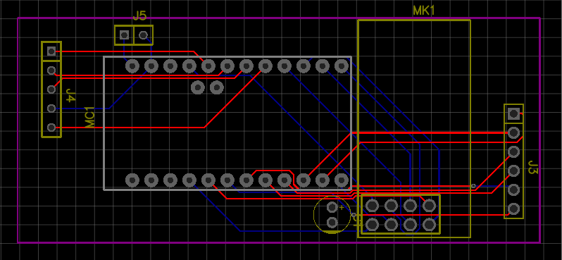

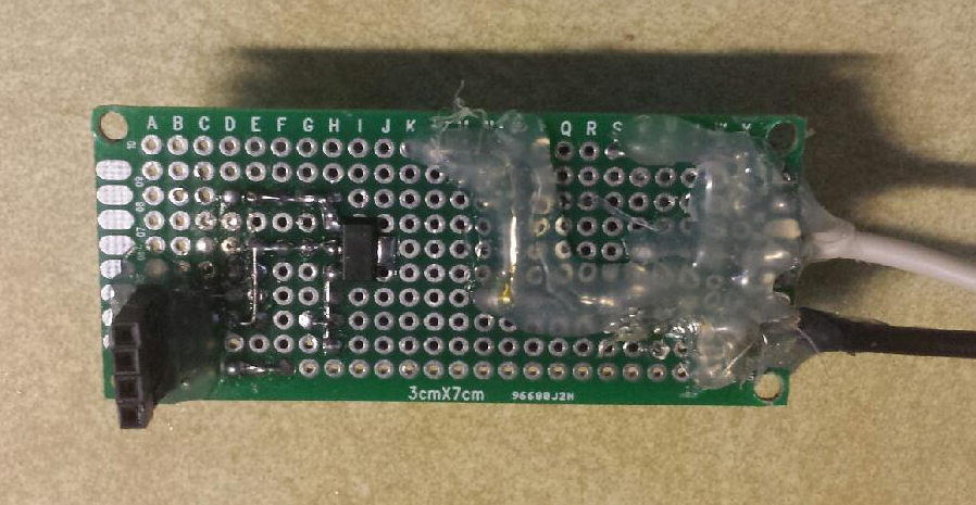

                              So here is my latest update. I now have the controller board made that the switch board will stack on to. It currently uses all analog and digital pins of the pro mini except pins A4, A5, A6 and A7 which are not in the standard header rows. This is the board as it is right now.
                              0_1484724472906_upload-0f59998c-25dc-47e2-b3ca-7213ae13c44d
                              And this is the controller board stacked with the switch board.
                              0_1484724556313_upload-284b133f-0a5a-4c24-bdc9-f4c133784b1f
                              I wrote a simple sketch to test the keypad which is just a 2x4 matrix. One thing that I realized that I forgot which I will fix in the next couple days is the current limiting resistors for the 4 LEDs.
                              For testing until I figure out the design of the power supply board, I am just powering this using the supply from my UNO as it has both the 3.3 and 5 volt outputs.
                              My plan for now is to use each row as an OFF and an ON button with a corresponding status LED, but the possibilities for this are much greater. This could be used as a controller for 8 individual scenes, bright/dim controls, or whatever you can think of. This could be used to talk directly to other nodes for lighting control or any number of things. You could build other switch boards for this that would maybe contain more switches (eliminating the LEDs of course), or any number of combinations of switches and sensors.
                              The final setup is going to be quite bulky and will need a deep US wall box to fit everything, and even that might be tight. For now this is a proof of concept design to test the feasibility of this as a controller. Eventually if things work out, I may seek help from the forum to create a dedicated PCB for this which could be stacked into a smaller package.
                              I welcome any thoughts, comments and feedback on this design.

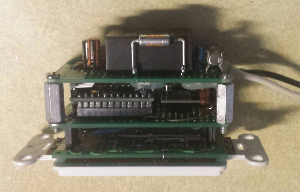

                                @dbemowsk
                                I'm currently working on the following PCB design for US Decora Wall Plate.
                                It's designed to have some components/ connections on the back, but most of the components on the front of the PCB.
                                It has provisions for connecting:
                                4 x Switch (A0, A1, A2, A3)
                                4 x LED (A4, A5, A6, A7)
                                4 x Relay/SSR (D5, D6, D7, D8 connected to NPN transistor)
                                2 x sensor (pin D3 and D4)
                                Designed for using an Arduino Pro Mini 5V with A4 to A7
                                I can share the gerbers once completed
                                PSU: https://www.aliexpress.com/item/220V-to-5V-2W-ac-dc-power-supply-width-voltage-input-85-264V-Smart-Home-AC/2036637836.html?spm=2114.13010608.0.0.TDfk9B
                                I'm also working on a Dual Decora style wall plate switch containing 4 x 8Amp SSR
                                dbemowskD 1 Reply Last reply

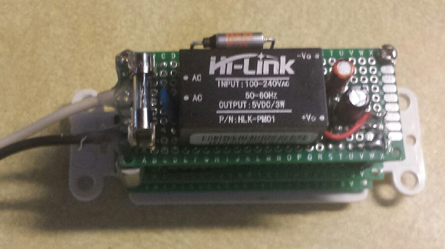

                                    @enterprised For my design, I am hoping to use an HLK-PM01 power supply. Comparing to the one you have listed it has a few advantages:
                                    • Enclosed components vs exposed components on yours
                                    • Continuous output current of 600mA vs 200mA on yours
                                    • 50mV or less of ripple on the output vs 100mA on yours
                                    Having the components sealed will protect more against short circuits on the high voltage side. As for the current, I probably wouldn't need 600mA, but using a supply that is rated a bit higher I figure will be less stress on the components and cut down on heat. Plus I have to do 3.3 volt regulation for the radio, so I figure I am covered for that too. And last, the better the ripple on the output, the less filtering that will be needed for a more stable radio.
                                    The other thing that I like about my design is that it is modular. You would be able to have a number of different switches, sensors or LEDs as the faceplate while having one arduino/radio board and one power supply board. As mentioned in one of my previous posts, the current design is a bit bulky, but with a better PCB design, I think I can compress the layers quite a bit more. Looking at your pics, yours looks like a nice design too.

                                        @dbemowsk
                                        Oops, attached the wrong link.
                                        I'm using the 400ma version of this PSU. The design uses 200ma max with 4 switches/LED's/SSR's, so plenty of overhead. I actually stepped away from the HLK-PM01 due to the very poor reliability of these modules, too many that failed within a few months.
                                        I use an LE33 in TO92 package to create and regulate the 3.3v for the radio
                                        The ripple is a non issue as I have 7 module of the previous design installed and working around the house.
                                        I'm enclosing the entire module with a hot vacuum formed custom enclosure, so the entire circuit is fully protected. Amazing what you can do with a sheet of plastic, some wood, vacuum cleaner and a oven.
                                        My design is also using multiple PCB's. There is a second PCB sitting on top containing 2 SSR's and related components
                                        This was my previous design using relays not SSR but all other components are the same.

                                          So for my latest update on this, I have finished the power supply board. One thing I learned in making this that I didn't even think of at first was that when I soldered on the thermal relay, the heat from the soldering was enough to blow the relay. Thus, my initial test did not work. I was finally able to get a fuse installed and working. I would have preferred it to be more centered on the side of the Hi-Link module, but I am thinking that it should still be effective.
                                          0_1485103640004_upload-1ea7b909-45be-45d6-8a6d-73c512594442
                                          On the bottom side of the board you can see the LM1117 3.3v regulator. For the high voltage side, I have hot glue over all traces for safety in testing.
                                          0_1485103278566_upload-fb75fd43-a5c5-4650-a9e1-91cbf7168f51
                                          I used a 22uf cap on the 5 volt output and a 10uf cap on the 3.3 volt output. I have also added hot glue to the incoming hot and neutral leads to provide some strain relief on the wire as it attaches to the board.

                                          The last thing I want to do is fabricate a plastic cover to put over everything that will fit into the wall box. I think I am going to need a deep wall box to house the connections and the module.
                                          I did connect this and have it paired with my Vera. Each row is OFF, ON and status LED to indicate the ON state. I have debated on having the LED on when the switch is off to give better visibility to the switch when it is dark. In Vera, I can tie the switches to devices using scenes.
                                          Overall, this proof of concept design is working well.
