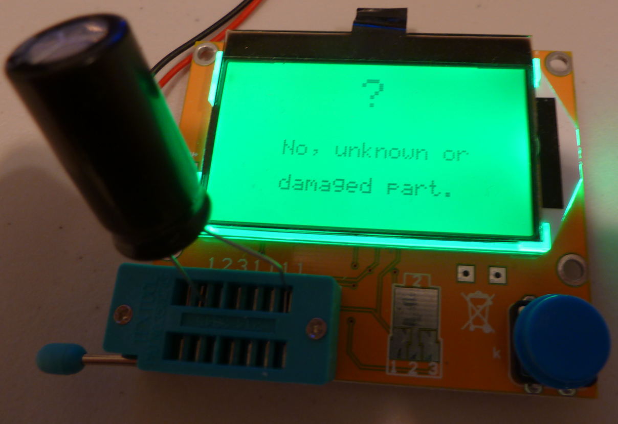

    Incredibly, I may have to resort to the Julien Ilett method of measuring capacitance. None of the meters or testers I've seen thus far handle supercapacitor capacitance (e.g. 10F). So, thanks for posting the video! Very timely.
    alexsh1A Offline
    alexsh1A Offline
    alexsh1
    #163
    @NeverDie the old fashioned way! ;-)
    Glad we are doing or reading about the same things at the same time.
    How long does it take for your device to measure ESR? Did you try a normal capacitor, I.e. 100uF?
    NeverDieN 1 Reply Last reply

      @alexsh1 said in How best to find the "best" small solar panel of a particular size?:
      Yes. About 5 seconds.
      [Edit: that includes the time it also takes to measure capacitance. It does both measurements (including part type identification) at the push of the button. ]
        #165
        Maybe it is just outside of the measurable range of the meter.

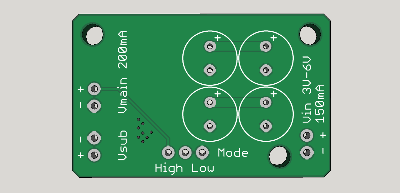

                            I went ahead and made the switch on the node that I'm experimenting with: I'm now using a LTC3235D 3.3v passthrough boost converter. I switch it on when the node wakes up, do various measurements, then switch it off before transmitting the results if the supercap voltage is above threshold. Everything working smoothly.
                            I think I may next try putting a buck converter on the solar panel so I can get more juice out of it when its voltage is above 3.3v. I'll be trying this one:
                            https://www.openhardware.io/view/276/33v-Buck-Boost-DC-DC-Converter
                            because it's the only one I have on hand. If it seems to help, then I'll look for something more on-point (and less expensive!).
                            alexsh1A Offline
                            alexsh1A Offline
                            alexsh1
                            #175
                            @NeverDie said in How best to find the "best" small solar panel of a particular size?:
                            How does LTC3235D compare to BQ25570?
                            BQ25570 has got buck converter with Vout from 3.3V down to 2V (Vbat is from 5.1 down to 2V), which is just enough to run nrf24l01+ with AVR.

                              @alexsh1
                              Well, I'm sure it's easier to solder than the BQ25570. I'm no longer really considering anything that's difficult to solder unless there's just absolutely no alternative.
                              It looks as though @ceech sells them though already soldered to a breakout board, so maybe he can answer your question.
