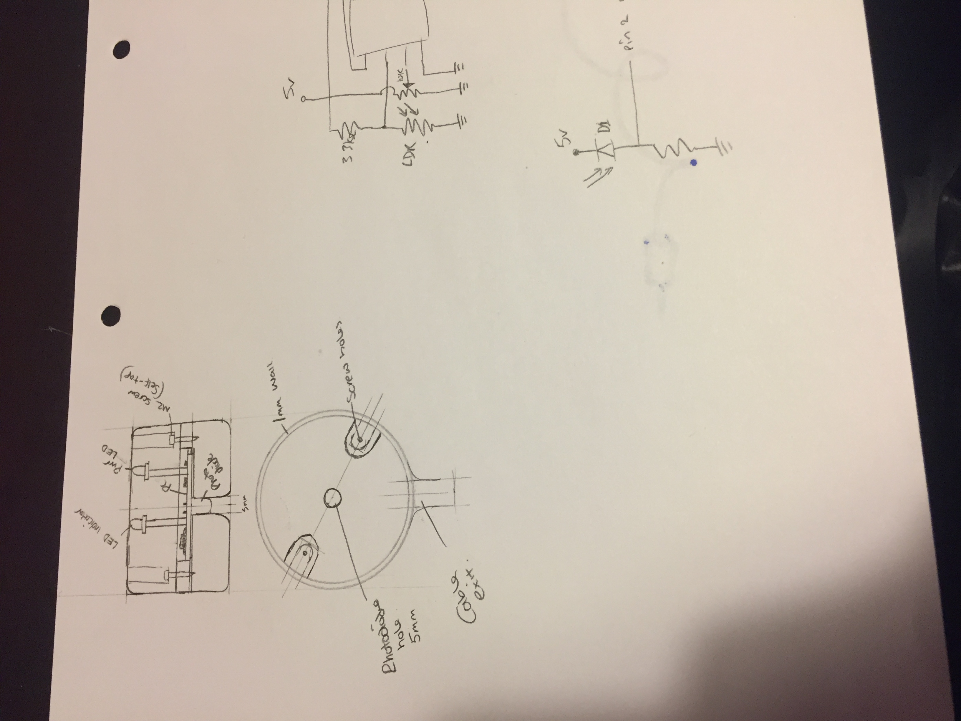

    @gohan I already have some designs in my head. I don't think this would be that hard to make from scratch to be honest. I'm aiming to make it look exactly like what we have been looking at with: https://shop.openenergymonitor.com/optical-utility-meter-led-pulse-sensor/
  • Hardware Contributor

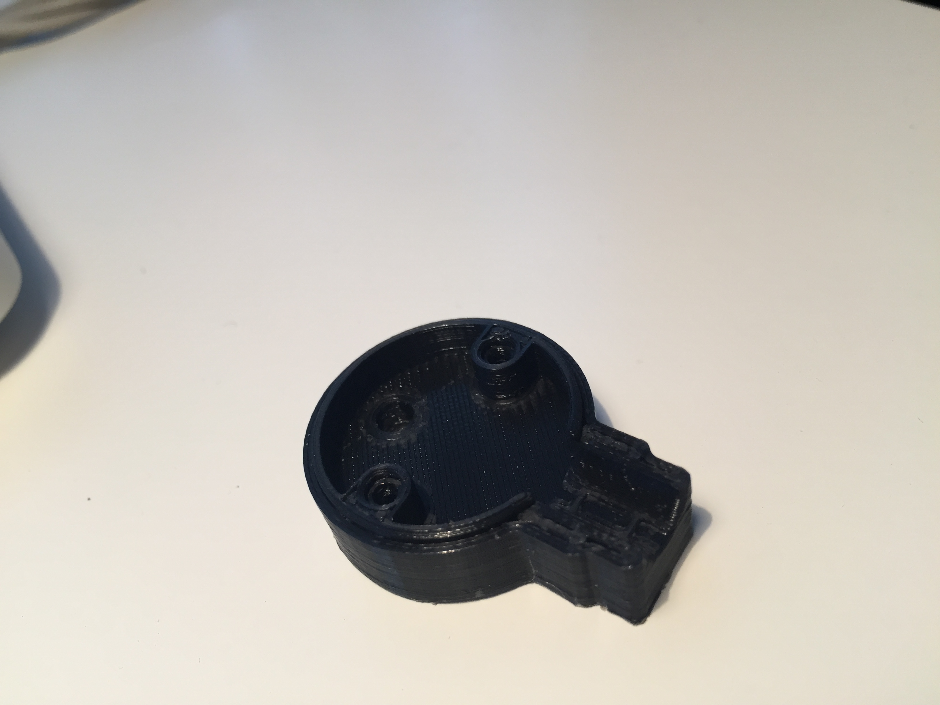

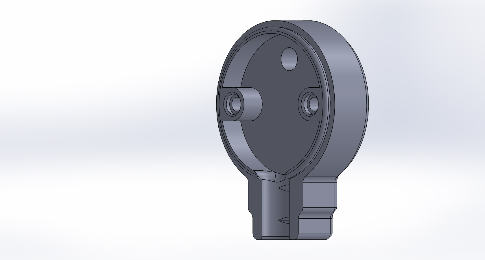

    too hard to resist, so first draft freshly printed
    @scalz - I hate being a student and having no time. Beat me to it! Do you have the circuitry sorted?
    What 3D modelling software do you use? Fusion, solidworks?
    Also, what size have you made that, what size PCB would it accept?
    From my initial bit of research, the product that we were talking about from OpenEnergyMonitor doesn't seem to be optimized for detecting a blinking LED. It works, but is not optimized for best result. If the pulse started becoming relatively quick for any reason then this would start to saturate and the LDR will not return to its normal status quick enough. I'm designing using a compactor and photodiode to get around this issue. Schematics are nearly done and will attempt to get this PCB small as possible for either my own 3d printable model to stick onto the meter or @scalz.
    Could you possibly share that model at all @scalz? Obviously, depending on what engine you have used to create this that is 🙂

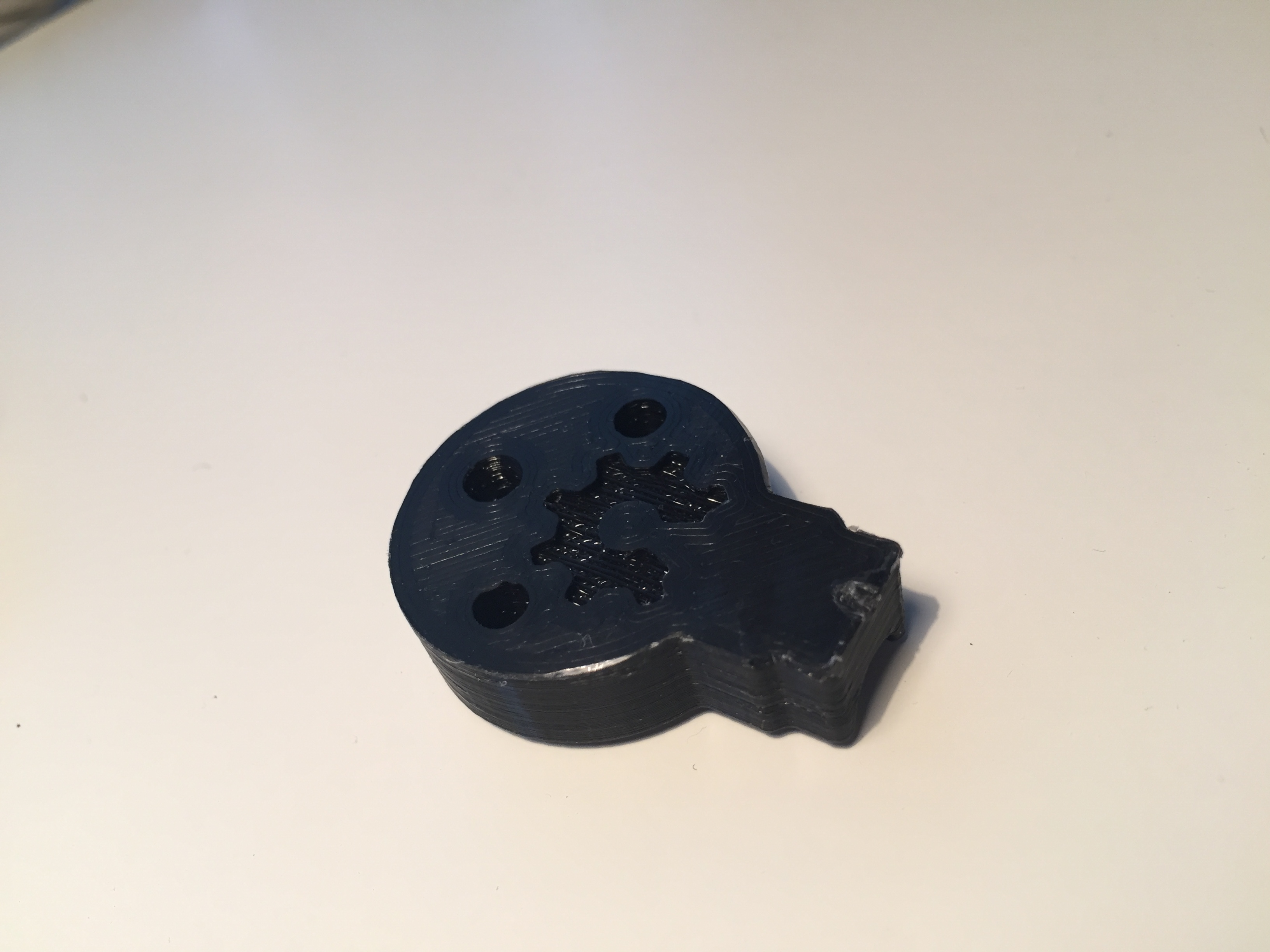

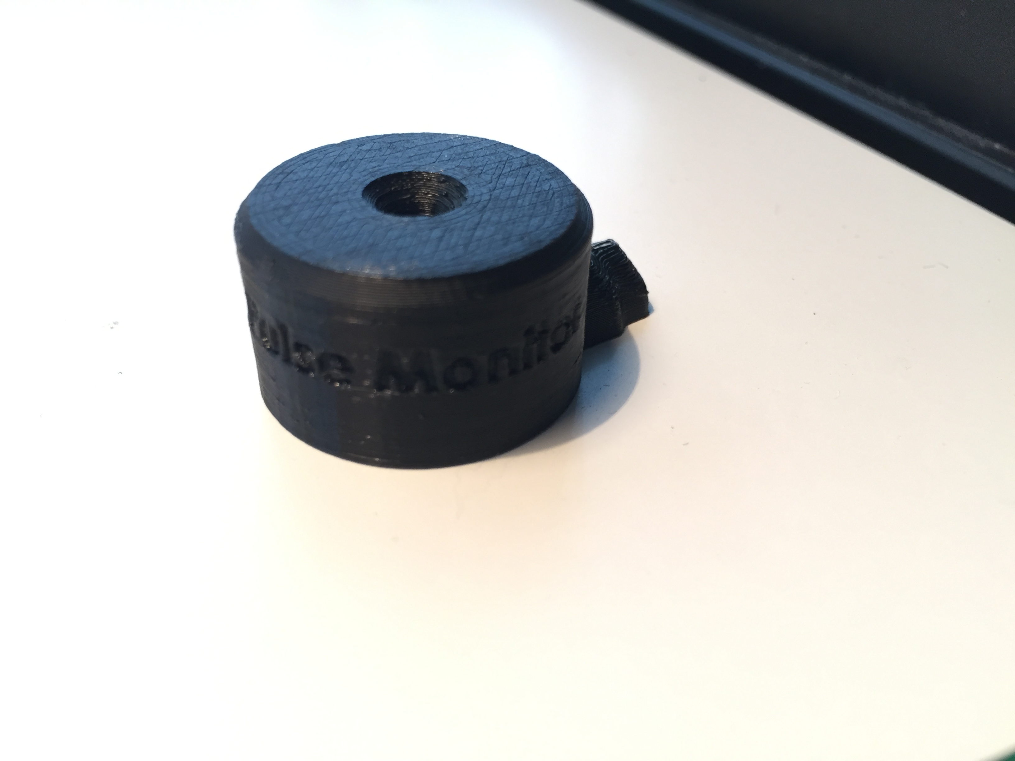

    Beep beep lol
    I'm joking. That was really quick to do. The box is same size 22mm. I'm not sure to see the point of making it smaller as it needs holding points.
    I've used solidworks.
    Yep I've done the pcb too. Ultra low power, a few parts. But I need to test the circuit (maybe at lunch) as I'm not planning to use comp nor amp. Again I did it because it was quick and because I can 🙂

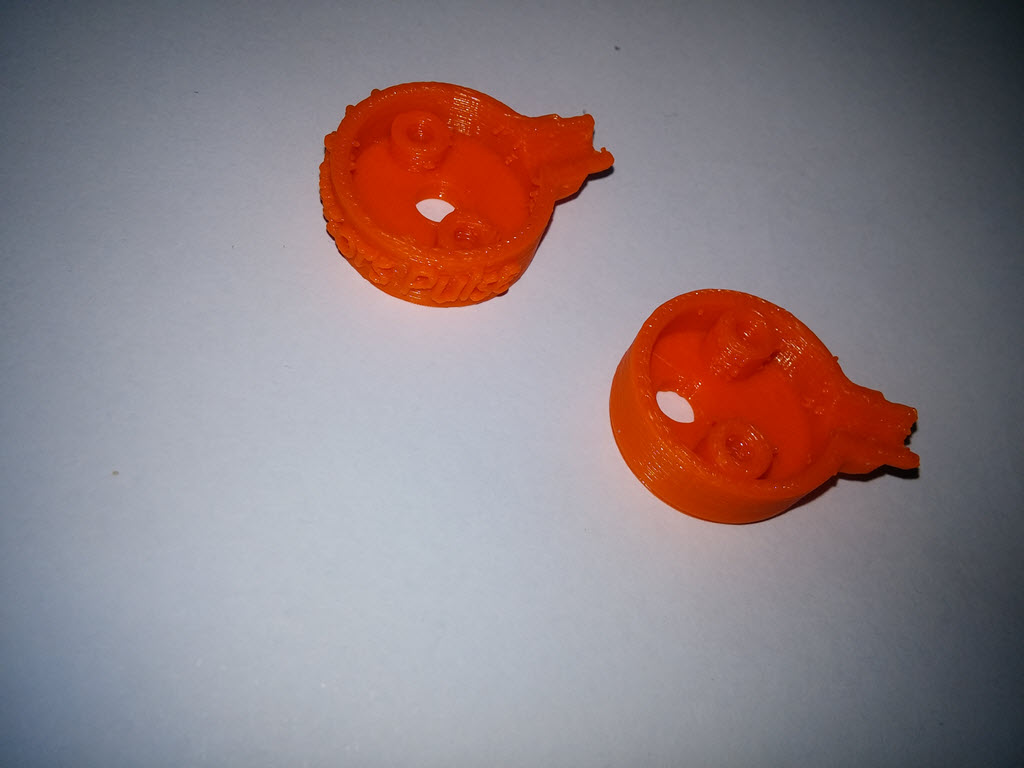

    It took me less an hour for the box+pcb..i wouldn't have invest more time as i've lot of others stuff to do.
    For the connector, I let the user choosing as I'm not really planning to design a dedicated pcb for the mcu side. Because there are already lot of boards and it just need one signal. Or I have multiple custom dev board with usb connection too etc. I was mainly interested in doing a low power sensor with a good digital level. Now I need to check my little idea..

    @scalz - Perfect, okay. Well i will sort something out with the MCU side in mine then. I might go down the route of custom board, but then again, it may be easier for the user to just use a arduino maybe, just that the connection of the sensor would be a little 'temp' if i don't do a custom board maybe. Not sure yet. Will get the sensor product sorted first.
  • Mod
    @Samuel235
    Sorry, I meant photodiode, I messed up the name. I am planning to use the module as shown in photos posted by sundberg

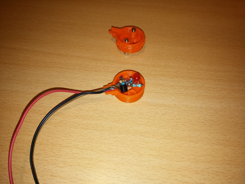

    assembled my sensor this noon.
    It looks like this from the top view, with the indication led (optional if battery powered device). The sensor is of course on bottom.
    So i just ran a few tests and was able to detect up to 40hz. Then missed pulses started. but i've not tweaked it yet.
    My test config was a signal generator connected to an external led, put it in front of my sensor. And checked the result with a scope.
    I think 40Hz should be enough lol, and was very suprised i was able to go as high with my circuit, that's cool.
    I'll upload my files at openhardware

    @Samuel235
    in fact i'm jealous of you too as you're studying electronics, looks cool 😉
    I've only designed the pcb for the moment, electronics in my thing is air wired, i don't remember how this soldering style is named??
    so this looks like this
    i'll check a few things for tomorrow, and also would like to try sensing a few others led colors and i'll post, no problem. I've been able to go up to 110hz though, then it was fluctuating too much (40hz was because i forgot to remove a capa on the signal generator side).

    So there is one, which should be very low power, afew uA (compared to the 0.4mA min of the lm393), and cheap. I just need to change a few routes, very quick.
    I told you 😉 (i'm kidding of course)

    I like it @scalz - you're approach is much better for low power modes, much better than mine. I see that the comparator is not needed for such application, i'm going that route because its the 'done' way. However, you're style is much better for battery powered nodes which will naturally attract people.
    I'm really struggling to get to grips with KiCAD and i'm starting to give up after just one footprint. This thing would have been hours ago if i just used eagle.
    The style is more 'inline' (not the technical term, but that is how i know it). What photodiode/resistor are you using? Most should pick up quite a decent range of wavelengths on the blinking LED.
    @scalz - The general photodiode has a range of "Wavelength range (S10%) 400 nm to 1100 nm (SFH
    213)", quoted from a datasheet here: http://www.osram-os.com/Graphics/XPic5/00101689_0.pdf. So this means that we should be good for a fair few different LED colours.
    Here are the renders for my enclosure, will be printing in the morning and will report back with some more progress photos.
    I did try to get the font into the same font as we use for the official logos of MySensors but the font really didn't correspond with solidworks, there are missing faces and lines all over the generated font and therefor it wasn't an option. If anyone knows a work around or something i could do to make it look remotely like the logo then please inform me. At some point i may attempt to put our little man logo on there instead of the opensource hardware logo, maybe.
    I have designed the cable inlet with ethernet cable in mind, that may change too, not sure yet. I'm going for the cheap and locking/latching RJ45 rather than something that could slip out of socket as most of us use our electric cupboards for other uses as well such as cloakrooms for coats and such in the UK.
    Would anyone like to see anything on here that i haven't thought about? I'm open to criticism.
    cool
    regarding your print, i think it's better to extrude the text, i'm not sure you'll get a good rendering like this..
    same thing for the logo.. i guess you'll print it facing to the bed, maybe that won't look so great too.
    @scalz - I'm not keen on the extruded text look tbh, i'm testing this format but my printer is pretty good with overhangs and thats why i'm taking my chance on the logo on top. It will be facing the bed and so we shall see how it turns out. Its not the end of the world if it doesn't look pretty straight away but i'm hoping its acceptable 🙂
    i know for the extruded text, me too though. but i think it's more in general, 3d printing, it is more readable. but you can try, sure it won't take so much time and maybe that'll work, can't wait to see how it looks now 😉
    @scalz - I'll print with 0.1mm layer height to give me the best chance possible. They're not meant to be obvious features, they're only small details, 0.5mm indents. So, Fingers crossed.
    I'm pretty impressed with how it handeling that overhang on the logo considering there wasn't much vertical space under it to the bed i expected it to droop down to the bed. I like it! Ignore the little cunk out at the cable entry part, my glue held it too hard on the bed. The cable grip is a little too small, reprinting it with a more pronounced grip now (Didn't want it too large as it would damage the cable, but its not enough at the moment).
    it didn't slice the text??
  • It looks good @Samuel235, having the detector recessed in a cavity in order to reduce the impact of ambient light isn't something that I had considered, I guess because I was mainly thinking about an off the shelf enclosure, or repurposing some other type of container, i.e. this, but I like these designs a lot better.
    This is the bottom @scalz, the previous post was of the top part.
    Yes, having the diode resessed was big importance in my eyes. Where do you live as if its not that bad we could print some for you and send to you if you wanted it after it was finished.
    I have a few little tweeks to do but i'm pretty pleased with how the details have turned out.
    Things to ammend:
    1. Change cable specs if i decide on using 4 core into a rj11 connector.
    2. Sort out screw holes as they need some more plastic inside to be more substantial to receive my self-tapping screws.
    3. Make walls slightly thicker to allow for another skin.

    @Samuel235 yep screw holes are a bit tight but it looks good 😉 I did a mini tunnel too on mine for isolating a bit the sensor, i think this can help, but not sure as it also increases the distance between the blinking led, but should work.
