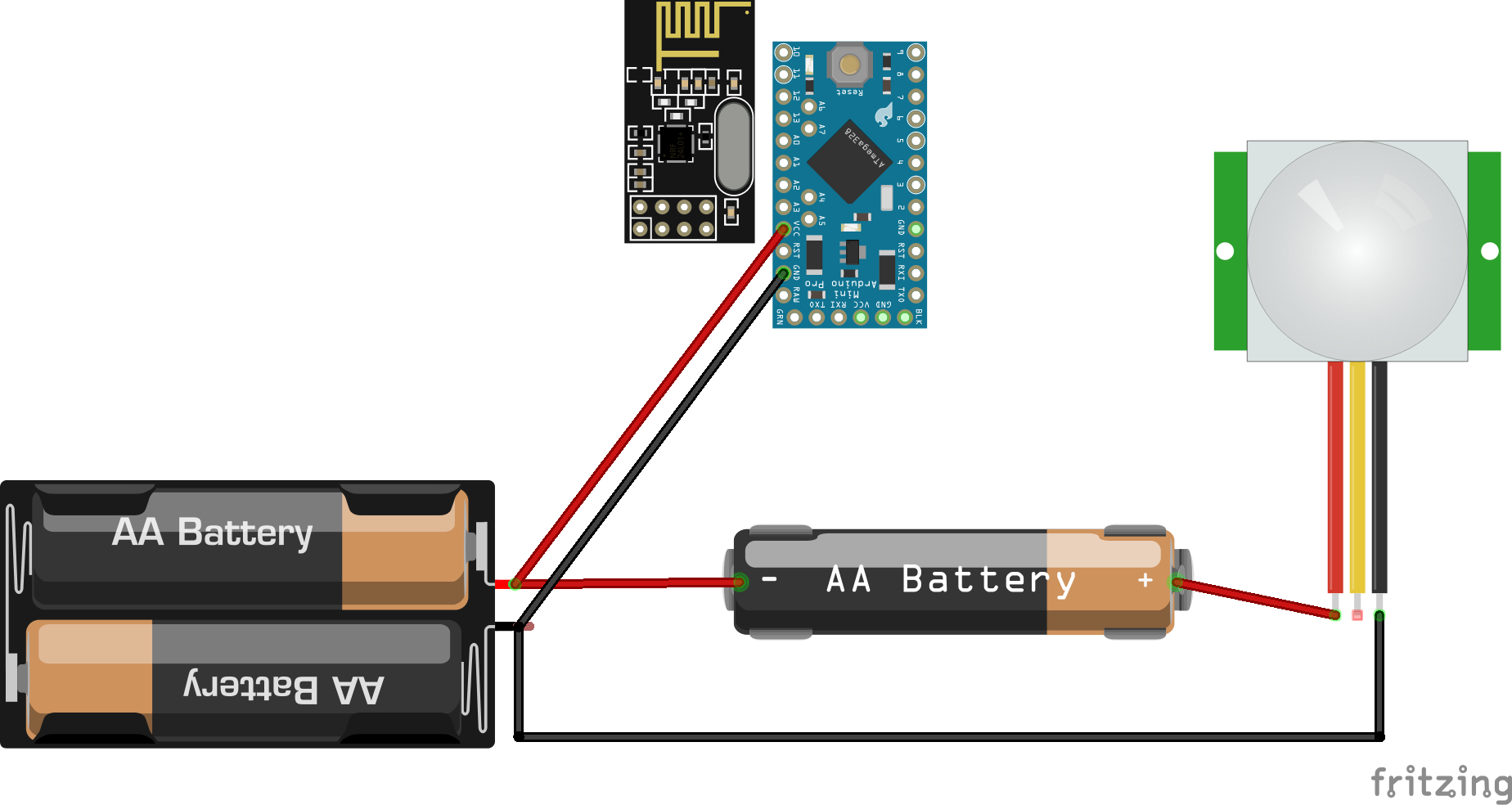

    Hi all,
    I've read a lot of posts about battery-powered motion/temp/humidity sensors.
    I'm new to electronics and programming, but I've already had sucess in setting everything up.
    Below is my wiring.
    ![0_1490045167603_pir-dht22-battery-sketch.PNG](Uploading 100%)
    I haven't modified the arduino pro mini 3.3V version for a battery optimizied use.
    The VCC is directly connected to the h-pad (wire soldered to h-pad) of the HC-SR501.
    The Temp/Humidity sensors is a DHT22.
    The node should do the following:
    If the arduino woke up from interrupt, then send only the tripped status of the motion sensor.
    if the arduino woke up from the sleep timer (1 min for testing), then send humidity, battery and temperature, but only if the values changed more than the treshold.
    Everything works well, the node sends humidity, battery and temperature when the sleep timer ended and does this only if it changed more than my defined threshold.
    The node also detects correctly that it woke up from interrupt and sends only the motion sensor value.
    The problem is that it looks like the radio triggers the motion sensors or something like that.
    Everytime when the motion sensor detects motion, it sends 2-3 tripped messages in a row, if I understood correctly, this means the arduino wakes up from the interrupt, then sends the message and goes back to sleep and then immediately wakes up and sends the message again, right?
    Also when the arduino wakes up from the sleep timer, it sends the temp/hum/battery values and sometimes, with random behaviour also the motion tripped value.
    Where is the problem? Wiring? Coding? I tried dozens of codes and always the same behaviour :(
    Below my sketch:

      I fixed your code tags you were a little happy with those :)
      How are you powering the node and sensor?

        Here is the wiring. Didn't work in the first post. It is all powered by two AA batteries.
          That's quite strange, have you tried a different sensor and radio?

            I had what I suspect to be the same issue a while back, and it took me ages to debug.
            I haven't looked at your code or reviewed the circuit diagrams in detail, but the symptoms sound spot-on, so I'm reasonably confident that this is what is going on.
            For backround, the HC-SR501 is a very sensitive trigger that sets up a delicate balance between the two sides of the IR receiver, and then waits for that to get out of balance (i.e. from one side getting more or less light). Once things are out of balance, the sensor trips and you get an interrupt. Woohoo!
            Now, the problem here is that even though we like to think of power and ground as "constant", in actuality any load that is not constant is going to raise or lower the power rail voltage a bit. And if you have a relatively "heavy" load (like an active radio and Arduino processor) that suddenly goes "off", the power rail is going to spike high for a brief time, since the batteries and regulators are all whirring along trying to supply that higher load. That voltage spike then rips through the HC-SR501 (which, as you recall is already spring-loaded looking for minute imbalances), and tips the scales, causing a trigger and what ends up looking like a motion event. The interrupt pin on the Arduino goes high (or low) and wakey-wakey!
            (Keep in mind that I don't have access to an o-scope, so a lot of this is from thought experiment, conjecture and fiddling with various elements, but I'm reasonably certain that's at least close to what's happening.)
            I also suspect that this is exacerbated by using a lower voltage (3.3V vs 5V), tying directly to the 3.3V pin on the HC-SR501 (bypassing extra voltage regulation), and using batteries as a power source (they've got their own inefficiencies as a voltage source).
            So anyway, all that being said, the way I worked around this on my devices was to "stagger" the sleep. First I would power down the radio, then wait "a bit" (100ms or so?) for power to stabilize, then do the actual sleep() call to put the Arduino to sleep.
            This was with MySensors 1.4, which I think made it a little easier to get at the internal radio to do a powerDown() call. But I think it's still possible to get at the raw radio. I just don't recall off the top of my head how to do with with MyS 2.x.
            Anyway... hopefully that saves you a lot of head scratching. Digital components are awesome as building blocks, but darn it if analog issues creep in sometimes...

              Yes, I've tried three different radios and two motion sensors, always the same behaviour.
                What's the size of the cap?
                • B Offline
                  B Offline
                  burningstone
                  @gohan
                  The capacitor is 47µf.
                  @rickmontana83
                  Do you happen to know where I could find this information?
                    If you have one, try a 100uF. Once I solved this way
                    • R Offline
                      R Offline
                      rickmontana83
                      @gohan I seem to remember trying that, and gave up when 470uF wasn't enough. :-) That being said, it's an easy enough thing to try.
                      @burningstone I'd search around the MySensors library code for the implementation of the sleep() routines. They'll need to call the radio shutdown somehow. Doing a quick drill-down, I see:
                      MySensorsCore.cpp defines the internal _sleep() routine, which ends up calling transportPowerDown() (to do the power-down of the radio in a hardware-independent way). This ends up calling into transportPowerDown() in MyTransportNRF24.cpp (for your radio type), which calls the RF24_powerDown() routine.
                      I would think that's probably the one you want to call.

                        @rickmontana83
                        Sorry, I don't understand what I have to do now.
                        Do I have change the sketch to:
                        RF24_powerDown();
                        wakeup=sleep(digitalPinToInterrupt(DIGITAL_INPUT_SENSOR), RISING, SLEEP_TIME);
                          If I am not mistaken, calling the sleep function already powers down radio
                          • B Offline
                            B Offline
                            burningstone
                            @gohan
                            Yes you are right, but I need to poweroff the radio and then wait some ms and then go into sleep interrupt if I understood @rickmontana83 correctly.
                            @rickmontana83
                            How can I call these functions from my sketch? Do I need to change the mysensor library files?

                                // Sleep until interrupt comes in on motion sensor. Send update every two minute.
                              YveauxY Offline
                              YveauxY Offline
                              @burningstone I didn't read the whole thread, but quickly scanning over it I understood you are powering the pir with 2xAA cells. If that's the case it is not going to work. The pir needs at least 3xAA cells to function correctly when you bypass its regulator.
                              • B Offline
                                B Offline
                                burningstone
                                @Yveaux
                                Could you please explain why this will not work?
                                Because the pir sensor detects motion perfectly fine, the only problem are the false triggers, which occur when the radio sends the signal to the gateway.
                                I also saw some guys that run the exact same pir and arduino pro mini 3.3V version on 2xAA batteries.
                                YveauxY 1 Reply Last reply
                                • B burningstone
                                  @Yveaux
                                  YveauxY Offline
                                  YveauxY Offline
                                  @burningstone the biss0001 chip on the pir is rated for 3..5V operation. If you use it outside its allowed range you can expect undefined behavior, e.g. false triggers.
                                  These sensors are very sensitive to power supply. Even with a good supply within spec behavior is sometimes strange, to say the least...
                                  • B Offline
                                    B Offline
                                    burningstone
                                    @Yveaux
                                    So what would you suggest? Adding a third AA-battery?
                                    I just can't understand why some people got this pir sensor working on 2 AA batteries and without false triggers.
                                    • B burningstone
                                      @Yveaux
                                      YveauxY Offline
                                      YveauxY Offline
                                      @burningstone pure luck? It's all about tolerances. Let's see if it still works for them once the environment temperature changes, the pir ages, the battery levels drop, the radio sends more data, etc, etc.
                                      A simple fix is to power the pir from 3xAA and the arduino and radio from only 2xAA.
                                      Search the forum, I've already explained it in another thread.
                                      • B Offline
                                        B Offline
                                        burningstone
                                        @Yveaux
                                        So i would need 5 batteries in total??
                                        Seems like overkill to me, and the sensor would become quite big :(
                                        • B burningstone
                                          @Yveaux
                                          YveauxY Offline
                                          YveauxY Offline
                                          @burningstone no, just 3xAA.
                                          Power the arduino and radio from the first 2 only.
