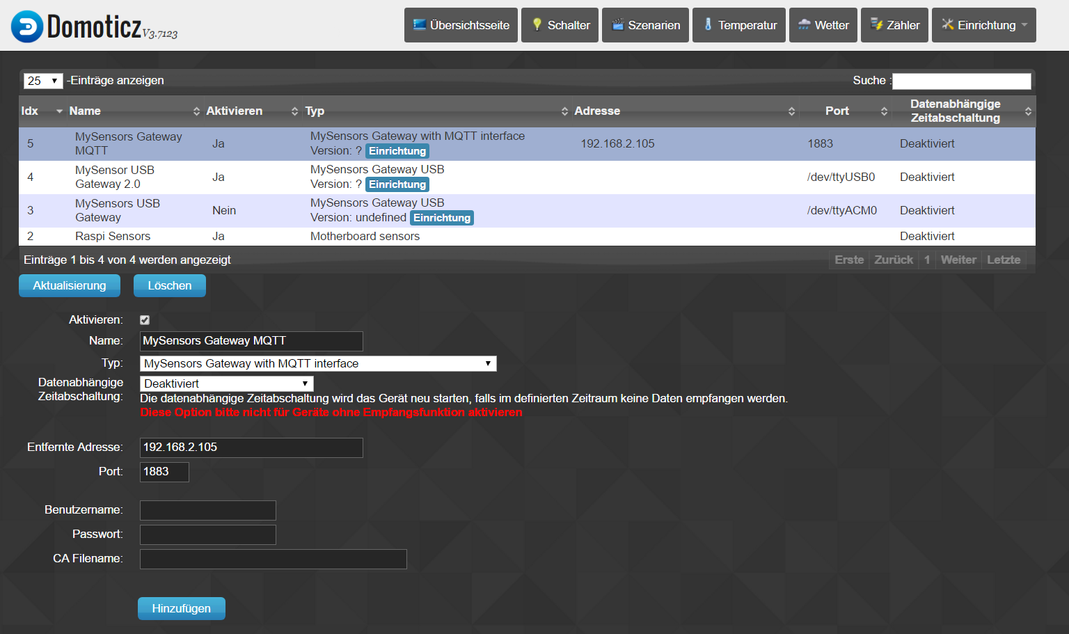

  • Hardware Contributor
    @siddmon Whats the problem with domoticz and the gw? Should be very easy to setup. Here is a picture of my settings:
    0_1490808772283_upload-e4d4a00e-c7b8-43ed-8611-602ac5c6818a
    Just use the right topic names in your gw sketch. More infos on that here.
  • Mod
    @siddmon remember to install beta version of Domoticz otherwise you will not get mysensors support
  • @LastSamurai Thanks for the image, I had the address as localhost instead of the IP of the raspberry PI, changed it and everything works now 🙂
    @gohan , yes, I upgraded to beta version since release doesn't have MQTT support yet.
