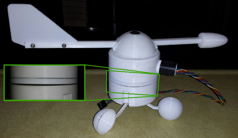

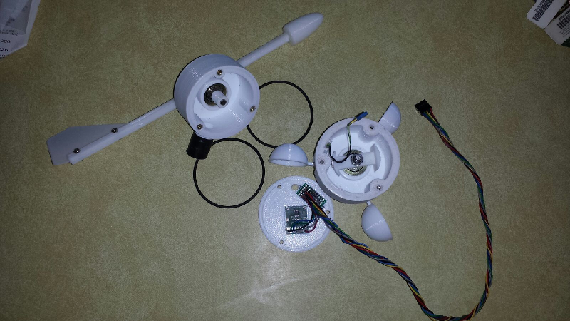

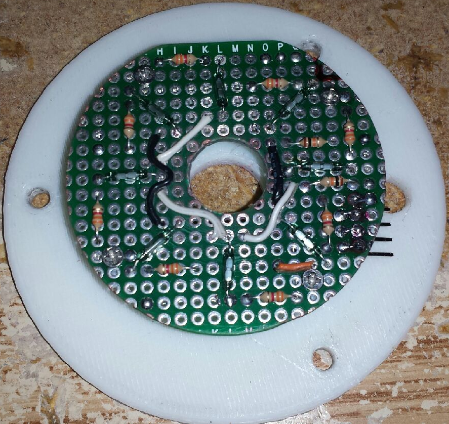

          Here are a few more pictures of the new layout with the new anemometer cups.
          0_1499087266284_upload-2b958d54-e3bb-4ae1-9ba4-815bc9ac5f88
          0_1499087278053_upload-dec6c2b6-ee03-4891-9f89-161246ed722f
          0_1499087288381_upload-164b9af0-fe6c-4ebf-ab25-e675e10c41d7

              So I am trying to figure out code for the wind speed sensor and I see there is a V_GUST value. I am wondering what people use for that value.
              • dbemowskD Offline
                dbemowskD Offline
                #89

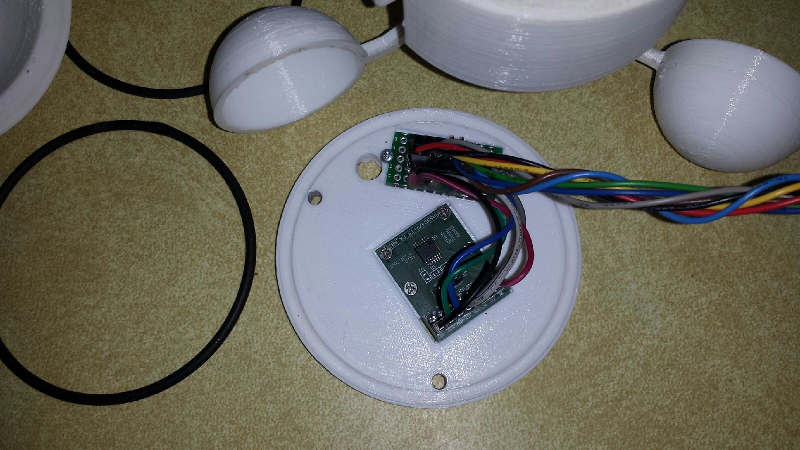

                So now that I have the wind direction sensor working, I need to try to migrate the code into my weather_station sketch. One option that I am working on implementing is a calibration button for North. So after I get things set up and mounted, I will use a compass to point the wind vane towards North. I will then press the calibration button which will save the current direction position to EEPROM if it is different than the one stored. The following code will then be used to get the true direction that the wind vane is pointing.
                value = 360 * myAS5047.sensor_read() / 16383; //Read the value from the direction sensor as a value from 0 to 360
                north_offset = EEPROM.read(address);  //Read the offset value from EEPROM
                dir = ((value - north_offset) < 0) ? 360 - abs (value - north_offset)  : value - north_offset; //Get the true direction
                insert code to read the button and if pressed, check the current value stored in EEPROM against the value read from the sensor
                and write the new value if it is different.  If the sensor value matches the current stored value, then ignore the write to
                save on EEPROM writes.
                So with this idea, I will need to know a few things. First, I am assuming that MySensors does EEPROM writes and reads. Is there a particular addreess pointer variable that I should use when writing my value to EEPROM? I will also need to know how I can get the address pointer to that data the same each time the arduino is reset, especially if MySensors does writes and reads.
                As always, any input is appreciated.

                  #90
                  Hello, @dbemowsk
                  You should use the built in method from the MySensors library to do that :
                  https://www.mysensors.org/download/sensor_api_20#saving-state
                  dbemowskD 2 Replies Last reply

                    #91
                    @Nca78 Thanks, exactly what I wanted to know.

                      #92
                      @Nca78 So my values are from 0 to 360, looking at the link you posted, the value that you save to an address is uint8_t which is equivalent to a byte (0 to 255). Is there a way to store a word value (uint16_t), or do I need to break the value into two bytes and store those into two positions?

                        #93
                        @dbemowsk said in MySensors weather station:
                        Yes it can only store bytes, but it's not a big deal to make a method to read/write values on 2 bytes.
                        Else you can just keep a precision of 2° and divide by 2 to get a 0=>180 value ;)

                                So I am trying to figure out the SPI for the wind direction sensor. Where is the SPI code for MySensors. Do I need to call SPI.begin()? Does MySensors code use transactions? If so, where can I find that to look at.

                                    @gohan It does, but it is an untested library. This is the test code that I ran using that library:
                                    #include "AS5047.h"
                                    #include <EEPROM.h>
                                    #define SWITCH_PIN 7 //The north calibration switch
                                    AS5047 myAS5047(5); // SS pin
                                    int address = 0;      //EEPROM address counter
                                    int north_offset = 0;
                                    long value;
                                    int dir;
                                    bool button;
                                      SPI.begin;
                                      Serial.begin(9600);
                                      pinMode(SWITCH_PIN, INPUT_PULLUP);
                                      value=(360*myAS5047.sensor_read())/16383;
                                      dir = ((value - north_offset) < 0) ? 360 - abs(value - north_offset) : value - north_offset;
                                      Serial.print("measured direction: ");
                                      Serial.println(dir);
                                      Serial.print("north_offset: ");
                                      Serial.println(north_offset);
                                      button = digitalRead(SWITCH_PIN);
                                      if (!button && north_offset != value) {
                                        EEPROM.write(address, value);
                                        north_offset = value;
                                        Serial.println("Button pressed");
                                      delay(1000);
                                    This test worked fine, now I am trying to merge this with my weather station sketch. I am not very familiar with working with SPI. In the setup() method, they call SPI.begin(). I am just trying to figure out what I need to do for merging the code.
                                    • dbemowskD Offline
                                      dbemowskD Offline

                                          These are the errors that I get when I try to run the code:
                                          Starting sensor (RNNNA-, 2.0.0)
                                          TSM:INIT
                                          !TSM:RADIO:FAIL
                                          !TSM:FAILURE
                                          TSM:PDT
                                          If I disconnect the direction sensor and start it, the radio works fine. The odd thing is that when I run the test code for the direction sensor with the radio connected to the bus, that works fine.
                                          Any ideas?
                                          Nca78N Offline
                                          Nca78N Offline
                                          #102
                                          @dbemowsk my guess is your sensor tries to communicate on the SPI bus and prevents communication with NRF24.
                                          I don't know what is in you AS5047 files so I'm not sure but I suppose it's taking over the SPI bus at creation, you should try to force the CSN pin used for the as5047 to HIGH in before() method to disable it before MySensors library starts using the radio.
                                          dbemowskD 1 Reply Last reply
