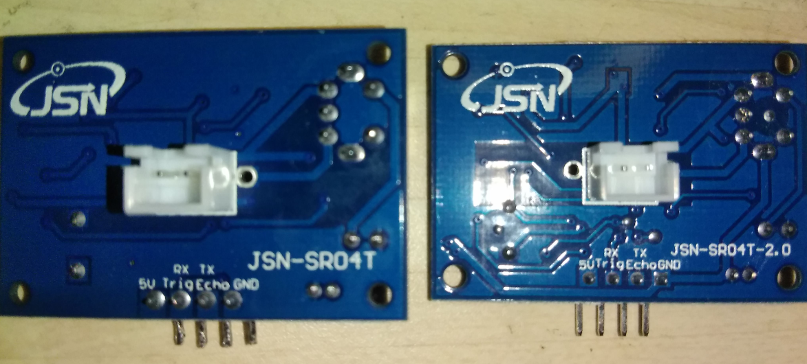

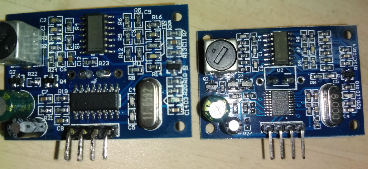

                  Hi all
                  Hope this will be of help to someone, I did connect the level convertor, did not make any change to the incorrect values, but then I saw that some off my JSN-SR04T are marked JSN-SR04T-2.0.
                  Eventually figured out that the JSN-SR04T-2.0 does not work with my design, there are some reports of other people not getting them to work either, see
                  http://forum.arduino.cc/index.php?topic=474759.0 , but no resolve.
                  So the circuit design above seems to be fine, except that it does not work with the JSN-SR04T-2.0,
                  The only differences I can see are the following
                  JSN-SR04T-2.0 - Crystal at 8,000 and the chip marked 7B499, 8S003F3P6, PHL703
                  JSN-SR04T - Crystal at 11,0592 but no markings on the chips
                  See some comparison pictures below
                  0_1494069439103_upload-3c793885-f086-4a34-98b7-ec8b48a04119
                  and the markings
                  0_1494069309883_upload-a95596c4-9c11-4174-9216-1f29028c01b5
                  zboblamontZ D 2 Replies Last reply

                            Denverado
                            @esawyja in the top photo, what is the component in the top left hand side? Is it a variable resistor??

                              @Denverado I think it is for the beam width, not to sure, I've never adjusted them

                                  @Denverado It is a variable inductor

                                      @zboblamont Thanks! What is it used for on the sensor?

                                        @Denverado If you mean the variable inductor, I don't know in this specific case...
                                        They are normally used in conjunction with other components to adjust frequency to target, my guess would be to tweak the ultrasonic frequency to keep it within specification (40kHz?), but perhaps someone can advise who has investigated these devices in detail.
                                        I would not advise tinkering with it unless you know the circuit and have the means to determine the effect.
