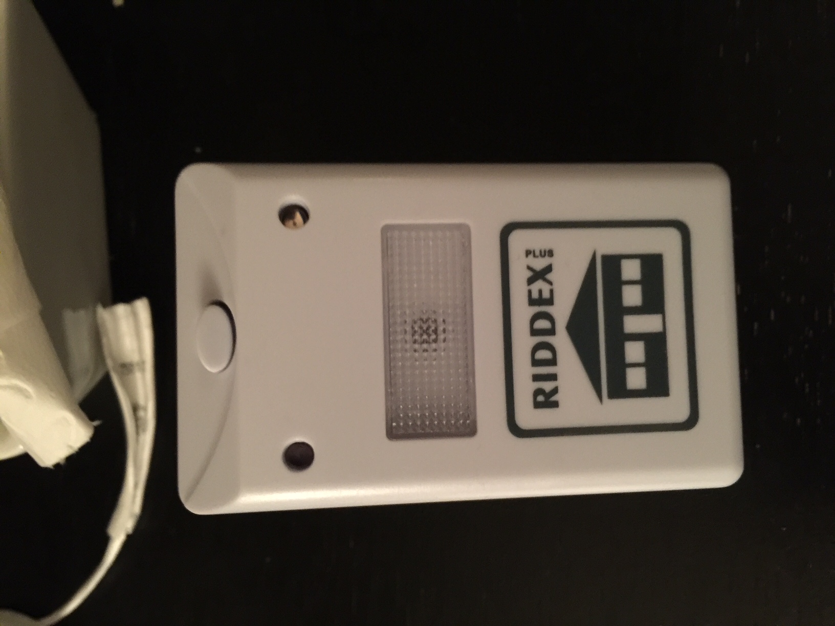

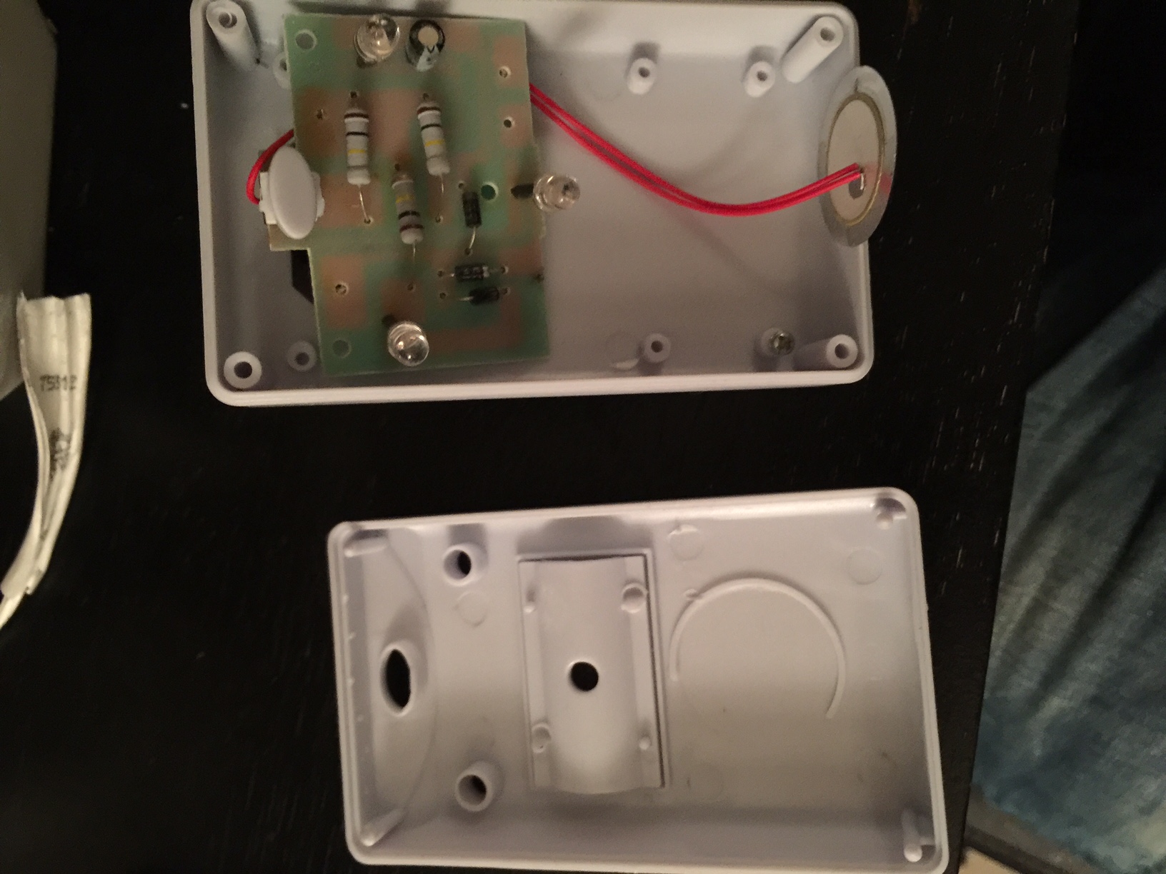

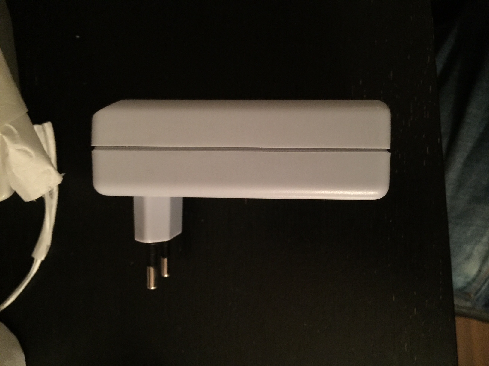

    The node is housed in a case from a riddex pest repellent (not working ;) and the hardware is soldered to sundbergs84's nice Easy PCB.
    I am using Domoticz as controller on a Rpi.
    Pictures of casing
    Pictures of PCB, RF433 transmitter and HLK power module with fuses.
    I didn't have any pictures at the final assembly but that can be arranged if someone is interested.
