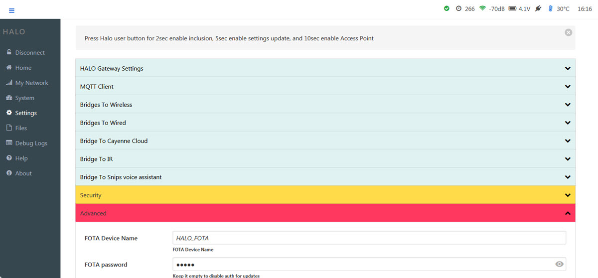

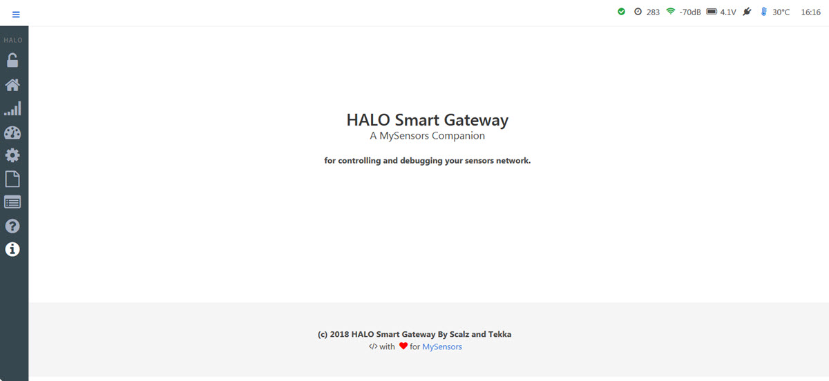

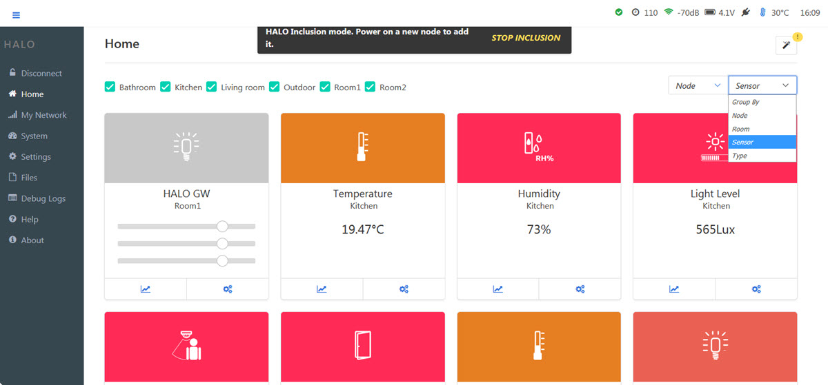

              I know I don't give news about this project.
              So, maybe I should show you few pics, just in case.. ,)
              First, I prefer to say, we can't share code for the moment..not very release-able.
              We are using completely custom code for this project. GW code is quite big, mysensors is an experimental version (sort of "v3"). Plus for all the features, sometimes it can need some tweaks in esp32 libs etc. for the moment, sw is still tied to this project&hw.
              That said we have lot of neat stuff working, hw choices changed a bit too.
              Here we go:
              • asynchronous
              • http webserver + websocket server
              • mqtt client
              • transport bridging
              • embedded webapp for UI
              • etc.
                Well I cannot make a list for the moment, there are lot of features.
              Concept is autonomous simple network without need of a advanced controller, or when linkto/controller is down, that you can control and debug from your phone or computer. With step by step configuration, inclusion etc for easy getting started.
              Pics of the app ?? Teasing ON!
              The app is realtime and very reactive. Responsive and mobile friendly. This is a single page app. written with Vue, no jquery. lightweight Bulma CSS
              I started to make some widgets.. there are also multiple filters for dashboard.
              It will also be possible to get infos about network, rssi, stats etc
              Lot of settings, I let you imagine them.. there are a few dedicated steps by steps too, handy for starters (like my family, friends..).
              It's also possible to see all logs, downloading them, updating app files etc.
              Teasing OFF, I prefer to keep some other nice features to show you later :stuck_out_tongue_winking_eye:
              don't ask for a release date plz, we're busy on lot of projects, but we'll try to do our best! stay tuned :)
