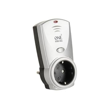

                    @Boots33 said in [How to build an overridable MySensors relay based device
                    You can still notify the controller of the change but use node to node to activate the light. This is usually the simplest way to go. It also has the advantage that even if the controller is not available the light will still switch.
                    Ok - I'll look into that.
                    Like i said having the switch connected to the node that controls the light is the most reliable way, but not always the most convenient.
                    The node is going to be in a plug socket type device instead of in the lamp in some way. The lamp will plug into this socket. So I can't work out a way to conveniently have the local switch attached to that without being quite ugly and ungainly.
                    Where is the node that will control the light going to be. Are you fitting it inside the lamp or is it to be external?
                    It'll be external - built into a plug socket. I figured that gives me more space to work, much like the X10 equipment I'm replacing.
