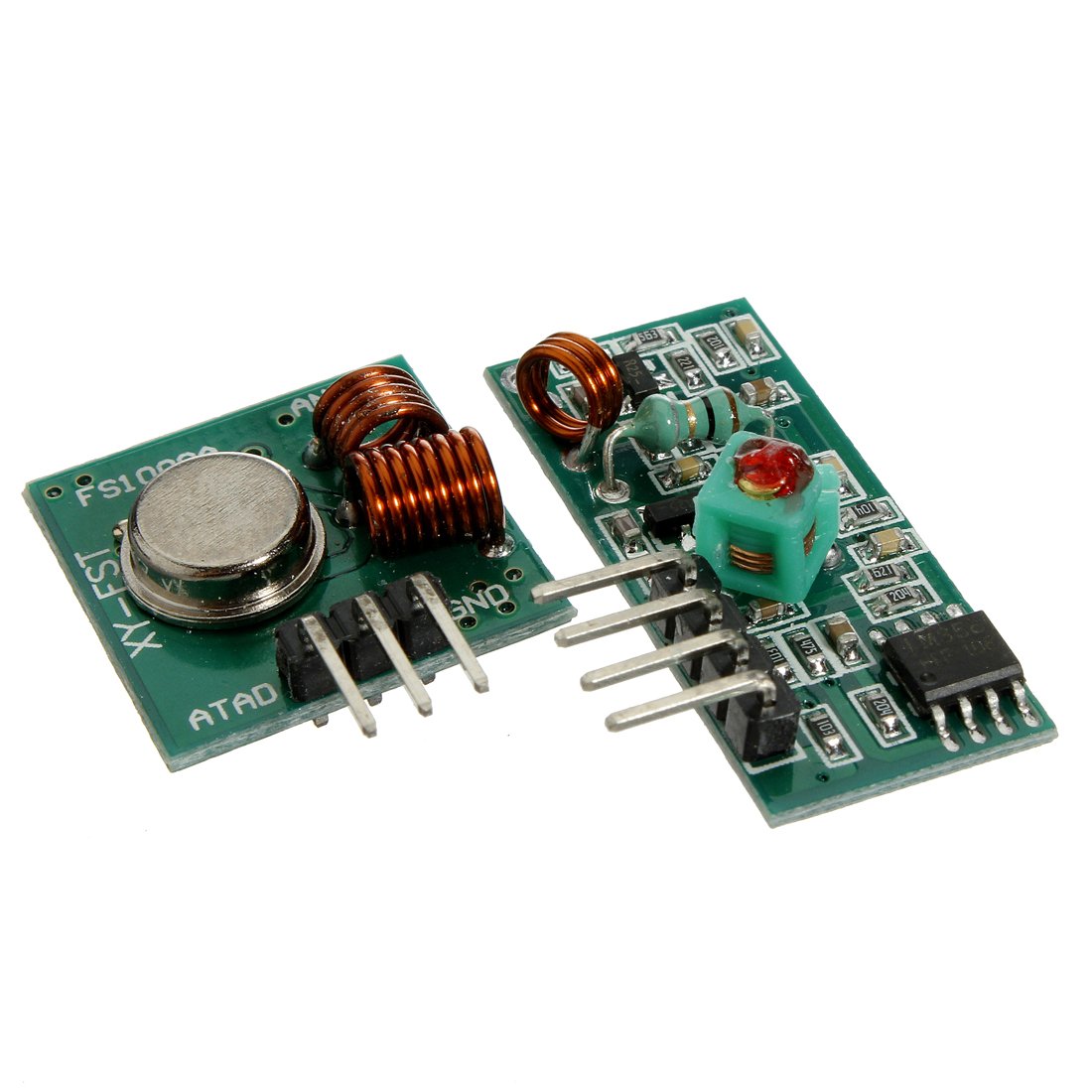

      @rejoe2 I've read many discussions about choosing between nRF24 and RFM69, and all the people agreed that the range of nRF24 was really bad.
      I haven't tested it myself, but I'm using that kind of things :
      And the range is really bad, I can't communicate from one side of my apartment to the other (even with self made antennas! - 2 walls to pass and about 12m).
      I'm buying a house, the place will be bigger and there will be a second floor, so I want to invest in something working at longer range 🙂
      For what I've read, I like the idea of MQTT Broker and the use of Node Red with Domiticz to handle the sensors. But I'm still open the the RF way for small cost sensors... Since my Wifi sensors won't need a gateway, I can still use my Pi as a RF gateway and use both networks if I need !
