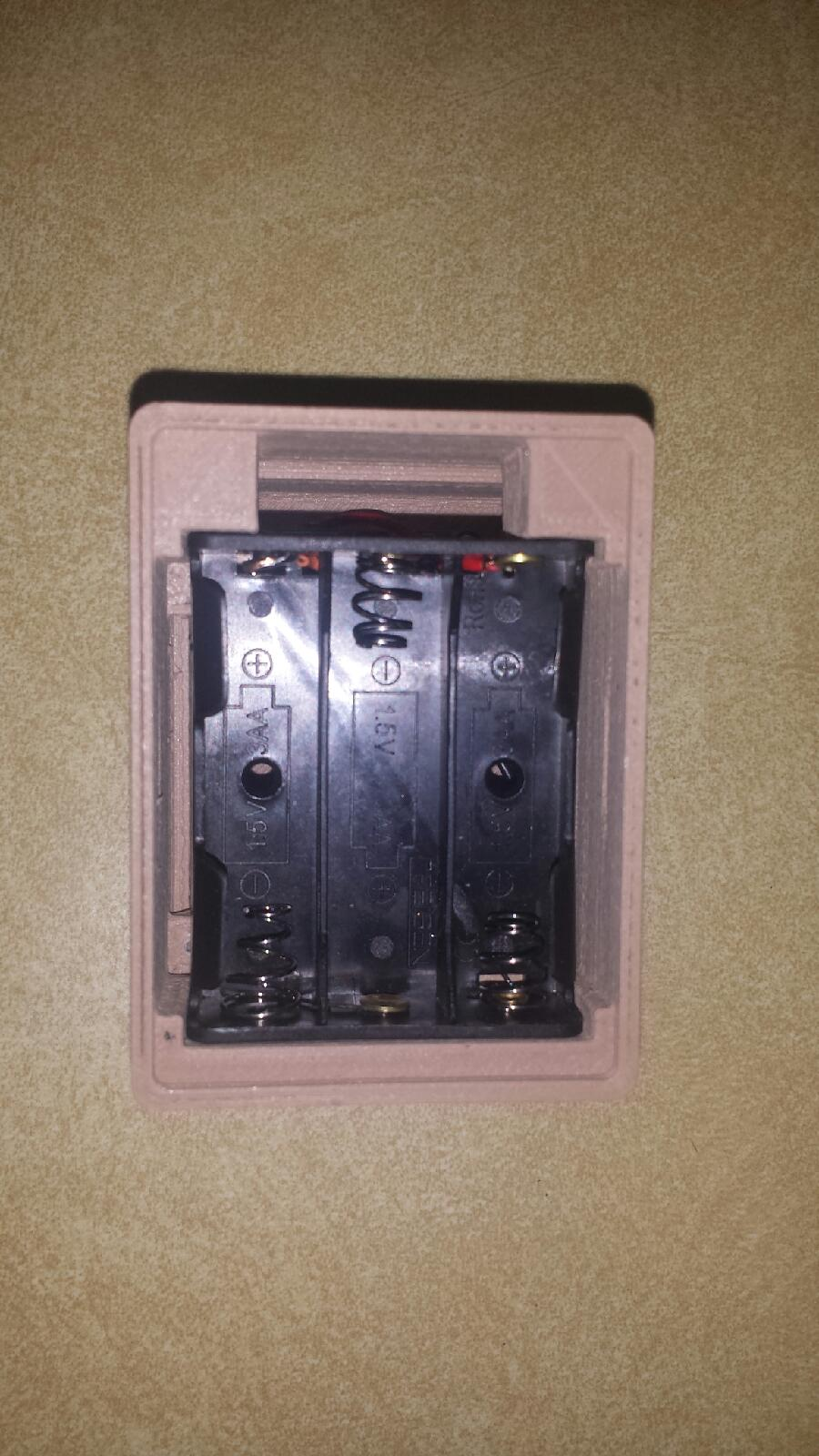

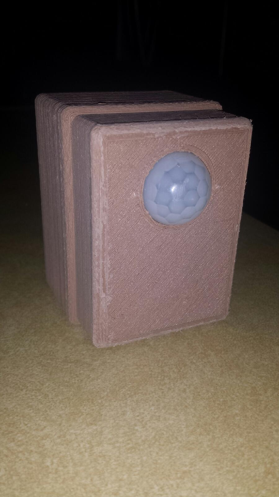

  • @Yveaux I like that idea. The wall mount enclosure that I am planning on testing things with is an offshoot of my temp/humidity sensor enclosure. Here are some of the cad pics that I did in OpenSCAD.
    0_1507493227830_upload-6ff34941-a22a-4fa5-8c25-1aeb06a47bdf 0_1507493233126_upload-108f0a0f-879c-4cbc-a004-8ab861266870
    This has the supports for holding a 2xAA battery case. I do not have any 3xAA battery cases, but I could get some and modify the design to fit it. I completely overhauled the OpenSCAD design for the temp/humidity sensor last week, so making slight changes in the case design should be fairly easy. For anyone interested, here is the OpenSCAD code for the drawings you see.

  • So I had ordered some 3-AAA battery holders and they arrived yesterday. I took one of them and added an orange wire which is my 3v tap, and then the red wire is the 4.5v line. I should have the circuit built today
    I am in the process of printing a modified wall box to try this out. I have made the changes needed to fit the new battery holder, just making a few tweaks.
    0_1509205749511_upload-a13ac498-9ba4-443e-8024-18440cab229d 0_1509205755386_upload-1af744da-0220-449e-9ee4-b1e521e3579e
    I have posted the new motion sensor box out on thingiverse for anyone interested.
    https://www.thingiverse.com/thing:2612414
  • @dbemowsk Printed with Wood PLA.
    0_1509241596097_upload-5157a48d-0efe-4071-8ea3-15f52ee4621f
    0_1509241619596_upload-71d2537f-8eb9-4694-81cf-b9183eda8108
