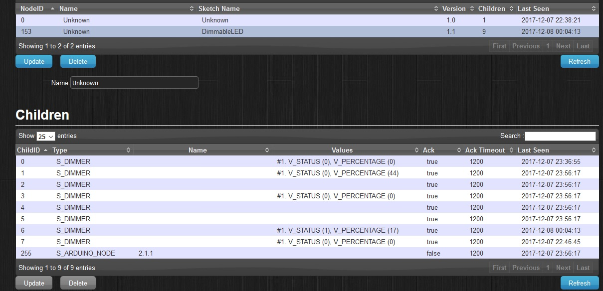

    Hi
    I'm testing Dimmable LED Actuator --> https://www.mysensors.org/build/dimmer
    Everything seems to work with Domoticz except one thing - It doesn't remember last dimming value (This is a feature I really need).
    After switching the light off and back on , no matter what value was before it goes everytime to 100%
    Figured out If I change the value 100 : 1 to 10 : 1 - It goes to 10% - but still It doesnt remember the last dimming value.
     // Adjust incoming level if this is a V_LIGHT variable update [0 == off, 1 == on]
            requestedLevel *= ( message.type == V_LIGHT ? 100 : 1 );```
    I've found a sketch DimmableLight in My sensors examples which I would like to test unfortunately I cannot force it to work with LED stripe connected according to dimmer sketch( Mosfet , led pin 3 etc..)
    Could someone help me please with the code ?
    Which part is responsible for sending the information to LED_PIN 3 ? I tried to define LED pin3, also fade delay etc... to the below sketch - no luck.
    Does it matter if the variables are V_LIGHT and V_DIMMER if the type is S_DIMMER ? (both sketches) Shouldn't it be V_STATUS and V_PERCENTAGE ?
    Any help very welcome !
    Thanks in advance.

      @Plantex could you post the serial output fom the node? That would be very useful, allowing us to see what happens.

              Hi
              Instead of trying to solve the problem for 1 Led stripe I've decided to go with 6 pcs now - basically I'm gonna need this anyway to do my "high-end" stairs.
              So what I've done is I've combined Your sketch with some other especially the part with few led's declaration
              #define MY_RF24_CE_PIN 49
              #define MY_RF24_CS_PIN 53
              #define MY_NODE_ID 153
              #define SN "DimmableLED"
              #define SV "1.1"

              So I have right now 6 LEDs in Domoticz connected to Arduino Mega 3,5,6,9,10,11 pins ( I hope all of them are PWM)
              At first usage It behaves crazy - It's like every switch needs the first on and off sequence to start behave normally.
              What happens then:
              LED 1 ,2, 3, 5 - all work ok , every single one saves the last state when switch off/on , dimmer bar works fine
              now the best part :D
              LED 4 - when I switch it On (mouse click in Domoticz) LED is going ON (physically) but the same time LED 1,2,3 is going ON (but only in Domoticz so let's say they are virtually ON but in reality OFF) - dimmer bar LED 4 works ok , saves the last status, You can switch it off but 1,2,3 will be still ON (you have to click each one to take off the virtual status)
              LED 6 - works very similar to 1,2,3,5 - when I move the dimmer bar to e.g. 15% LED it is reacting it is ok BUT suddenly after 1-2 seconds dimmer bar goes to full range (led still shines 15%)
              LED 6 Is also unique - if I play with any of the switches and dimmer (1,2,3,4,5) this one is going virtually ON (domoticz reporting it is on - and its bar is going to full range)
              Please help me to understand where is this behavior coming from.
                What happens then:
