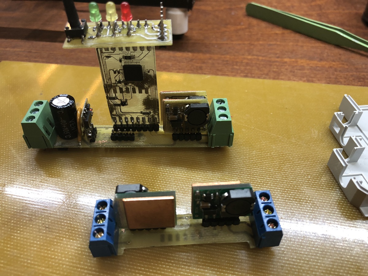

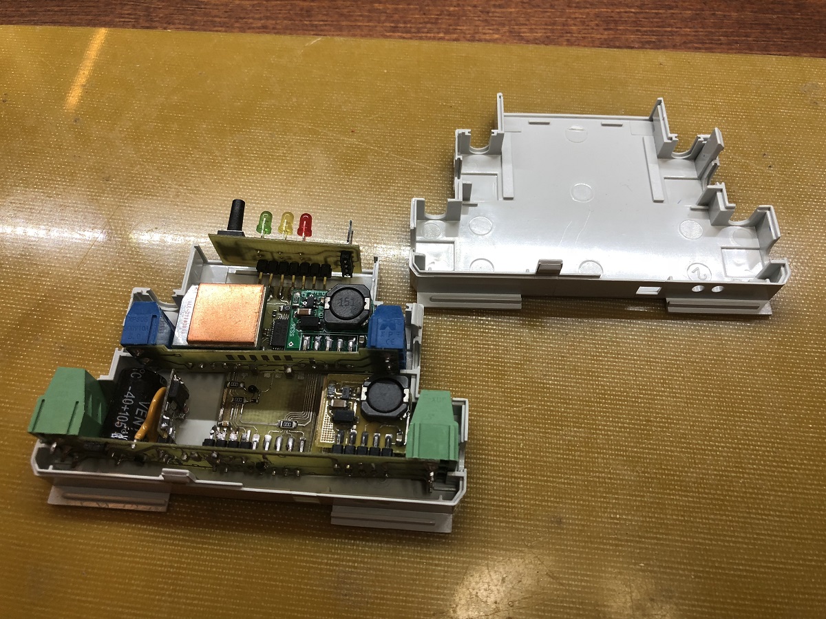

    Working prototype:
    1_1531564764819_Фото 14.07.2018, 13 20 07 sm.jpg 0_1531564764819_Фото 14.07.2018, 13 19 51 sm.jpg

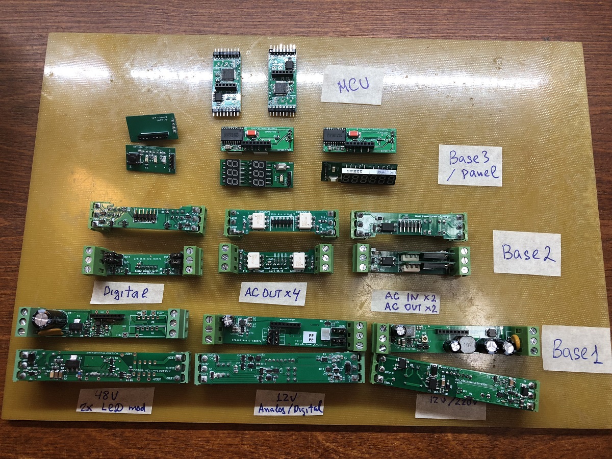

    A LEGO set:

      That looks really good. Did you made an estimate of the average cost of single node?
      A 1 Reply Last reply
        A Offline
        A Offline
        axillent
        @gohan Price is very depends on volume. 10 pcbs are costing me $10 for the set while 50pcs costing $15
        Etc. 4pcb for the unit is $1.2-4
        Box +$1.3
        The rest is BOM, also very depends on volumes and on a unit specific details.

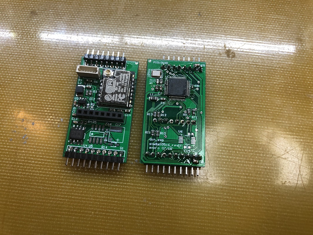

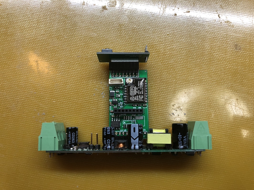

            A new design, just ordered PCB. An upgrade of previous MCU PCB:
            • STM8S105C6
            • EEPROM I2C 512K - to support OTA
              added:
            • ADC1115
            • DS3231
            • ESP-M1
            • NCP1529 for 3.3V
            • supercapacitor to support RTC
            • SH1.0 connector to flash ESP
            • 2 pin on base 1
            • 2pin on base 2
            with soldered ESP will became a local net router, can connect local wired network to Internet and MQTT
            also will run RTC application on local and global net
            sense and drive

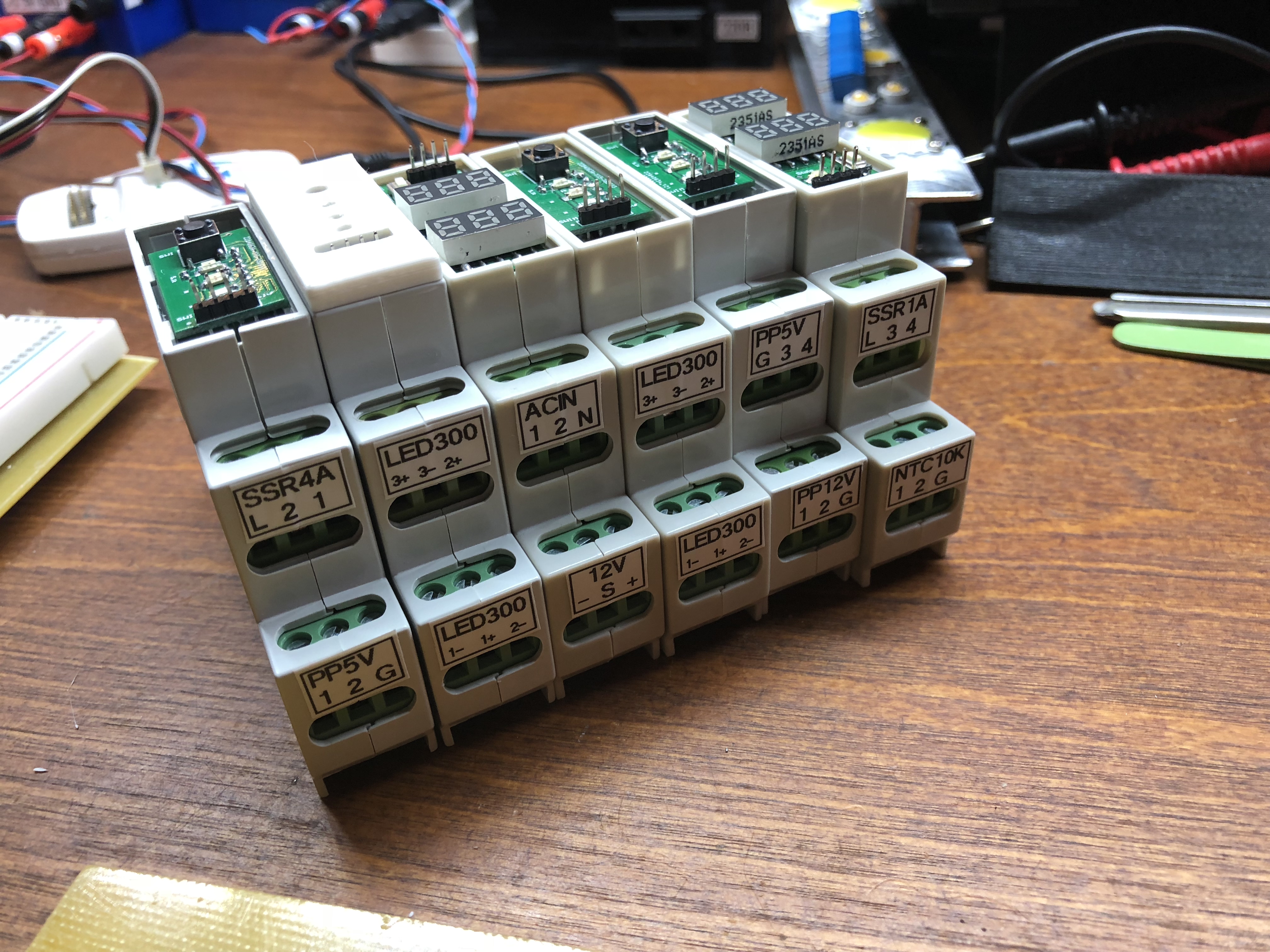

              assembled for particular applications

                  • A Offline
                    A Offline
                    axillent

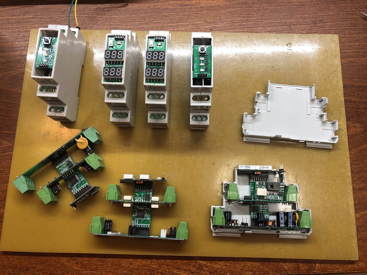

                    this is going to be WiFi router from local 3 wire net to Internet or remote ioT net
                    1_1534706184901_Фото 19.08.2018, 22 10 47.jpg 0_1534706184901_Фото 19.08.2018, 22 02 03.jpg
                    sense and drive

                      wifi router got a firmware and box
                      can be cloned as many as needed, one per simple network segment
                      it is managing automated routing between segments
