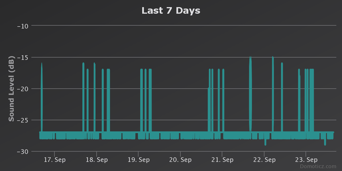

            @dell640 at 10cm the antennas are within eachother's near field of RF propagation. No numbers from datasheets will be relevant in the near field. The antennas need to be at least one wavelength (70cm/2.3ft) apart.
            dell640D 1 Reply Last reply

              @mfalkvidd said in RFM69HW RSSI / range problems:
              Thanks for that. Its pretty theotertical stuff, however it is fact.
              There is no change in RSSI if I'm moving the nodes more far or close. RSSI keeps in same range of -20 to -30dB in range of approx 2 meters...then it of course going down...
              Are these RSSI values maximum for RFM69HW?
              Do I understand right, that receiving RSSI values should be = 20dBm - TX antenna gain/loss - transmission loss - RX antenna gain/loss --> RSSI at zero values at the minimum?

                @dell640 I think that formula should be correct.
                This is the rssi for one of my nodes

                    @mfalkvidd
                    Thanks! That is almost the same as my readings.
