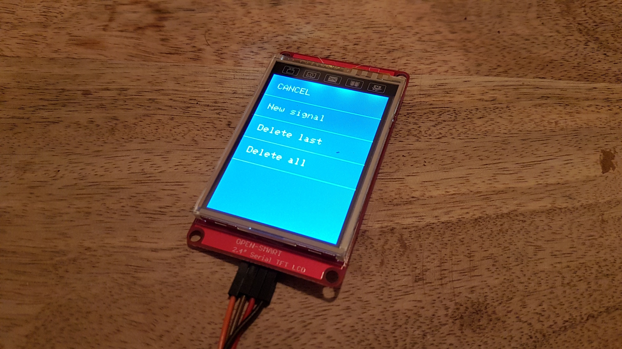

    It took three weeks to build, but here it is: a device that will easily connect almost any 433Mhz device to your smart home.
    The 433 Hub can do two things:
    • You can teach it a signal, and from then on it will be able to detect it.
    • You can teach it a signal, and from then on it will be able to replay it.
    Both of these features come in 'single signal' and 'on+off" versions. So for example:
    • You could copy the ON and OFF button from a remote for your 433Mhz sockets, and from then on switch the socket from your smart home controller.
    • You could teach it to detect window sensors that have both on and off states.
    • You could teach it to detect the alarm signal from a wireless smoke detector.
    For each signal that you teach it to recognise, a door sensor will be presented to your controller.
    For each signal that you teach it to replay, an on/off switch will be presented to your controller.
    Signals take between 8 and 28 bytes to store, depending on complexity and if they are simple or on+off signals. This means an Arduino Nano can store between 20 and 60 signals in just half of it's eeprom (512 bytes).
    HARDWARE
    • Arduino
    • 433Mhz receiver & transmitter
    • Touch screen (optional, recommended)
      or
    • OLED screen (optional)
    • Keypad (optional)
    Here's the version that uses a touch screen.
    Here's a version that uses a keypad.
    With a 12 button keypad you can easily replay 10 signals. The last two buttons are used to navigate and make selections in the menu system.
    You can also trigger the learning sequences from 4 virtual buttons that the device creates on your controller (detect simple, detect on+off, replay simple, replay on+off).
    It works best if you use the touch screen. Using the menu you can delete the last recorded signal, or delete all recorded signals.
    It's designed to work with the upcoming Candle privacy friendly smart home, and the Candle Manager. More on that later this year.

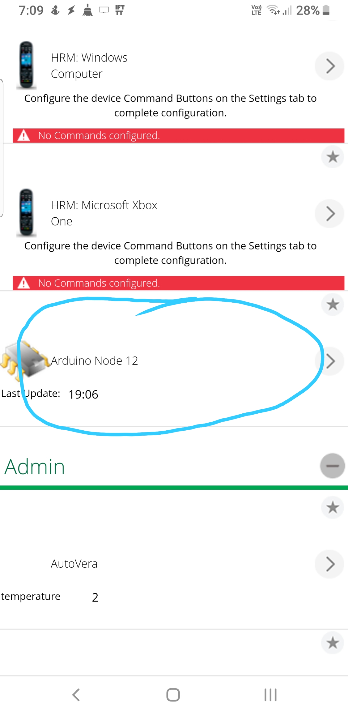

                                        I've finally finished building this, but sadly it doesn't want to work with my controller (Vera). When I start the inclusion process I'm says that it has found 2 devices, but when the controller finishes setting it up it only ends up showing one device, and all it says is that it is a node.
                                        Has anyone built this and have had success with Vera? If you are using this, which controller do you use?

                                          It should not show a temperature sensor, since it doesn't have one. Are you sure it has actually connected? Try listening to the serial output of the node (using the Arduino IDE's option to do this), and check if it says that it has connected ok, and that is is showing you the decoded signals then you play the RF signal. You can even try enabling the debug option to get even more details about the node's state.
