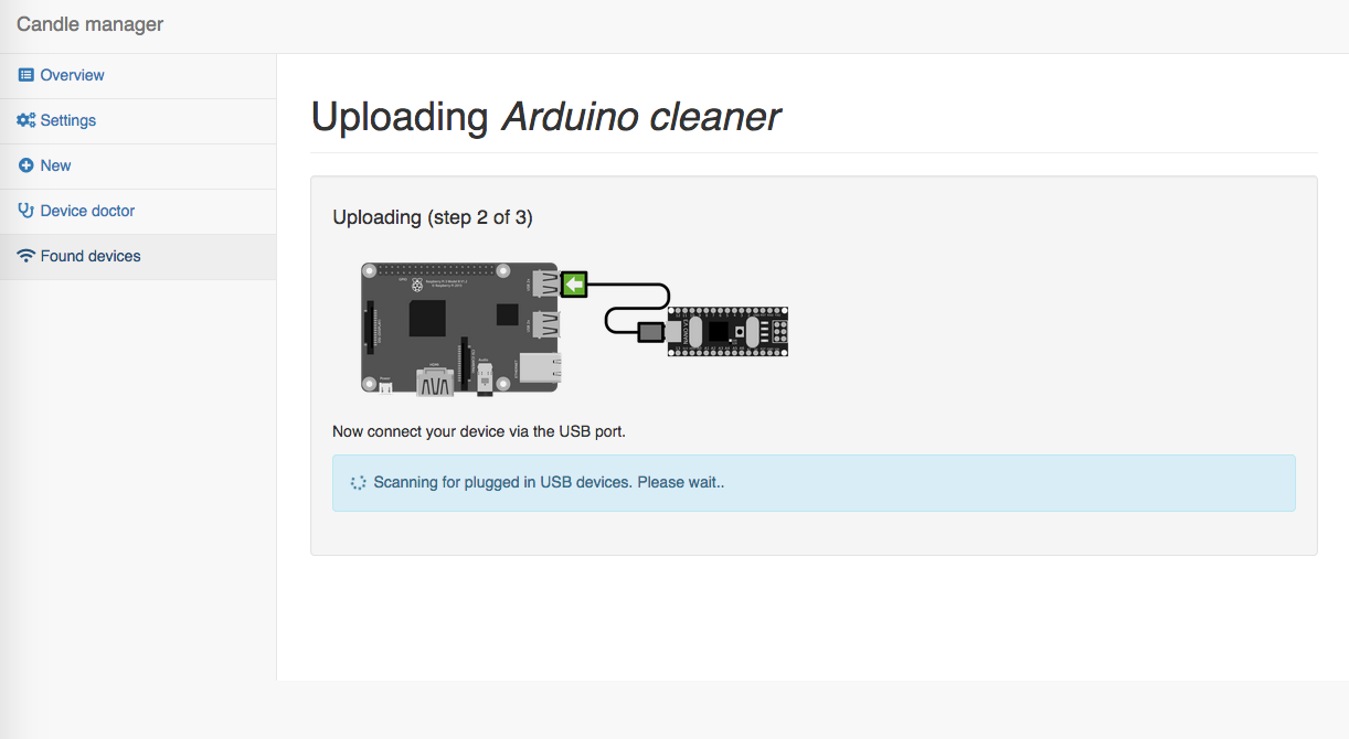

    For a project I'm working on I've created a small tool that could be useful to everyone in the community. I'm sharing an early version for Christmas :-)
    The tool is meant to be used with the Raspberry Pi. Through this web interface you can generate and upload code to a plugged in Arduino with the click of a few buttons.
    It takes code templates (which are just normal Arduino files), and transforms them into an easy to use interface so that users can change some settings.
    From the user's preferences new code is generated. This can then be uploaded with the upload wizard:
    The user never has to see any code if they don't want to. But if they do it has a built in code editor too.

          • alowhumA
            alowhumA
            alowhum
            Plugin Developer
            wrote on last edited by alowhum
            @homer This is how I do it:
            • First download the latest Mozilla WebThings Gateway image and burn that onto an SD card. Their guide will explain how to 'burn' it onto an SD card.
            • Insert it into the pi and boot it up. After a while you will see a new WiFi network for the gateway. Connect to it and follow the steps. You can skip the step to make a subdomain at Mozilla.
            • Once done, open gateway.local in a browser that's on the same wifi network. You should now see the Mozilla Gateway interface.
            • Under settings -> development enable SSH.
            • Open a terminal window and SSH into the device. Google how to do that. For linux/mac it's something like: ssh pi@gateway.local and then enter the default password raspberry.
            • once logged in, you have to install PHP.
            sudo apt-get install php5-fpm php5 -y
            • Next, copy the Candle Manager from Github onto the Pi.
            git clone https://github.com/createcandle/Candle-manager.git
            chmod +x ./Candle-manager/start.sh
            Now you should be able to go to gateway.local:8023 to see the Candle Manager.
            By default it comes with only one demo sketch. In the future you will be able to install a lot more. Arduino Sketches have to be properly formatted and placed in the 'sources' folder to be automatically presented in the Candle Manager interface. Examples of such sketches can be found here.
