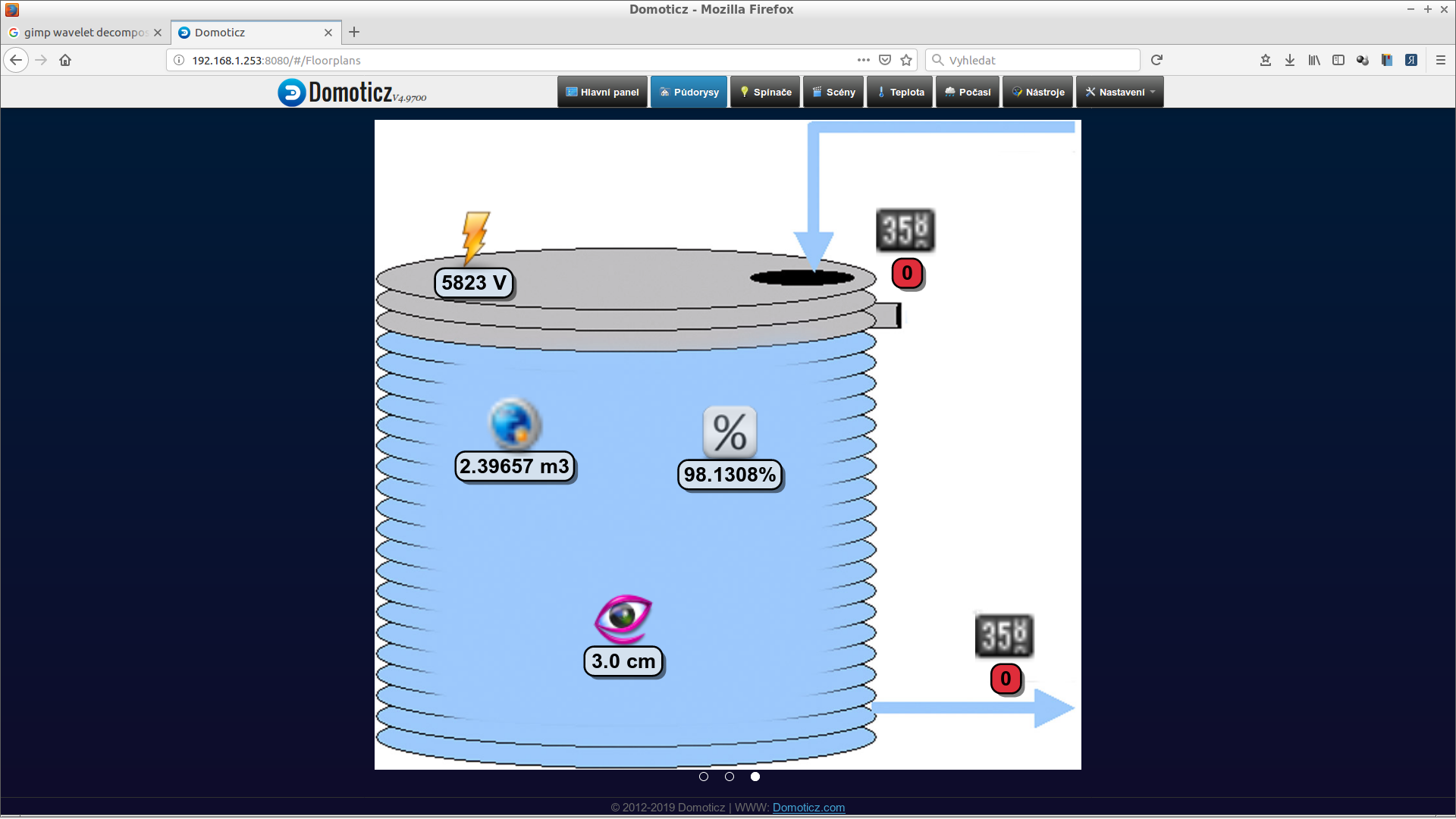

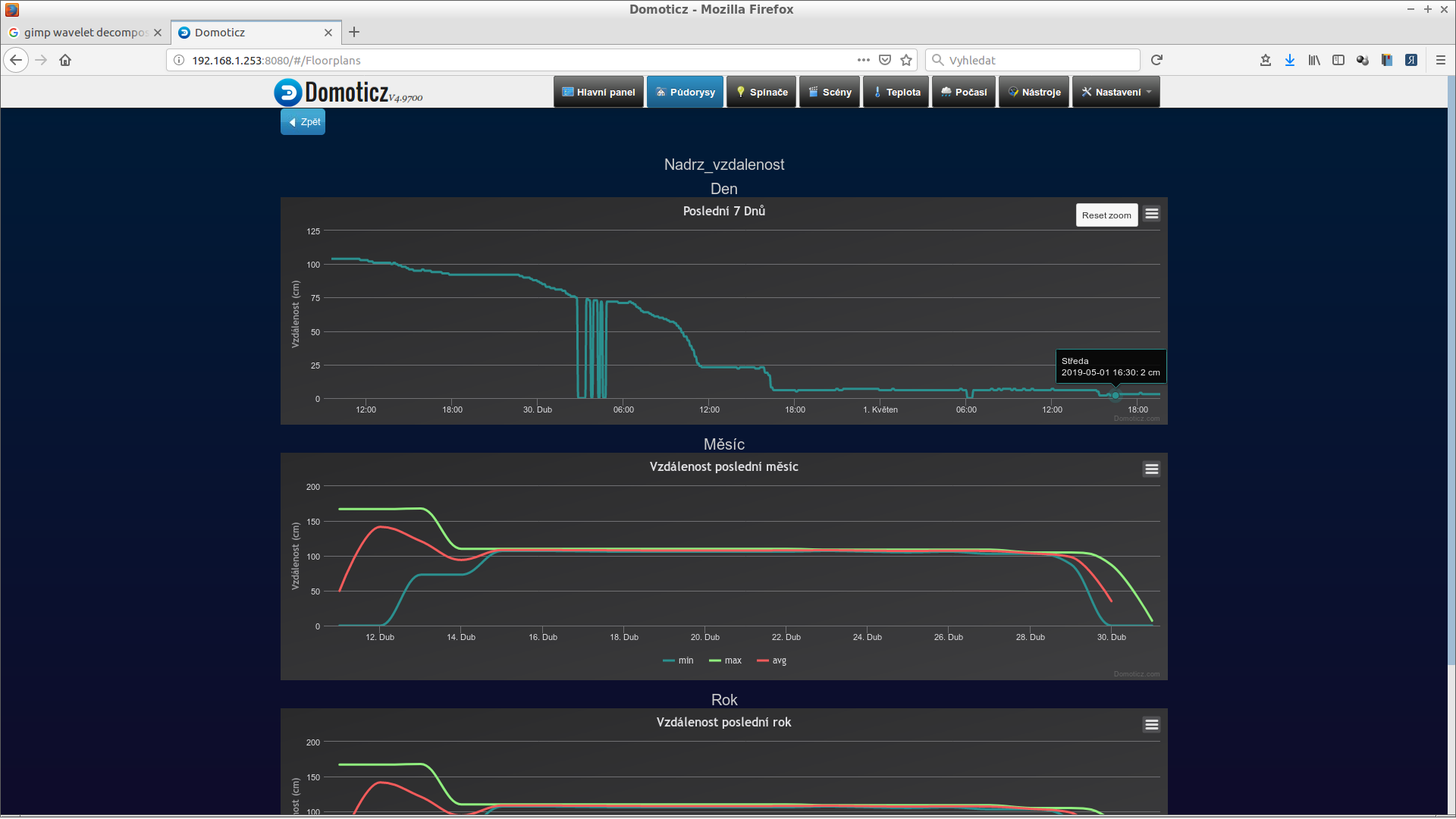

          I am using HC-SR04 for reading water level too.
          My measuring range is 110 cm = empty tank, 2 cm = full tank. ( this is now ).
          Only problem I have got - when it is raining, some water drops condenses on sensor at night and sensor sends zero value.
          Or I need better cover for my sensor ...
          I eliminate by Domoticz code these bad readings.
          I send to Domoticz actual distance and battery voltage every 10 minutes and calculate volume in m3 and percentage and water influx or consumption.
          I am using battery powered Arduino Mini with MySensors network.
          Only power led removed - consumption in sleep 70microA.
          I am cutting off power for SR04 during sleep with small relay too and then it power on again.
          There is a little delay before distance measuring and I read three times distance and use only last reading, because independently on delay time, first readings returns zero value sometimes after power on sr04...

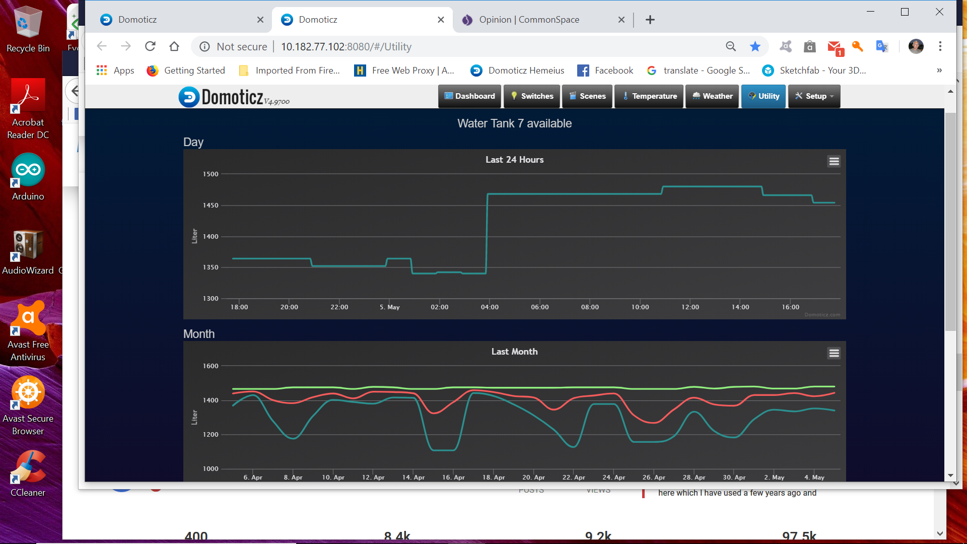

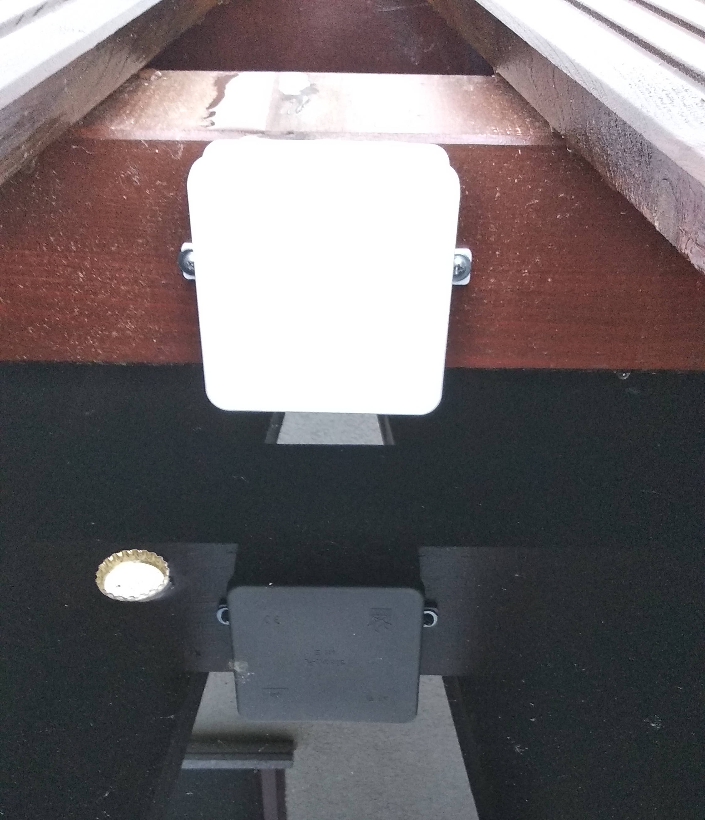

              @kimot said in Solar powered node, that should only send occasionally:
              HC-SR04
              I can heartily recommend using a 5v booster via the relay to power up the ultrasonic, it works a treat on the 2nd version using only one set of batteries.
              The heads used here are the single waterproof type used in parking sensors as my tanks are sealed thereby high humidity. Condensation blinding the head only occurs occasionally when below -10, I suspect down to my choice of steel conduit with the head in a socket on it's end (heatsinking effect).
              My solution to the initial zero, varying readings, and failures was to seek two consecutive readings within expected range and only make 10 attempts before going to sleep.
              Initiating on the RTC hourly fitted initial requirements to verify the borehole pump topped up the tank at 3am, the Node makes the calculations and decides whether to send it in as valid. Toying with tracking the fill more closely, but that is a nice to do if battery life can be reasonable...
