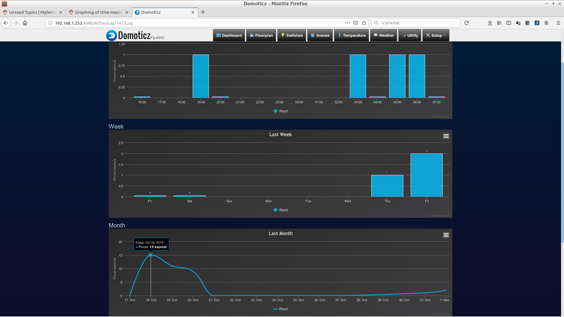

                      Domoticz has a nice dummy counter or dummy incremental counter, where you can enter the unit quantity.
                      MySensors unfortunately is unable to send data to these counters.
                      I am using them with ESP8266 to send energy consumption of my floor heating or number of actions of my relays.
                      So I recommend to use DzVents scripts in Domoticz instead of node-red.
                      I see two ways.
                      1.
                      Send from node for example in watts or m3 or litters.
                      With DzVents translate this value to time in minutes in Domoticz created dummy counter.
                      Write DzVents script for your switch, which saves time for ON action and when OFF action occurs, calculate time interval and adds minutes to dummy counter.
                      Then you can see the beautiful statistics for each day of the entire year back and the actual total value too.
                      For example here for my relay actions:
                      ( "zapnuti" = "relay on" )

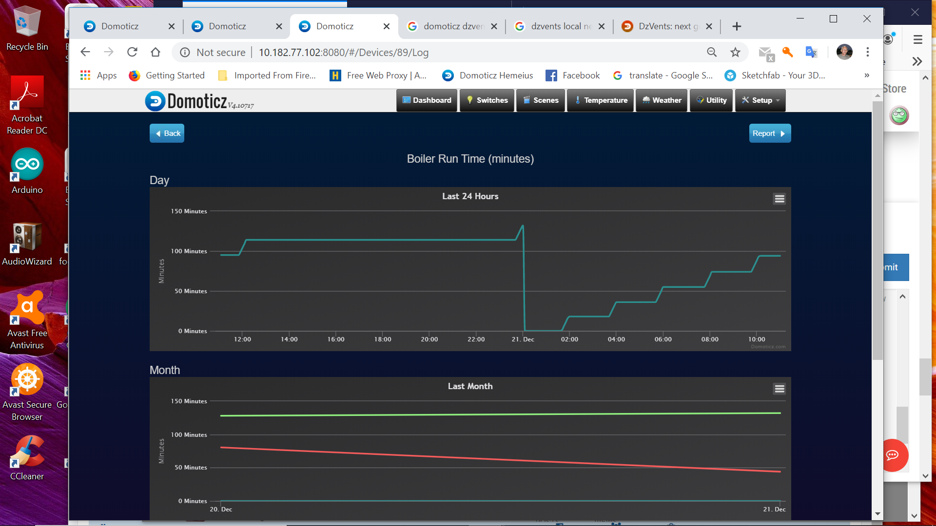

                          Having gone through various hoops and headaches the objective is finally solved but by a method I'd not considered, that being to switch from the Node doing the work to Domoticz executing it internally.
                          The objective had been to record boiler run times and record the boiler feed and return temperatures. The latter hit a problem (unsolved) over the Dallas Library, but after some pointers from @ scalz, it was cracked using the Onewire library in isolation.
                          The psu and the boiler states are reported as logical switches, the cumulative run time in kWh as @kimot had suggested.
                          Unfortunately, as the Node is mains powered with a battery backup, it will continue monitoring in a power outage, but on restoration of power, the Node reboots and sets the cumulative running time back to what was defined in the sketch.
                          Couldn't get the V_VAR retrieval method from Domoticz (UPS powered) to work (my lack of understanding), but stumbled across a post on the Domoticz forum (a Niels someone?) who used scripts to record duration in minutes for the ON state of the logical switch to a Custom Sensor, and resets that value at midnight.
                          The recording script-
                           -- Update Boiler Run time record
                          commandArray = {}
                          TotalMinutesOn = otherdevices_svalues['Boiler Run Time (minutes)']
                          if otherdevices['Node 8 Boiler ON'] == 'On' then
                            TotalMinutesOn = TotalMinutesOn + 1
                          end
                          table.insert(commandArray, {['UpdateDevice'] = otherdevices_idx['Boiler Run Time (minutes)'] .. '|0|' .. TotalMinutesOn})
                          return commandArray
                          and the reset script-
                          --Reset Boiler Run Time to Zero at midnight
                          commandArray = {}
                          Time = os.date("%H:%M")
                          if Time == '00:00' then
                            table.insert(commandArray, {['UpdateDevice'] = otherdevices_idx['Boiler Run Time (minutes)'] .. '|0|0'})
                          end
                          return commandArray
                          Despite some mucking about yesterday it is now doing precisely as intended, and Domoticz displays this to the default daily 5 minute "accuracy".
                          There are a many more refined external analysis tools, but as a simple working overview this does what I intended, and hopefully helps others newbies caught in similar WTF moments...

                              @anand There was vastly more time wasted trying to get the original concept to work, than it look to learn basics of Domoticz scripting after finding a solution used by others.
                              The sketch complexity and size is dramarically reduced for the Node, it still responds to changes in boiler or PSU condition within a second, and reports temperatures and power condition regularly.
                              Domoticz reconciles everything to default 5 minute time slots, this method provides boiler run times to an accuracy of a minute which is quite adequate.
