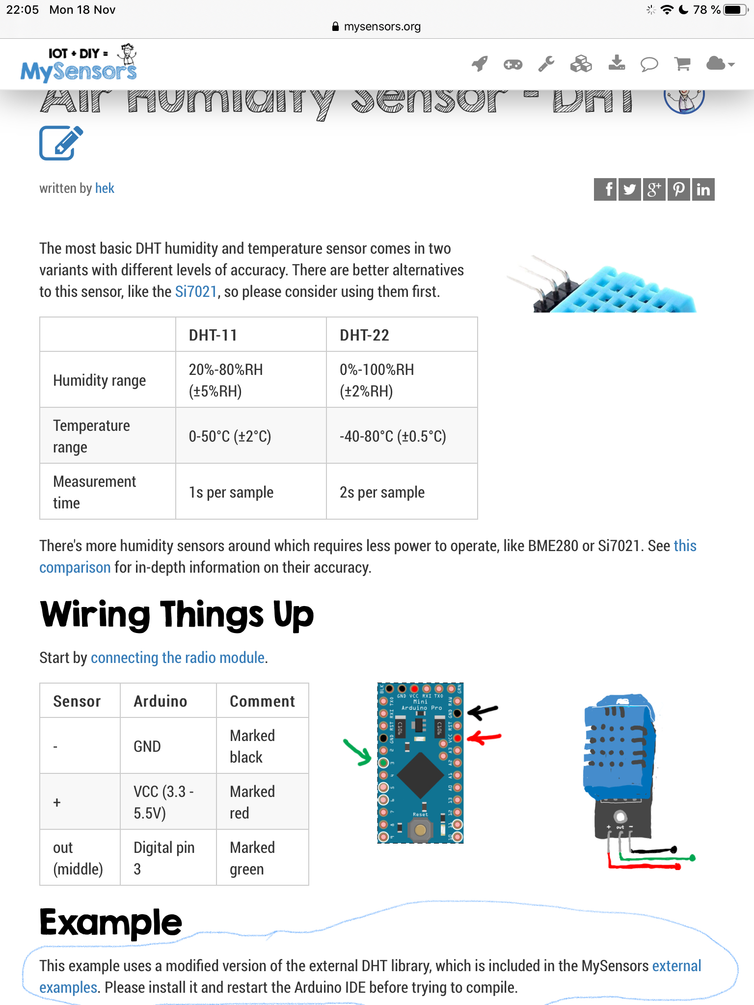

          Yes I'm using the script you link to, but compiling it tell that it can't find DHT.h, so I was looking for the DHT libray, It seems that this library is not part of MySensors 2.x download when you from the IDE install library's.
          mfalkviddM badmannenB 2 Replies Last reply
          • K Kurtsejr
            Thanks @badmannen
            @kurtsejr yes that's correct. You'll need to follow the instructions on the build page (outlined in blue below):

              Thanks @mfalkvidd , it works as you described. Great! - I will then move on :-)
